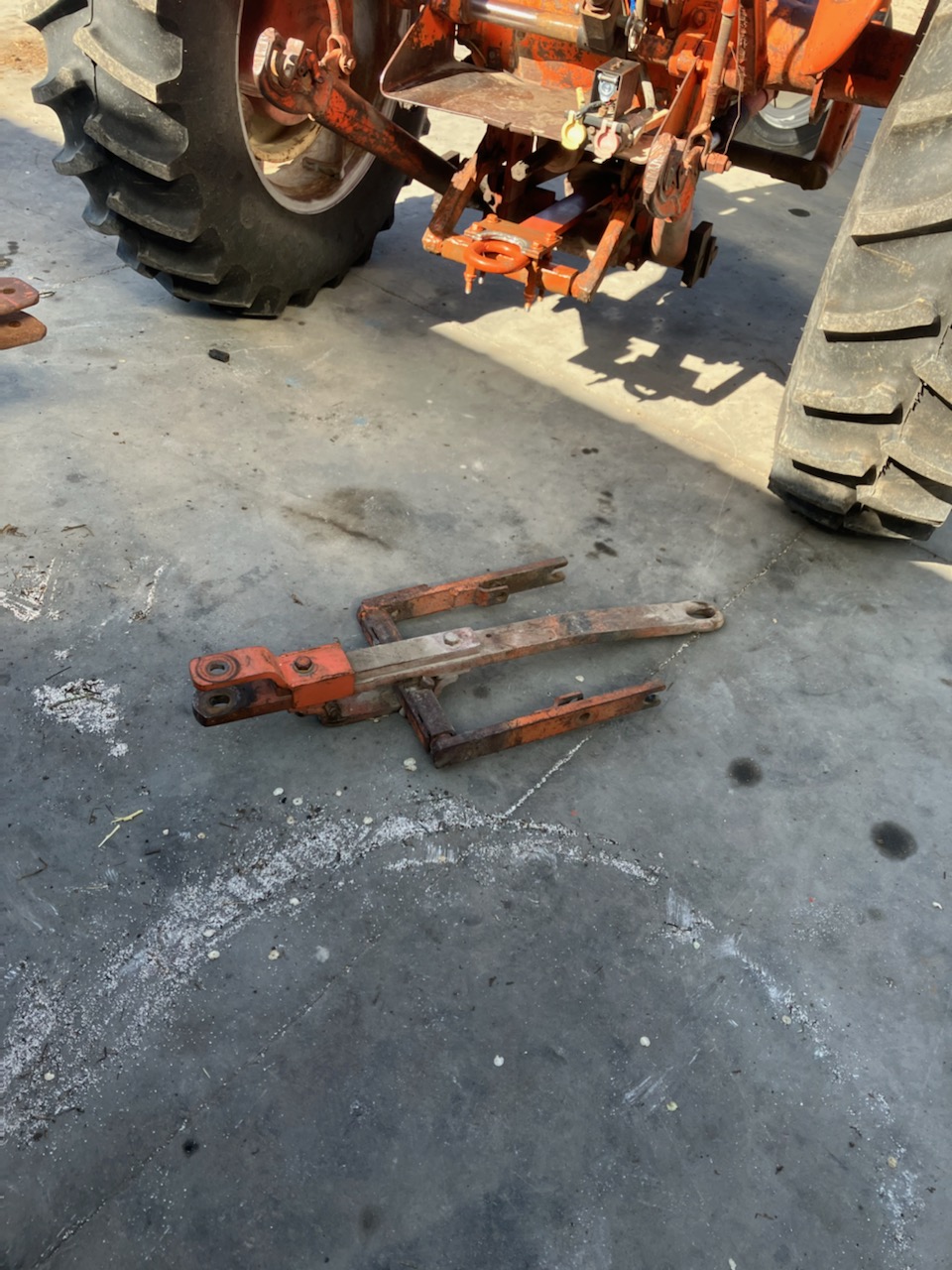

this is the hitch drawbar i bilt for the wd this spring the plaes hold it down or let  raise it just little  that picture is 18 and 18
