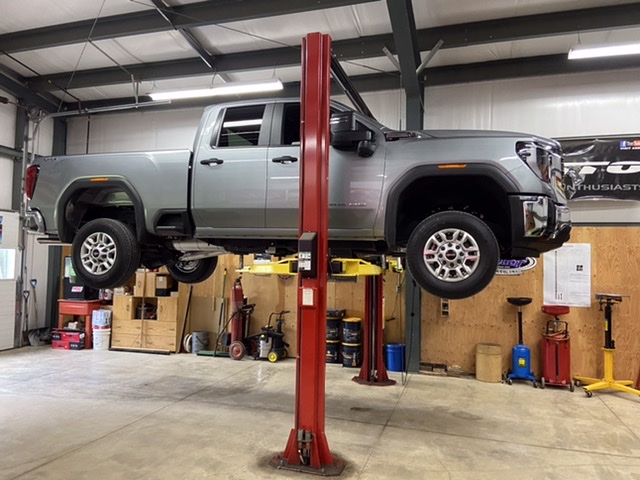

I do most of my work on a 2 post hoist. But the biggest I can accommodate is a 2500 truck. I find the 2 post better for most jobs but a little harder to set up on hoist. I use 4 poster mainly for storage in winter. Car on top and 1 underneath.

This is a 10,000 lb hoist. Lifts the truck well. If I were to get another 2-post I would get a 12k. Truck is just under 8,000 lbs. There are lots of 10k hoists available that are a bit beefier as well.
