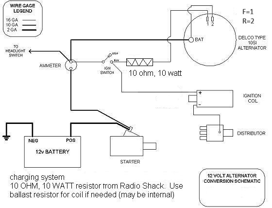

Post Options Post Options   Thanks (0) Thanks(0)   Quote steve(ill) Quote  Post ReplyReply Direct Link To This Post Posted: 22 Jun 2026 at 1:42pm
the 3 wire 10SI needs an excitation wire to turn it "ON"... Easy way to get that is a small drop in voltage on that wire compared to the rest of the system.. As Paul said, some use a small light bulb... some use a diode... i use a small resistor... They sell them on ebay or Amazon for a couple bucks...

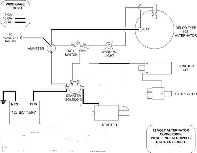

Points: 93399
Post Options Post Options   Thanks (0) Thanks(0)   Quote steve(ill) Quote  Post ReplyReply Direct Link To This Post Posted: 22 Jun 2026 at 1:48pm
the above is for a PUSH ROD starter... If you have a solenoid and key switch/ button... it looks more like this....

Post Options Post Options   Thanks (0) Thanks(0)   Quote MB 121 Quote  Post ReplyReply Direct Link To This Post Posted: 22 Jun 2026 at 7:19pm
Thanks for wiring schematic much appreciated mine would be pushrod key.
