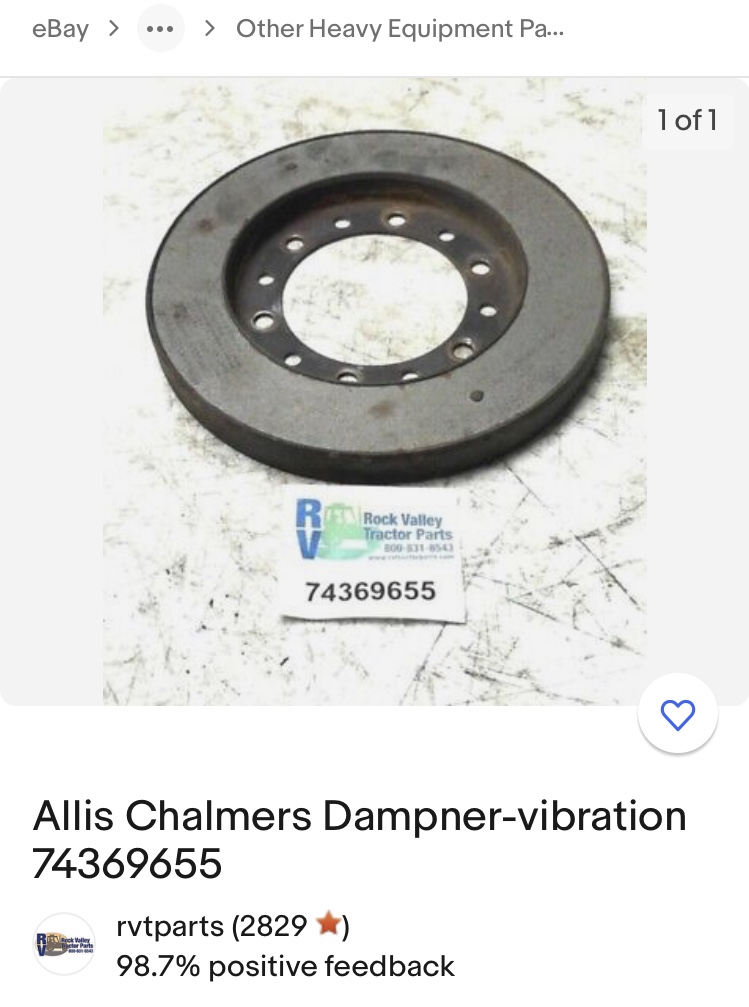

Does anyone know where I can get one new

AGCO doesn't have them ?? isn't there a brand name stamped on your old one ??

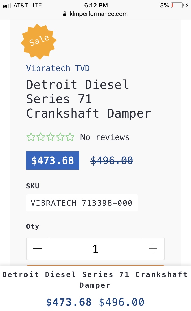

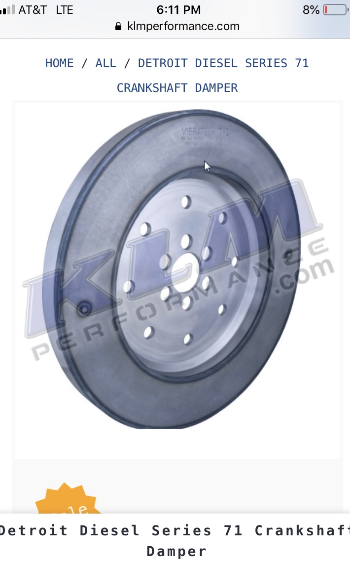

Could one of these dampener be what you’re looking for?
https://klmperformance.com/products/detroit-diesel-series-71-crankshaft-damper
Or?

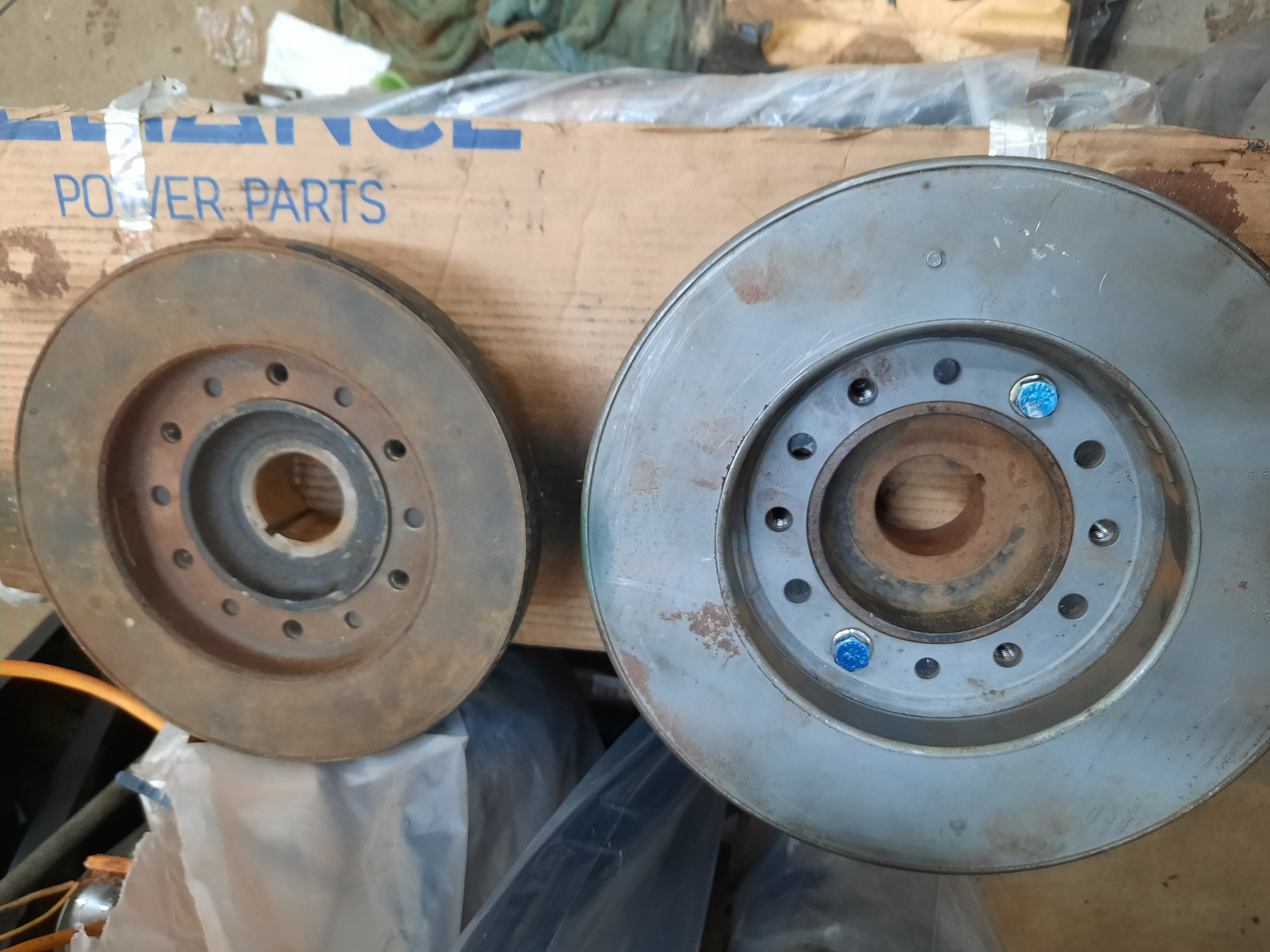

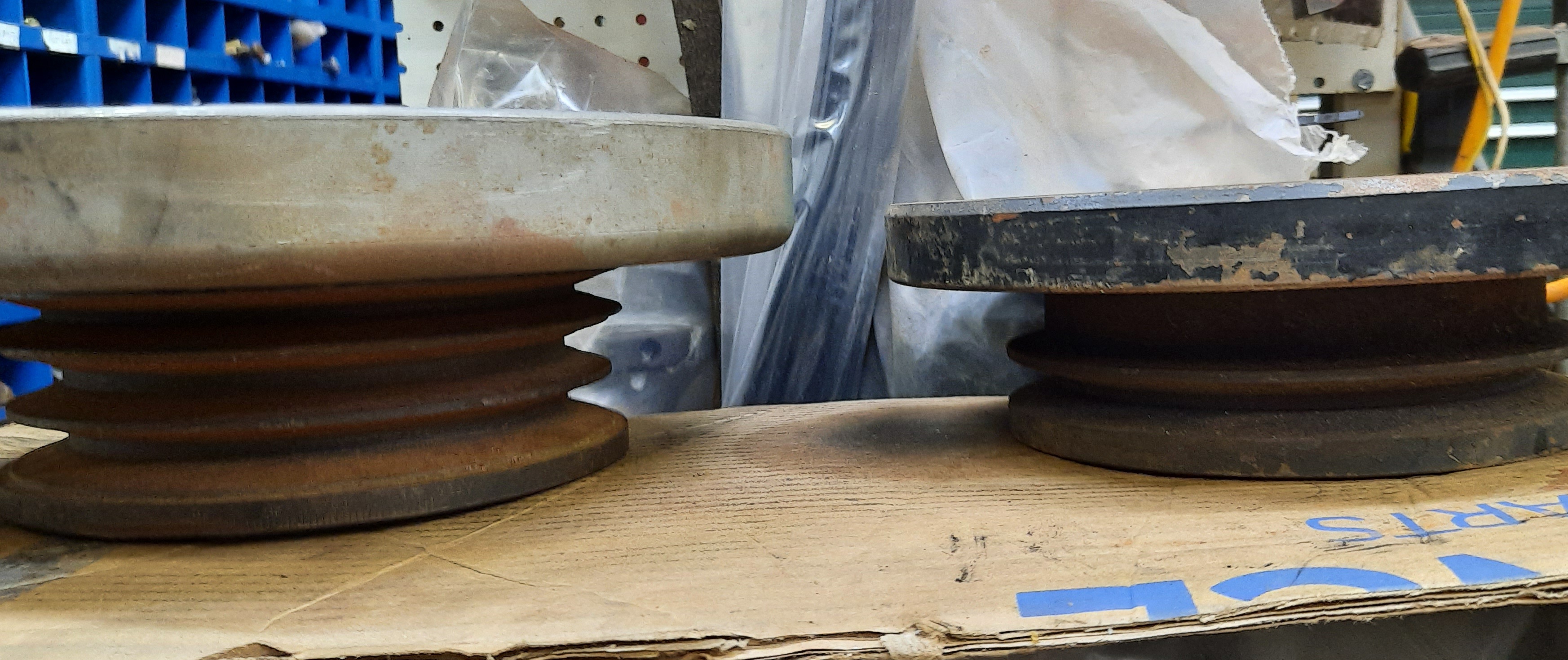

This is a new one from Allis. There is one that goes on a 71 series detroit that appears to be the same as the ones on the allis engines. When I get the old one off Im going to find one from the detriots and find out. Ive got another 8070 that needs the engine built so ill neef another one

Dang! That does look exactly like the 71 series detroit one I'm watching on ebay. I'm betting they are the same.

I think you are right Ed

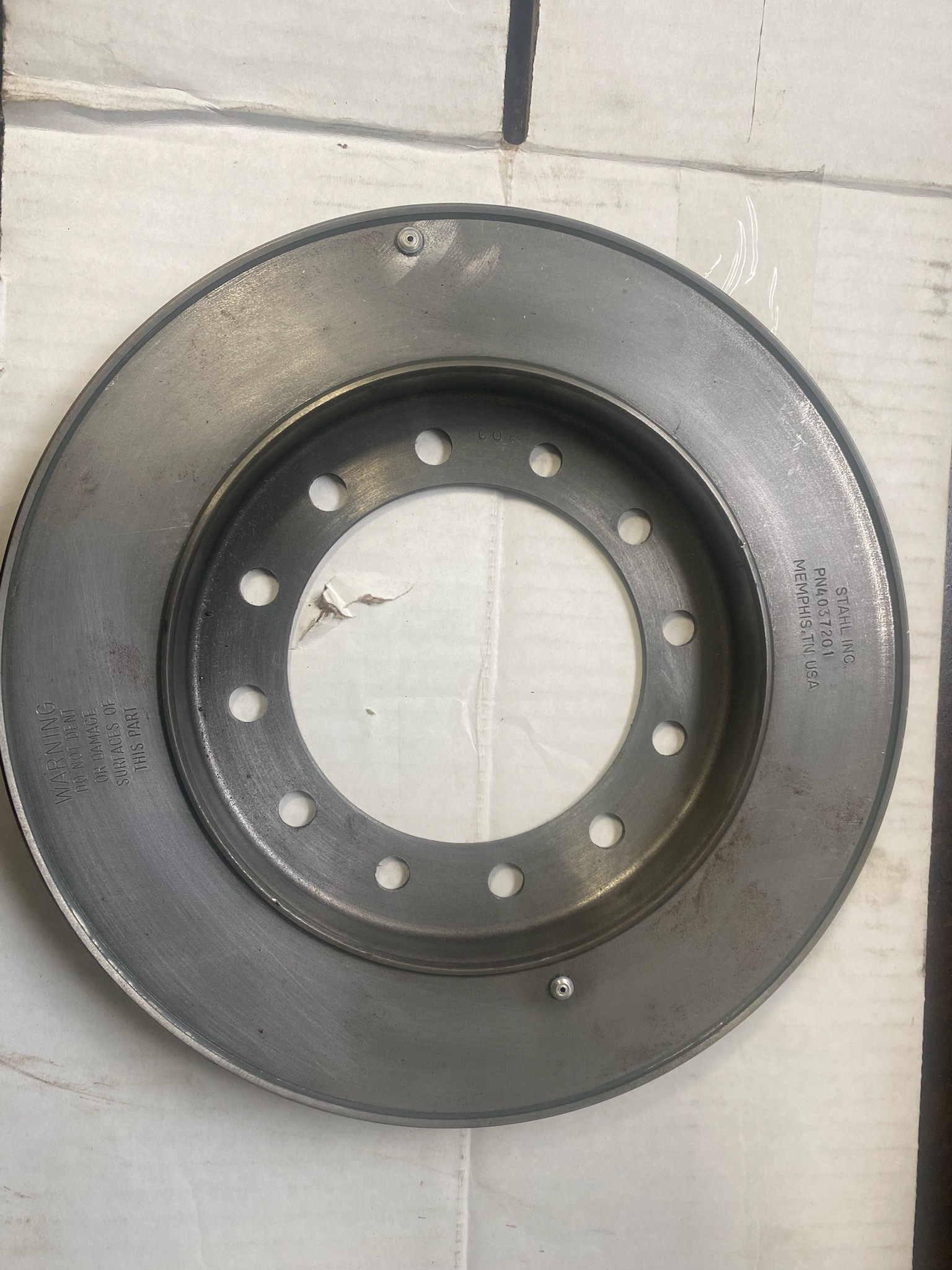

This is the one I plan to use on our 8050 that will be getting a counterbalanced crank. It's a 6-71 detroit balancer. Bolts right up. 12 3/8" in diameter. Based on my measurements, it "should" clear everything.

Peterson,I can't read it all but see the word Houdaille. The one on my 83 has the same little balance weights welded in bore.
