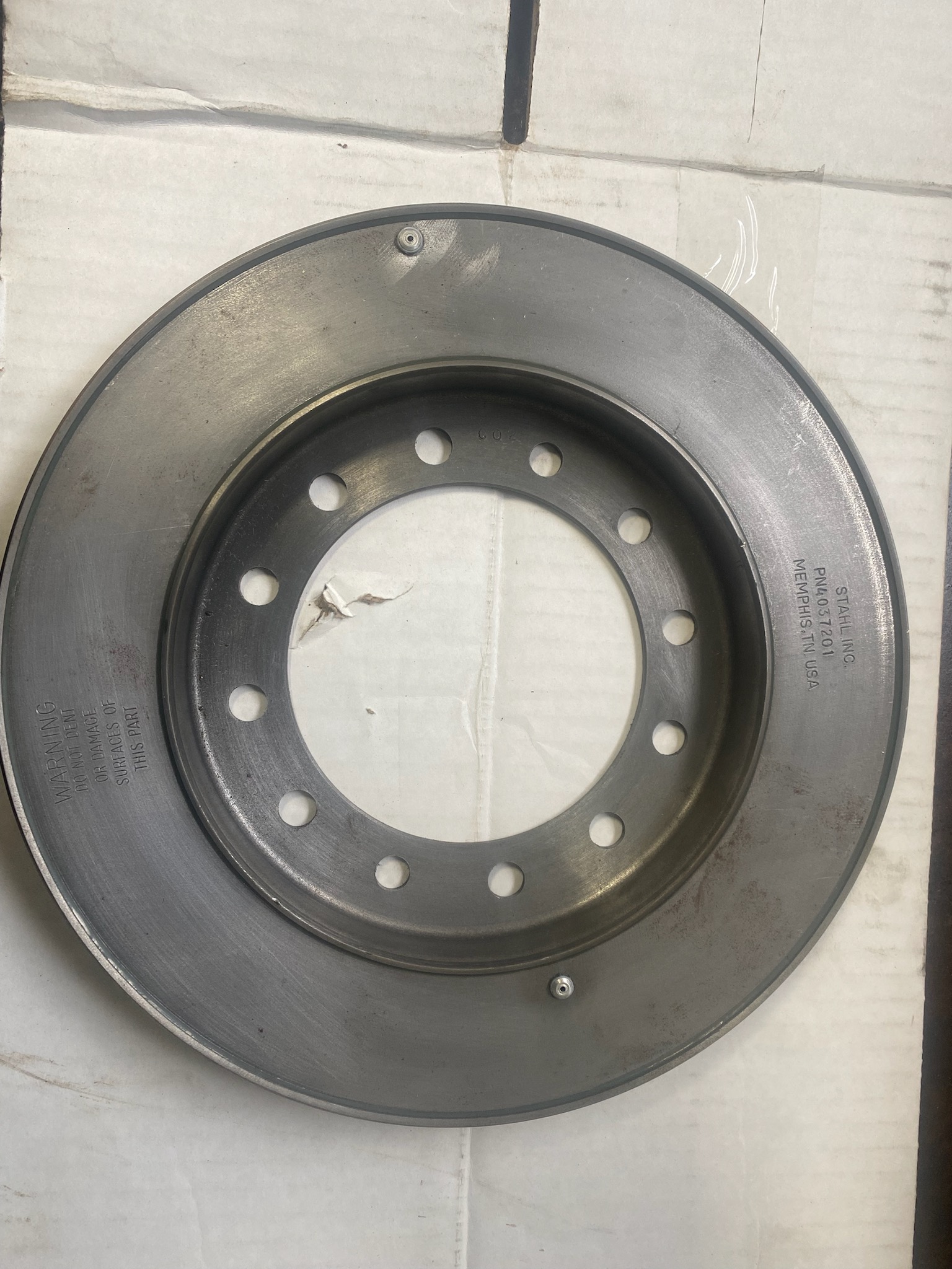

Does anyone know where I can get one new
1984 80780
1957 D14
DES 300 with 25000 engine
616 tractor

AGCO doesn't have them ?? isn't there a brand name stamped on your old one ??

Doc is right there is manufactures name/part number stamped on them. I also think either a Detroit 4-71 or 6-71 used the same fluid dampener. Good Luck

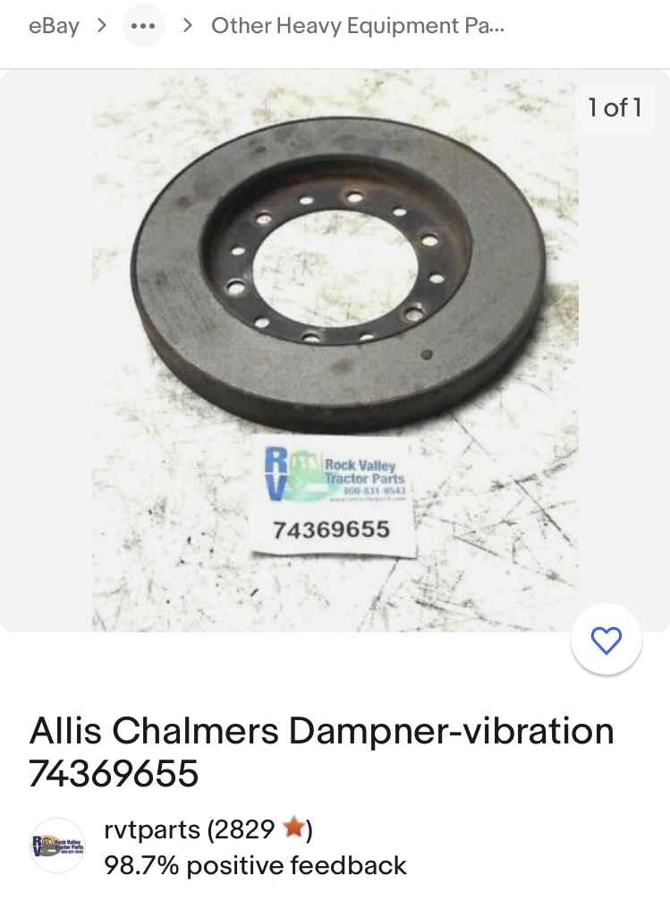

Reliance is showing the part on their website and Jen sales (which just resells Reliance parts?).
just under $1200...

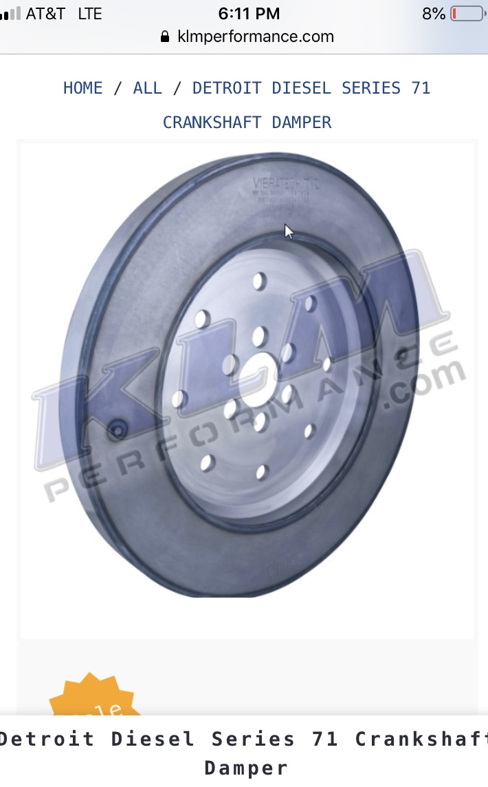

Could one of these dampener be what you’re looking for?
https://klmperformance.com/products/detroit-diesel-series-71-crankshaft-damper" rel="nofollow - https://klmperformance.com/products/detroit-diesel-series-71-crankshaft-damper
Or?

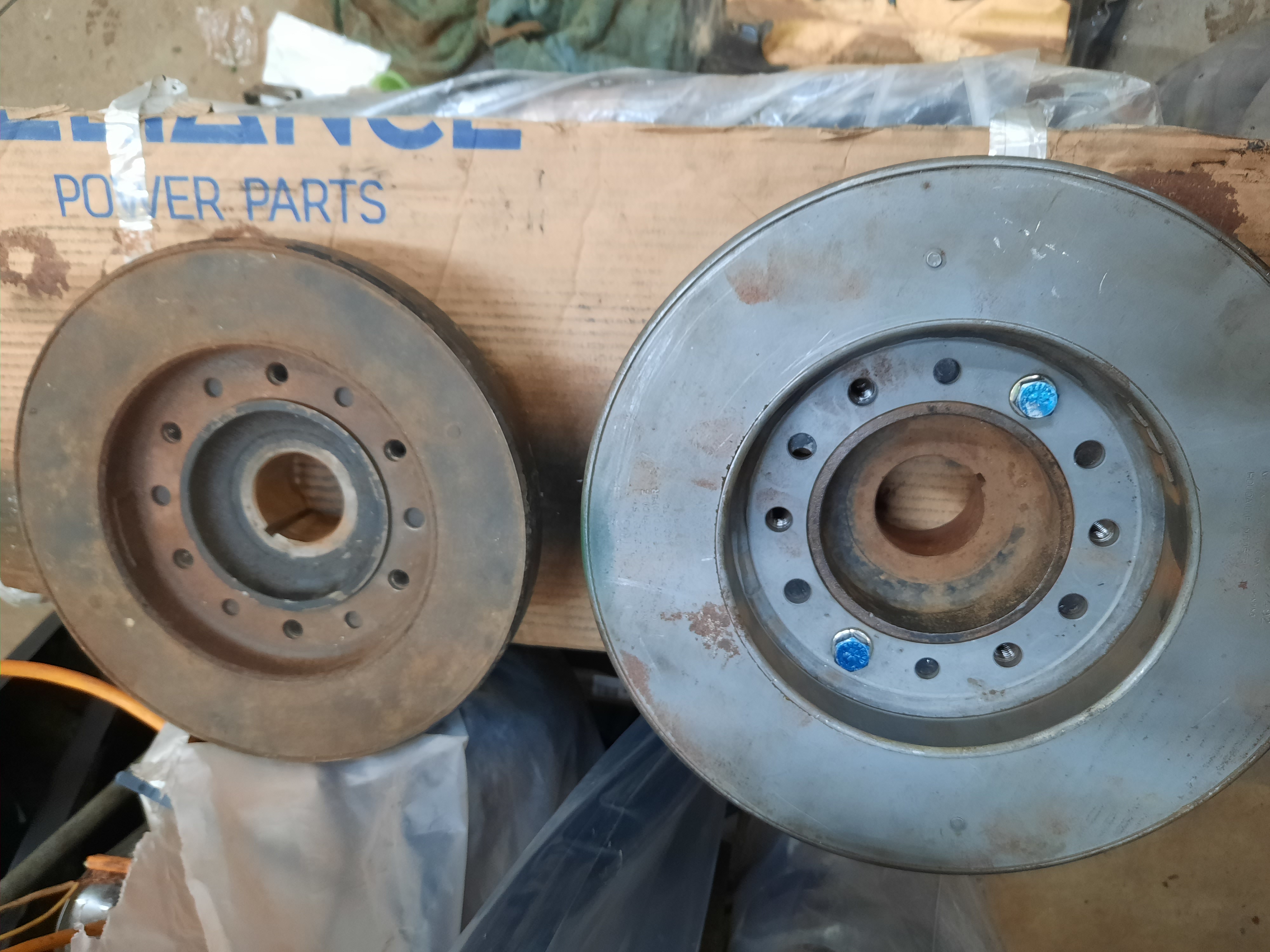

This is a new one from Allis. There is one that goes on a 71 series detroit that appears to be the same as the ones on the allis engines. When I get the old one off Im going to find one from the detriots and find out. Ive got another 8070 that needs the engine built so ill neef another one
1984 80780
1957 D14
616 tractor
Posted By: injpumpEd
Date Posted: 30 Jan 2023 at 5:09pm
Dang! That does look exactly like the 71 series detroit one I'm watching on ebay. I'm betting they are the same.
Posted By: 8070nc
Date Posted: 30 Jan 2023 at 5:17pm
I think you are right Ed

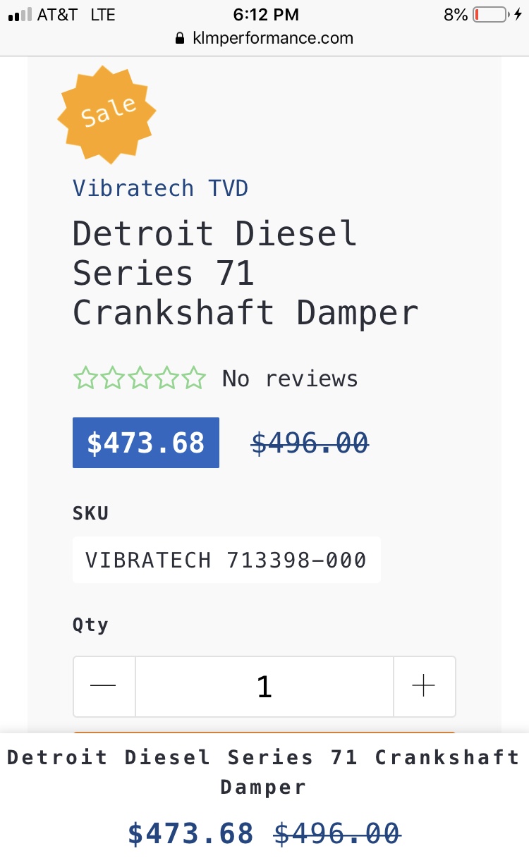

If you can buy a 4-71 DDA version for $500 (appears to be the same) VS OEM for $1500  (got it discounted to $1400 2yrs ago) it would be money well spent especially around 5000 hrs.

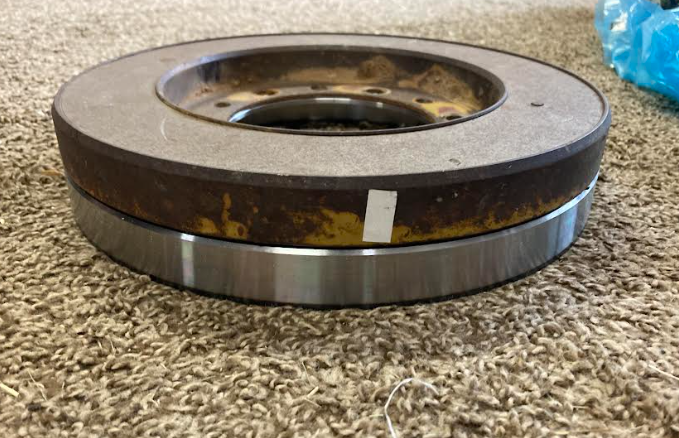

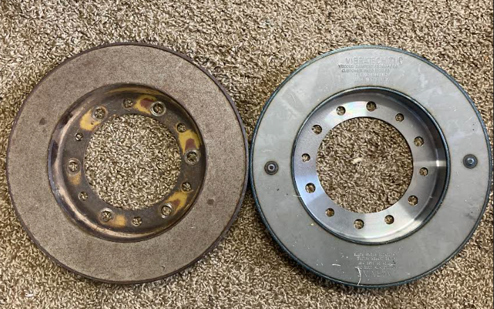

According to Vibratech data the 4-71 damper is 10.8 Dia and weighs 14 lbs. I tape measured old Stahl at 10 7/8 Dia and it weighs 12.5 lbs. Close enough? If bolt pattern matches. Peterson has a 6-71 damper bolted on which is bigger but I'm betting the bolt pattern for the 71's are the same. A phone call could confirm bolt circle diameter. I think the Detroits were thicker rings thus the weight difference.
Posted By: orangereborn
Date Posted: 06 Feb 2023 at 6:51am
  https://www.vibratechtvd.com/detroit-diesel-replacement-dampers" rel="nofollow - https://www.vibratechtvd.com/detroit-diesel-replacement-dampers ...
I also know an individual involved in that arena at an international level and am picking his brain.  He said that Mack's logic  "Use the biggest one you can find they will fit bolt pattern. Can't get one too big."  is generally a desirable consideration but unfortunately too often the damper is designed around the engine and not the reverse...So many are product specific unless one gets lucky...Good topic and I hope it gets moved to the knowledge section....Dale

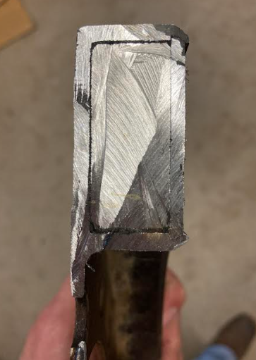

Did Allis use Viscous dampers later in life of company? What I am noting is those have a defined hours lifespan where the Viscous Gel hardens and the dampers become functionally useless. Cat Cummins and Detroit has service literature as to replacing these at specific engine life intervals.
I replaced the one on my Cat truck engine and cut the old one open, was as depicted with the gel almost to gorilla snot glue consistency not gelatinous.

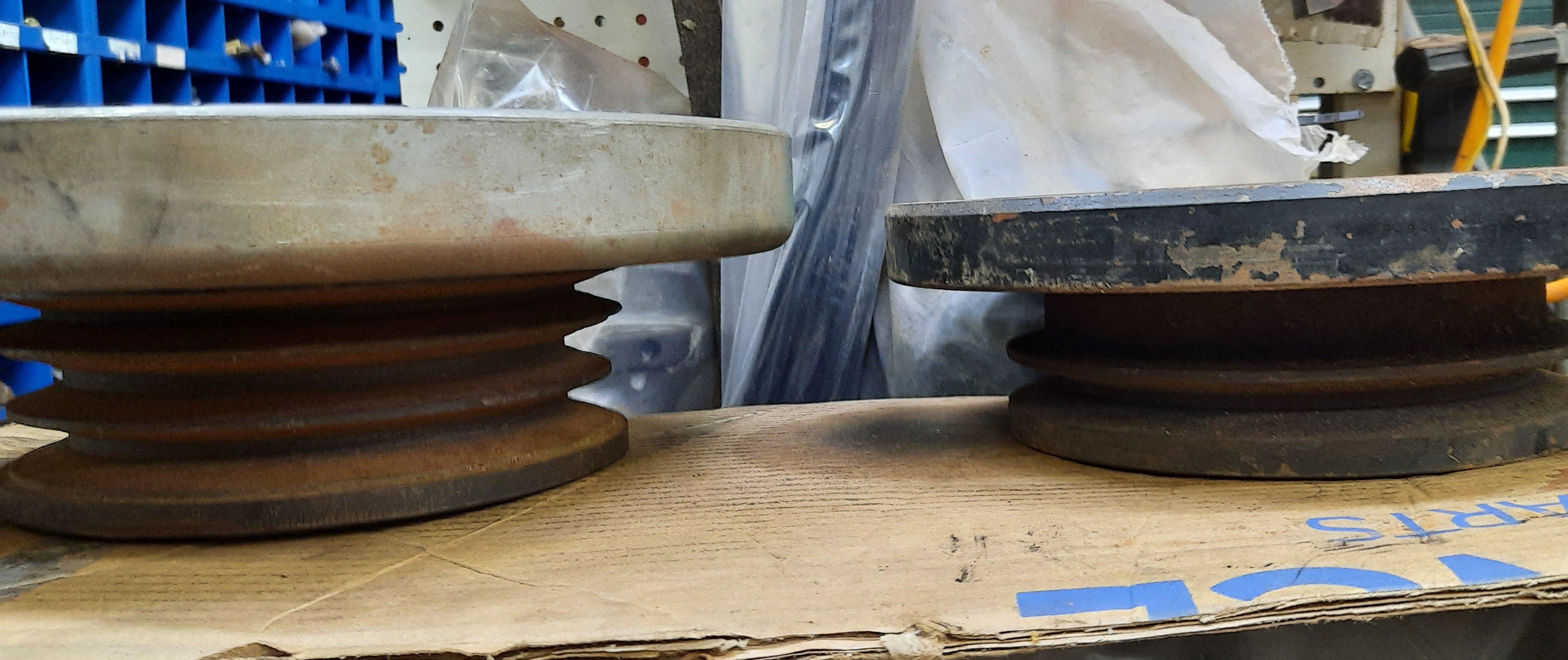

Can a rubber 7060 damper be used on the 7080 motors if motor is only going to see 2300-2400rpm and
If there is nothing else available?
Posted By: DrAllis
Date Posted: 07 Feb 2023 at 9:13am
Could be. Diameter of the pulleys the same??  Higher HP and higher RPM's is why they had to get away from rubber type.

Just a reference.  When I replaced my CAT Damper there was no core so cut the old one open.
This is result.  Gel almost all glue like, nothing to flow, to move the internal ring Had to use a Pry Bar and Hammer in the Cut Groove.

Posted By: CrestonM
Date Posted: 13 Sep 2023 at 9:03pm
I decided to give it a try, so I purchased a Vibratech dampener for a Detroit 71 series. As far as I can tell, it's a perfect match. Attached are a couple photos of the old and new, plus one photo of the old one cut open in case anyone was wondering how much space there is between the inner ring and the outside. Not much room for fluid, but then again, this isn't exactly fluid any longer.
Posted By: DrAllis
Date Posted: 14 Sep 2023 at 6:06am
Now, you can see why we've always been told to handle with care !! There cannot be any dents or physical damage of any kind to the outer shell or the damper is junk because the donut cannot float inside the silicone filled shell.

Posted By: CrestonM
Date Posted: 14 Sep 2023 at 1:02pm
Here is the link to the website I ordered it from:
Posted By: CrestonM
Date Posted: 14 Sep 2023 at 8:31pm
Got it painted yesterday, and installed tonight. What a difference! Before I could run at 1/2 throttle or above and the top of the exhaust stack would vibrate what seemed like 1/8” side to side from center, although that’s just a guess and it may not have been that exact. After installing this new dampener, I ran it all the way to full throttle and I couldn’t tell any movement in the exhaust pipe now. I’ll note that I don’t have any other warning signs of a bad dampener like broken alternator or A/C compressor brackets. I just did this as a preventive measure given that I’m sure the old one was original with the yellow primer and maroon paint on it, and I’m glad I did it.

If the one you cut apart didn't have any gel like goo inside of it, it was BAD !!!
Posted By: CrestonM
Date Posted: 15 Sep 2023 at 2:53pm
You are correct, it did not have any gel-like fluid left. But I wouldn’t have known had I not cut it open, so it would’ve been rendered bad at that point, too, regardless. Just glad I did it. A lot cheaper than a broken crankshaft.
Also the actual part number for those who asked is Vibratech viscous damper 713398-000.
Posted By: DrAllis
Date Posted: 15 Sep 2023 at 3:12pm
The only two I've ever had to diagnose had an awful rattling noise in the timing gears at 2500 to 2550 RPM's.  How many $$$$ did the VibraTech one set you back ??

I started this threadbecause ive got a 8070 that I thought I i had rod knock in. Pulled the pan to checj the bearings. They looked new. After much talking to different people I figured out it must be the damper. Bought a new old stock damper and installed it. Its better but not right
Im going to get a new vibratech damper and put on it
