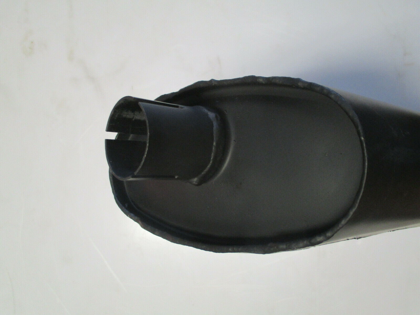

Post Options Post Options   Thanks (1) Thanks(1)   Quote Alex09(WI) Quote  Post ReplyReply Direct Link To This Post Posted: 05 Jun 2022 at 7:45pm
The OEM mufflers I have have the inlet pipe offset towards the centerline of the tractor about 3/4" of an inch.

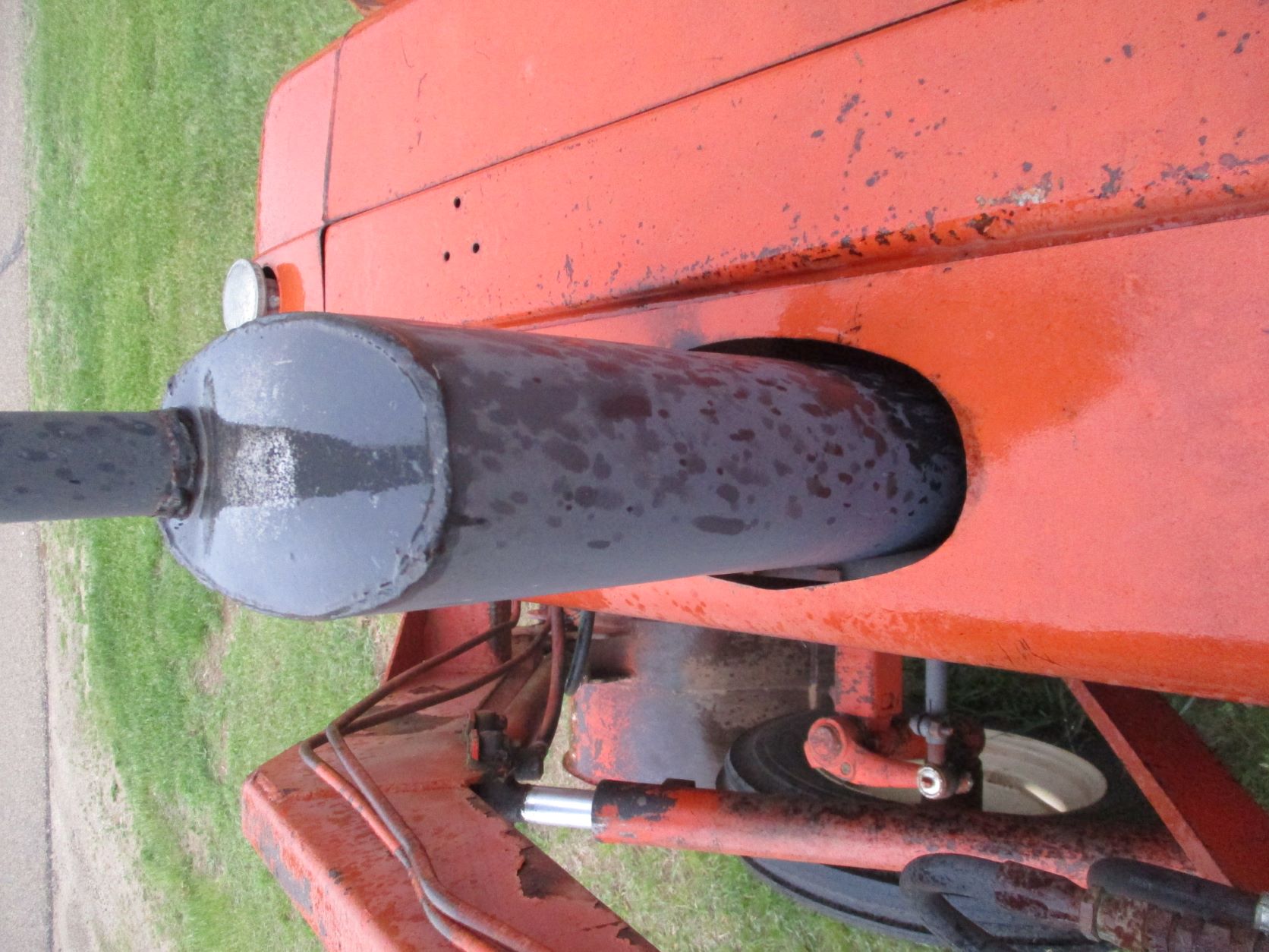

Post Options Post Options   Thanks (0) Thanks(0)   Quote Dean (West MI) Quote  Post ReplyReply Direct Link To This Post Posted: 05 Jun 2022 at 9:13pm
Thanks for the pictures Alex and thanks for calling me back and getting the Nelson ordered for me!
I had no idea the original mufflers were offset like that. It boggles my mind that Stanley produces a muffler that doesn't fit.
