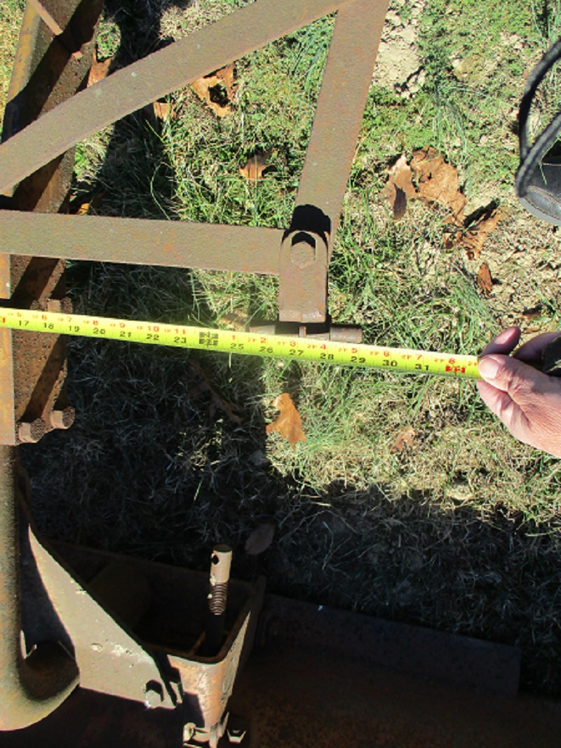

This is a picture of a blade that came with a CA.  The distance between the snap coupler hooks is 27 inches the same as the distance between the CA lift arms.  WD's and other tractors are about 31 inches between the tractor lift arms and I think the blades for those tractors would also be set at 31 inches.

Post Options Post Options   Thanks (0) Thanks(0)   Quote Hubnut Quote  Post ReplyReply Direct Link To This Post Posted: 09 Jan 2018 at 7:30pm
Larry, would that fit a B SC?

Post Options Post Options   Thanks (0) Thanks(0)   Quote Larry in NC Quote  Post ReplyReply Direct Link To This Post Posted: 09 Jan 2018 at 8:03pm
I don't have that blade any longer, but I think so.   As far as I know B CA D10 D12 implements would be the same.

Post Options Post Options   Thanks (0) Thanks(0)   Quote 1953CA Quote  Post ReplyReply Direct Link To This Post Posted: 10 Jan 2018 at 11:54am
Some snap coupler blades have two holes in the cross strap to go from CA to WD.

Post Options Post Options   Thanks (0) Thanks(0)   Quote tadams(OH) Quote  Post ReplyReply Direct Link To This Post Posted: 10 Jan 2018 at 12:51pm
You can drill the extra holes to narrow a WD45 blade.

Post Options Post Options   Thanks (0) Thanks(0)   Quote 1953CA Quote  Post ReplyReply Direct Link To This Post Posted: 10 Jan 2018 at 12:57pm
Just extra one hole is needed
