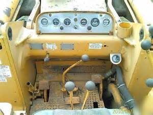

Michael, looks same as mine save I have the box air filter, throttle on the picture is center, kill is red knob to left, looks like no decal on that one.

dave thats one thst was for sale a while back one of the 7g my dad had was set up like that the shifter wasent the u shape it was like the one on a hd6 ep the last one we had had the decel peddle and the on the dash air filter ill look i did have the operators manual for that one
