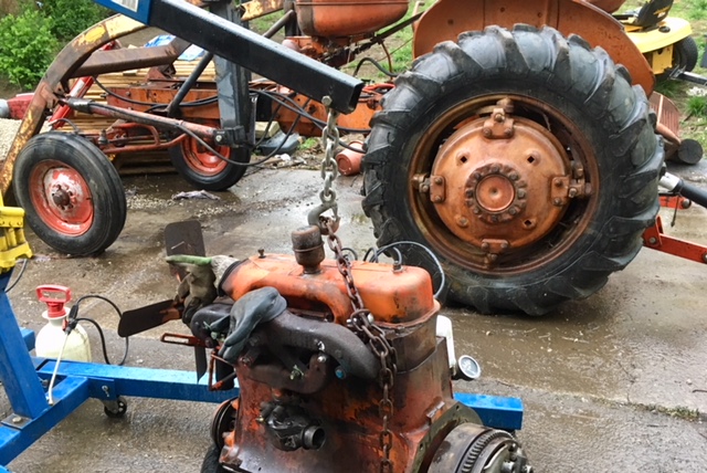

There’s some recents. I couldn’t get the older ones I have to resize. I ain’t put the sway block on because somebody welded on the piece where it goes    To thick. I need to find a used one   Piece that holds draw bar

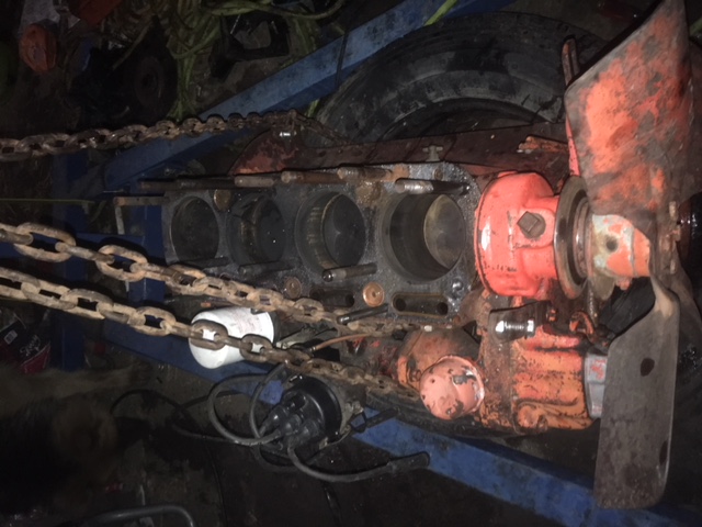

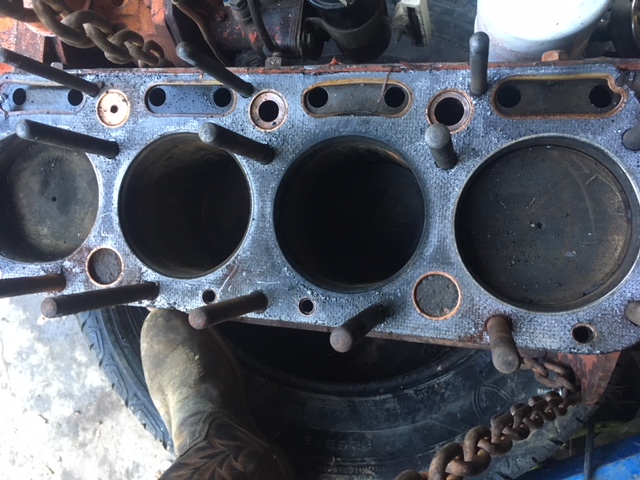

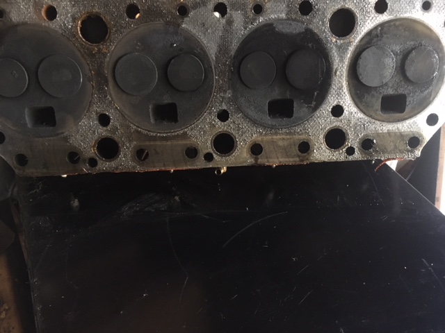

Taken the head in tomorrow   Im thinkin on honing the cylinders Saturday. I did notice that the rear piston has a domed in shape and the other 3 are flat

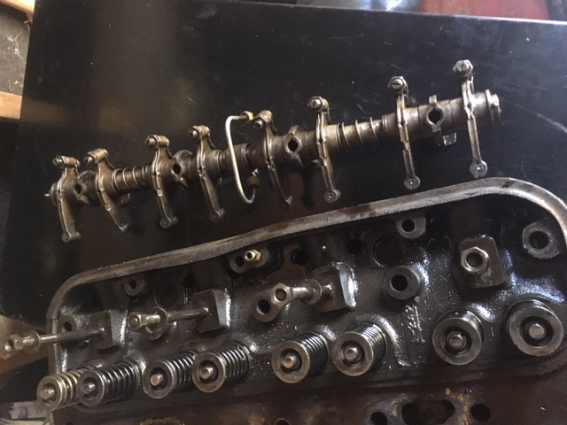

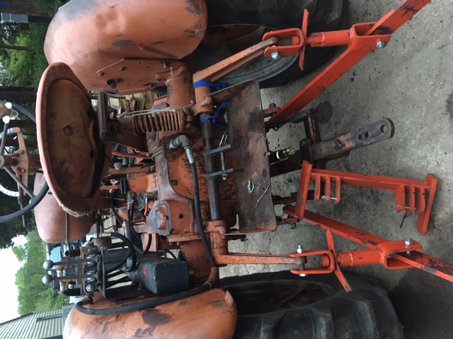

57,
Thanks for the pictures. They tell me some things that I will note. Others may have more.
The rocker arm assembly has the center oil tube that is typically on a WD. Also the rocker rod perches look to be WD style, Which probably means it has the short WD head. Maybe I missed it is this a WD or a WD45? engine? Have you measured the stroke? WD should be 4.00 inches and the WD45 should be 4.50 inches of piston movement.
That breather cap looks like a WD too. And the water casting coming out is WD.
If you have one dished piston and the others are not. To me that sounds like a problem? I have not heard of that, but on these old tractors any thing can happen.
Straight shifter also typical of WD.
Not sure if that is good or bad news? Still a very good tractor! Just if your getting work done they will need to get the right specs.
