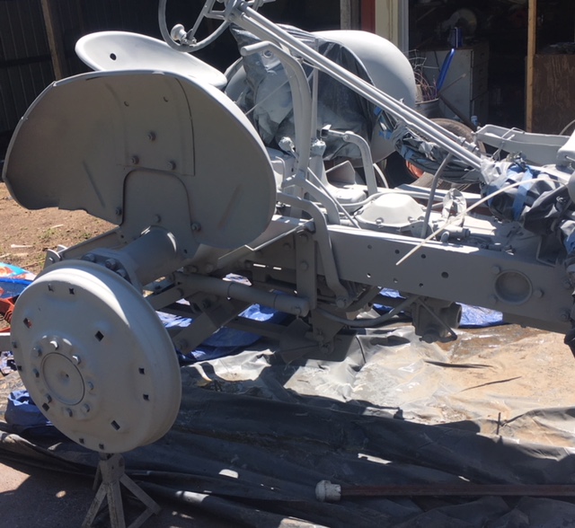

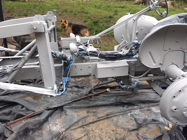

There’s some recents. I couldn’t get the older ones I have to resize. I ain’t put the sway block on because somebody welded on the piece where it goes    To thick. I need to find a used one   Piece that holds draw bar

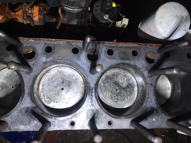

Taken the head in tomorrow   Im thinkin on honing the cylinders Saturday. I did notice that the rear piston has a domed in shape and the other 3 are flat

Thanks for the pictures. They tell me some things that I will note. Others may have more.
The rocker arm assembly has the center oil tube that is typically on a WD. Also the rocker rod perches look to be WD style, Which probably means it has the short WD head. Maybe I missed it is this a WD or a WD45? engine? Have you measured the stroke? WD should be 4.00 inches and the WD45 should be 4.50 inches of piston movement.
That breather cap looks like a WD too. And the water casting coming out is WD.
If you have one dished piston and the others are not. To me that sounds like a problem? I have not heard of that, but on these old tractors any thing can happen.
Straight shifter also typical of WD.
Not sure if that is good or bad news? Still a very good tractor! Just if your getting work done they will need to get the right specs.

WD71635 is a 1950 WD. If it still has the 4 inch stroke crank that it came with, that dished piston is gonna be lower on compression than the other 3. I'd be looking for flat top WD piston to match the others, if it were mine.

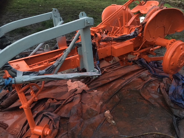

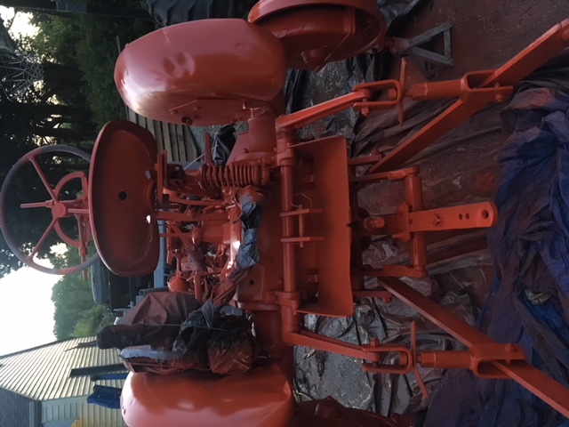

That's a great looking WD and someone did a lot of work on it to give it full hydraulics.  You did GOOD!!
Posted By: 57WD45FarmUse
Date Posted: 08 May 2019 at 10:03pm
Hello there and thank ya so much!
Yea I agggree there was a lot of fab work went into that! I’m workin on given it some much needed TLC. If weather cooperates I may get a first coat of fresh AC orange on there tomorrow !
1950 WD, Adjustable WF, 12v, PS, New style OK Tractor 3point hitch. Kelly front loader. Farm Use Only

Good job giving the WD some upgrades! So thats what they look like?:) I just have a pile of parts! PO#1 is going to make it look real good.

Hey there Chris
I’m pickin up the head tomorrow from machine shop. Everything checked out. Droppin a cuple hundred bucks for the valve job and gettin my new ring gear set on the flywheel. I’m hopin after work tomorrow I’ll get to lay down a coat of paint if weather cooperates. I gotta clean her off good first as the cats have ran there muddy paws all over my prime job!
Need to order an engine gasket set tomorrow. I reckon I’ll try Napa before I go lookin on the Internet. Hopefully they can get me one on Saturday and I can slap the head on and reassemble.
So yers all in parts huh. Did ya buy it that way or tear it down?

Date Posted: 13 May 2019 at 6:18pm
Ya got a reply PM.
Here’s couple pics after first coat

Yea hi there Chris
I’m did get them through Napa. I got the Headgasket kit and the oil pan set. They actually had them in Kansas City and got them in at my store in one days time. Noin what I no now ida got the complete engine set. So I’ll be lookin to piece some together for Certain
Next moves are comin togather. Machine shop is doin some Checkin on pistons ands what have ya from there supplier. He said the company got bought out by Some German outfit a while back and wasn’t quite sure if they still do Ag or not so I’ll hear from him tomorrow. Hopefully have a plan in motion by the end of This week and drop the block off wherver she’s going
Gotta get myself a good light and magnifyiin glass set up before I go tearin into that TSX773 and do the rebuild kit. Hopefully one night this week I’ll get time for that. Ima try to shoot a second coat tomorrow and then I’ll start to work on the Kelly loader. MyWDbeing down sure has put a hold on things round here but I’m sure havin fun with it !
