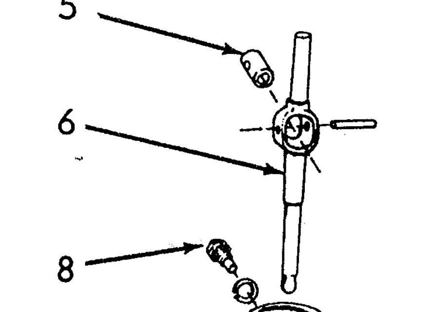

I’m needing the intermediate shifting shaft. If anyone has one for sale I would greatly appreciate it. Number 5 on the callout for parts diagram of the shift tower. Thank you in advance

I’m sorry all, it’s number 6 on the callout.
P/N: 098089
Or
P/N: 086705
It’s the whole lower shaft

Dont have the parts list handy - is that the part that fits into shift tower and has shift lever clamp to it ?
 The part that actually moves the shift rails in trany - ball type end and , pivot point center and round shaft through shift boot
Jgriffis03 View Drop Down
Joined: 18 Mar 2026
Location: Iowa
Points: 10
Post Options Post Options   Thanks (0) Thanks(0)   Quote Jgriffis03 Quote  Post ReplyReply Direct Link To This Post Posted: 8 hours 40 minutes ago at 2:52pm
Yes, its the lower shaft that actually sit inside the transmission and has a big oval hole through it which is where the bushing goes. I will see if i can add a picture

My PDF version of the HD5/6 transmission parts book shows that as being called the "LEVER, shift" and is P/N 7086705.
I put about 40 hours into rebuilding that part on my Son-in-laws HD5G, mostly by brazing and hand filing; I documented it on a thread several years ago. It would be quite a challenge to fabricate one from scratch.
The intermediate shaft is something else entirely.
