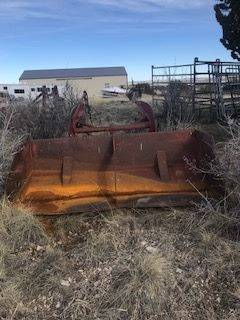

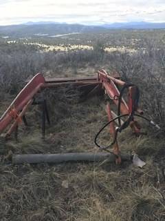

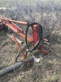

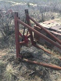

Found a loader on Craigslist.
All they can tell me is it was off an Allis Chalmers. No numbers.
Can you tell from the pictures if it will fit my D17 series 1?

Looks like a WD, but with a torch, grinder, and welder it could fit almost any thing.          MACK

It appears to have only boom cylinders and a lever trip bucket. It should work as-is on an old D-17 just fine.
