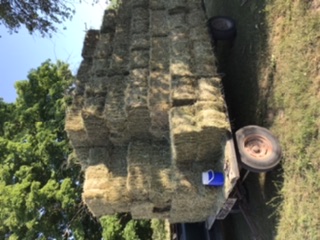

iPhone, I had to try! Rotation wrong, but it worked!
And a great pic at that. Reminds me of my younger days.

Reminds me of 3 weeks ago!
I got chewed out for making loads like that. The girls unloading didn't like getting the top bales down....lol

Boss man, I got to unload it myself, so... I don’t very often make them that big due to tires, ease of unloading, steady work flow for helpers, etc. But when we started, I said I want one more big load this year before we round bale the rest!

That is a pretty stack! I broke out in a sweat just looking at it! I always preferred loading rather than unloading, it was mighty hot in the hay mow and no breeze.
That is a pretty stack, tight, real even, etc
