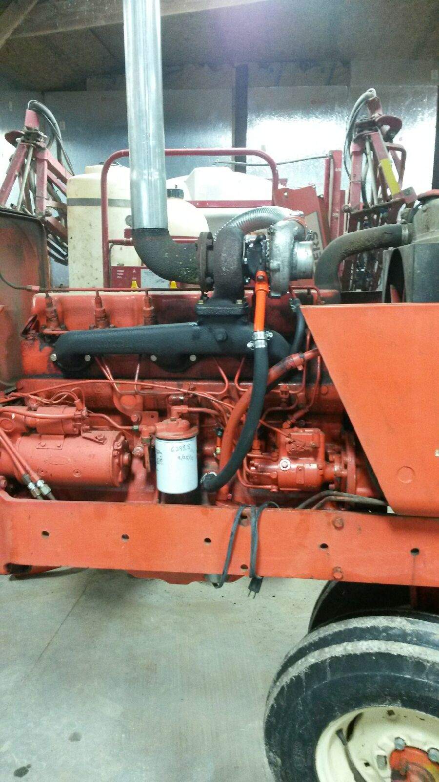

Has anyone TURBOED an AC 180?

When I purchased our 185 in 2003 it was equipped with a turbo. 2009 we installed a new Allis engine kit and the tractor tested out at 91 PTO hp on the 1000 shaft. This is our chore tractor and it runs a sucker blower, grain augers, moves wagons and grades the driveway.

Post Options Post Options   Thanks (0) Thanks(0)   Quote orangeman69 Quote  Post ReplyReply Direct Link To This Post Posted: 04 Mar 2017 at 12:39pm
This is a picture of the turbo we just installed on our 180, we flipped the turbo around and made our own oil lines and intake tube, in the picture the tube isn't installed yet but we have it installed now.
