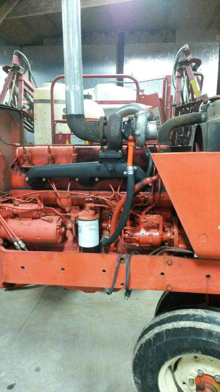

Posted By: orangeman69
Date Posted: 04 Mar 2017 at 12:39pm
This is a picture of the turbo we just installed on our 180, we flipped the turbo around and made our own oil lines and intake tube, in the picture the tube isn't installed yet but we have it installed now.
d17,d17nfpuller,d-17IVdiesel,d19gas,d19diesel nf,d21seriesII,180,190xtseries III,200,210,7020,7060,7080w/8.3cummins,8070fwa w/8.3cummins,8550 185 w/322 original hrs.
