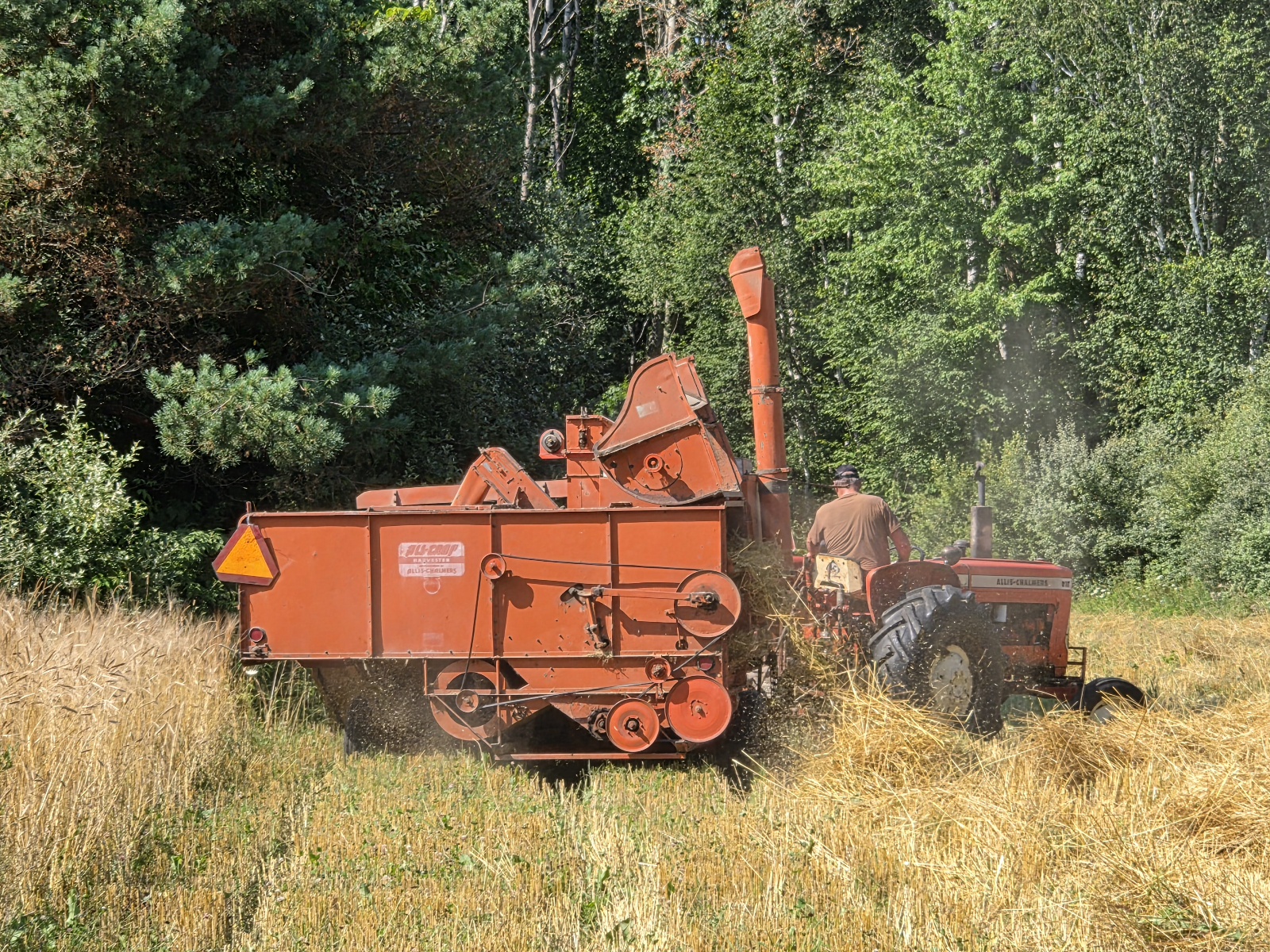

Whats even cooler? My Family all helped out with this Harvest project, from getting Grandpas 66 Big Bin out of the barn that hadn't ran in 8 years, to being there for harvest.
We all had a BLAST enjoying the afternoon, and even better yet, my mom with a last minute decision was able to get grandpa out for the afternoon to enjoy it.
He will be 92 years young on August 16th. He loved every minute and was "sure to tell us" all the tips on operating the all crop and the mechanics. We knew he would know!
One of the highlights of the summer for me.
Wanted to be sure to update you guys, I know some of you were interested in this project. Be looking for a video on this day hopefully by end of September!

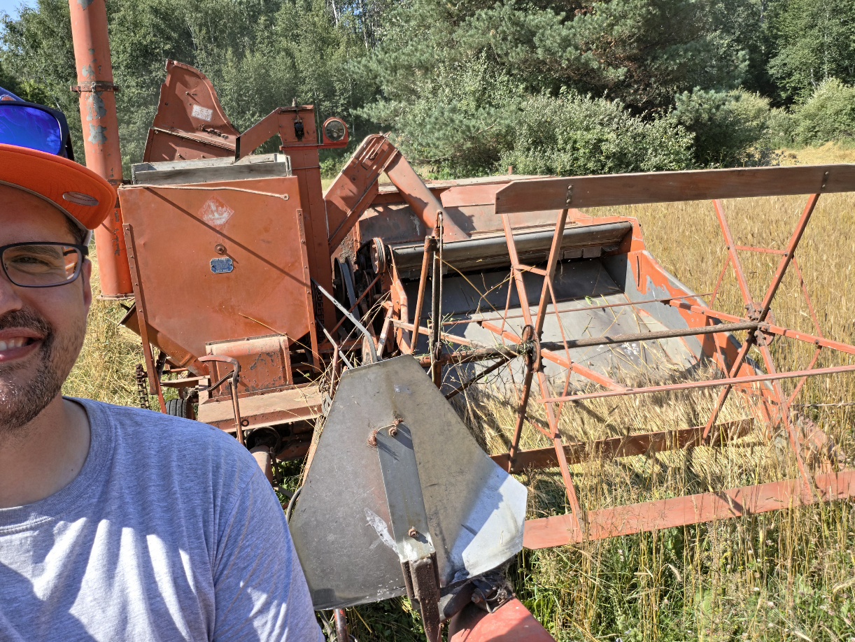

Your first post asked about swathing. It looks like the combine has a direct cut head.
Don(MI) View Drop Down
Points: 4014
Post Options Post Options   Thanks (0) Thanks(0)   Quote Don(MI) Quote  Post ReplyReply Direct Link To This Post Posted: 05 Aug 2026 at 12:18pm
Correct, at the time of original post, I didn't realize grandpa had removed the pick up attachment.

What screen (if any) did you end up using? I see some decent-sized stuff in the bin, so maybe had to run without one?

You know John, we ended up just going with the last screen Grandpa had in it, when he took Oats off about 8 years ago. Lol At the time we got the combine out 3 days ago, we didn't see any other screens. But grandad says he has more somewhere, but I haven't seen them. I think it did a decent job on the Einkorn, I'm just guessing by what was left in the straw, that we got 90% or so thrashed. I'm sure someone with more experience could have done better though. I'm just a rookie- but having fun!
