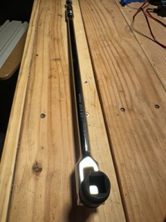

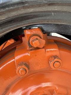

Re the clunk, before tearing down the final, double check the PA wheel clamps...Wink
After tightening up the final drive with repairs on the hand clutch, it was better, but there was still a clanking when on the road. Thus, as DiyDave mentioned, the "Eccentric Pins" that hold the rim tight keep coming loose.
The shop manual, "...each eccentric pin must be fully turned to the right to be tight." I was not getting them turned fully to the right, thus would keep coming loose quickly when used.
I finally was able get the job done with a 24' cheater bar and a 9/16" Female Plug Socket

Post Options Post Options   Thanks (0) Thanks(0)   Quote CA13414 Quote  Post ReplyReply Direct Link To This Post Posted: 17 hours 48 minutes ago at 4:45pm
This worked awesome to get all the eccentric pins rotated fully to the right. It was not difficult with the cheater and working each one as I rotated the wheel and put each on top.
No clunking on the highway!!! Thanks for all the advice and hints.
