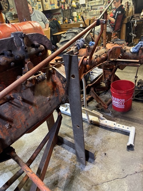

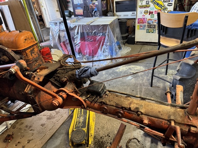

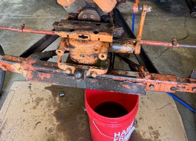

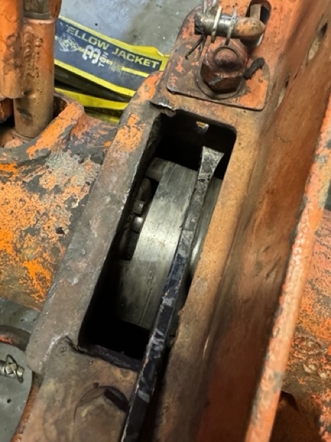

Stripped down a bit more..... almost as far as we go in that regard.
One of the major oil leaks is the hydraulic system.  It is coming from the upper side.  Not sure exactly what it will be but suspect an "O" ring is bad.
Here are a few of the last parts for sand blasting.
Was a bit of a pain, but removed the spindles out of the front end.  Next to remove the old spindle bushings and press the new ones in after cleaning them up.
Overall a very productive day.  I think we have found all but one oil leak.  This is on the left side and leaking between the differential and final drive housing.  I suspect it is the inner oil seal for the upper drive shaft which was leaking into the left housing. Here is the brake pad that was buried in dirt and leaves in the housing and soaked with oil.

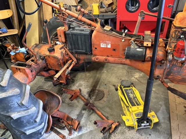

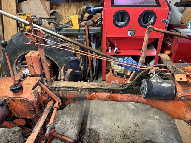

Post Options Post Options   Thanks (0) Thanks(0)   Quote CA13414 Quote  Post ReplyReply Direct Link To This Post Posted: 09 Apr 2024 at 8:10pm

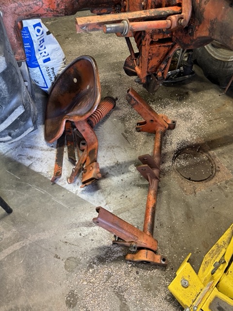

Removed the battery box, tool box and steering column/shaft.
Need to figure out how to tighten up the steering boxes to take out the extra play.

Post Options Post Options   Thanks (0) Thanks(0)   Quote CA13414 Quote  Post ReplyReply Direct Link To This Post Posted: 13 Apr 2024 at 5:41pm

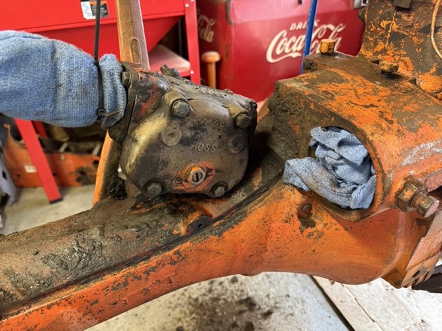

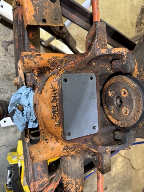

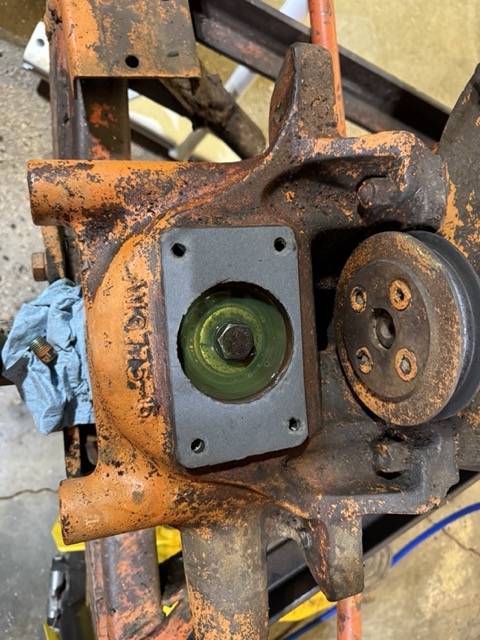

A few more pictures.
Radiator is off, now need to pressurize and find any leaking spots.  Hope to fix vs. buy a new one for ~$200. :'|
Wiring, generator and starter are now off.  We set aside the wiring as a template when reassembling.  I have new wire and connectors with heat resistant black wrap.

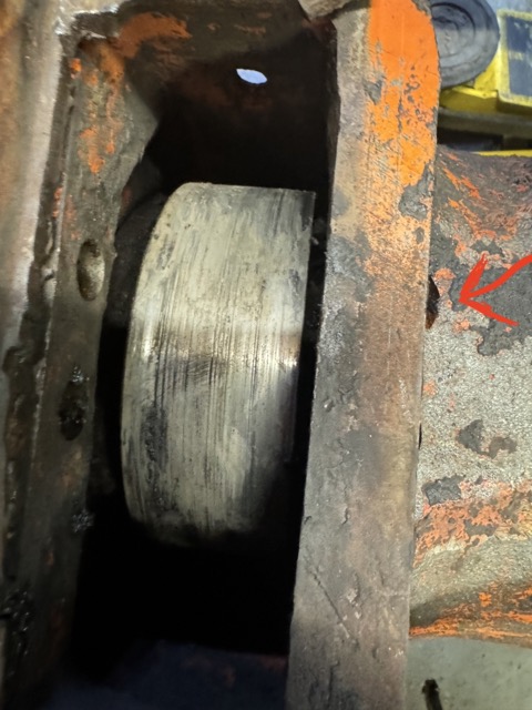

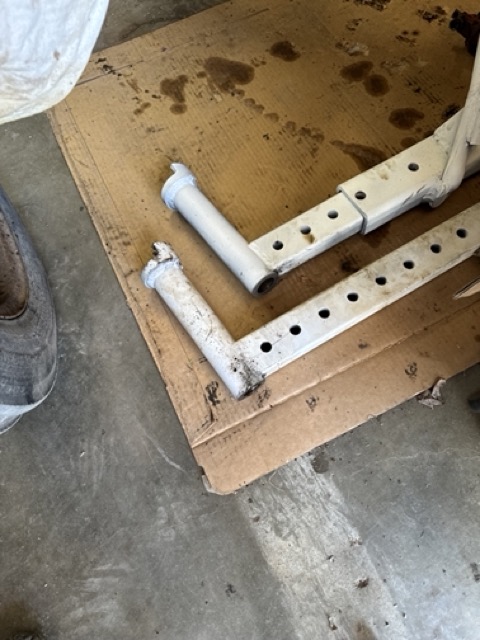

Was able to remove the front spindle bushings and clean up the spindles.  Do need to use a bit of emory cloth to finalize before assembly.
Did find out the mid steering box is adjustable. An 8th of a turn took out almost all of the slack.  Need to check/add oil grease.
This week we will pick up a new rear tire.  One is in good shape the other has many cracks.  Realized our center pivot tires on the farm are 11.2"X24" and plan to use one of those tires.  I did find many on FaceBook for $50 or more which would also work. Ironically, when I was looking at the other rear tires to see if I should replace it I realized it was also an old pivot irrigation tire!
Next steps: Continue clean up!!  Press in the new spindle bushings, reassemble the spindles, rebuild/repack the the front wheel hub bearings and with new seals reassemble.  Then swap out the front end.

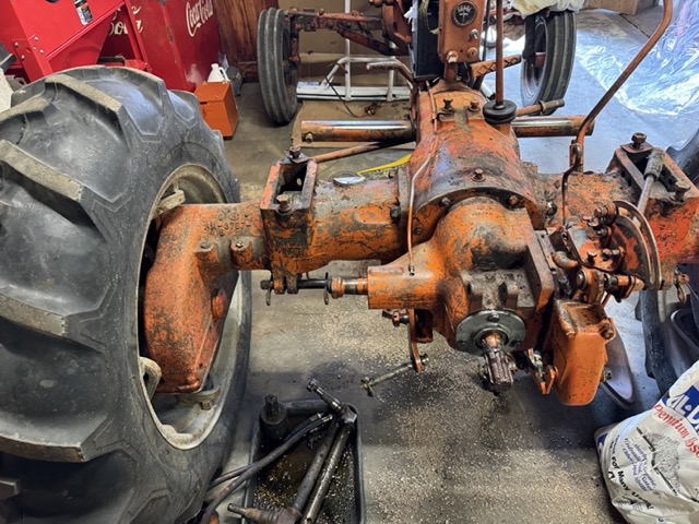

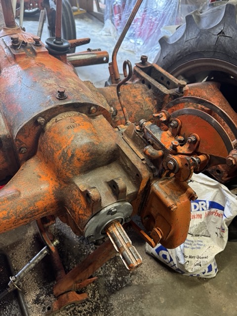

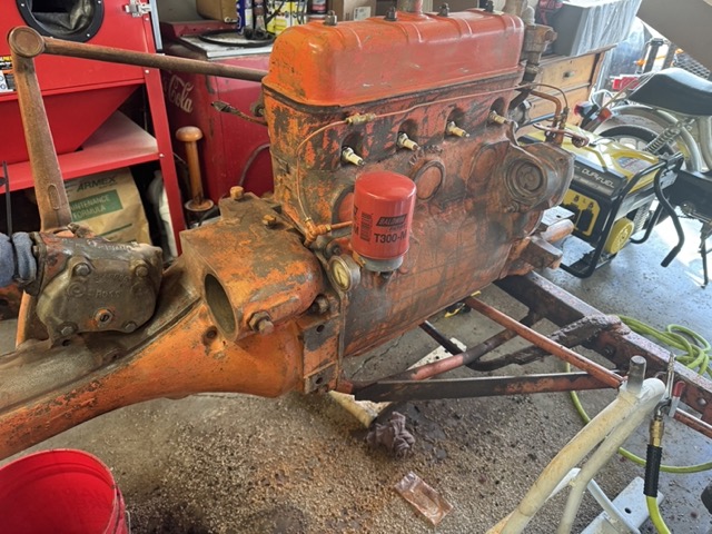

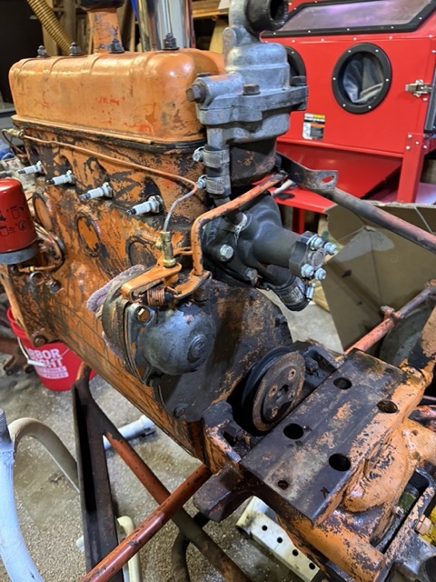

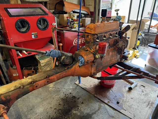

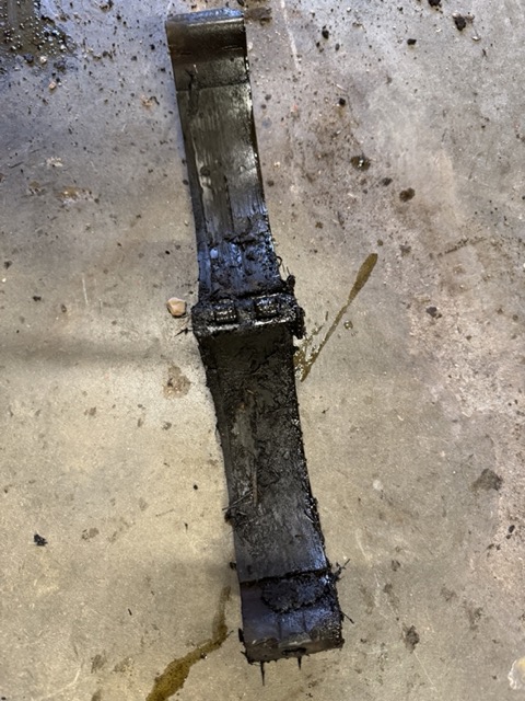

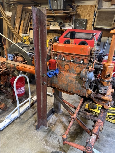

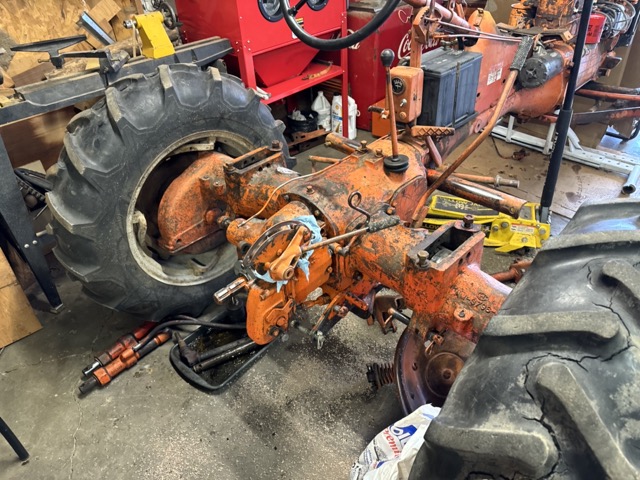

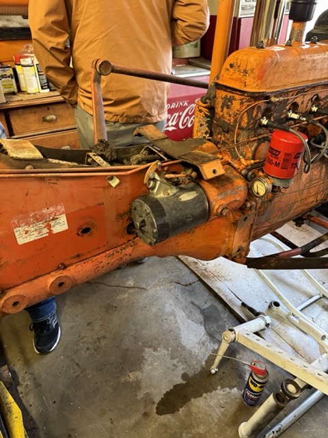

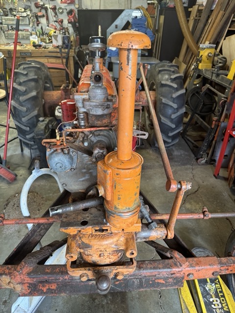

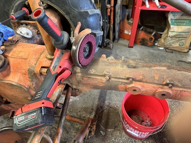

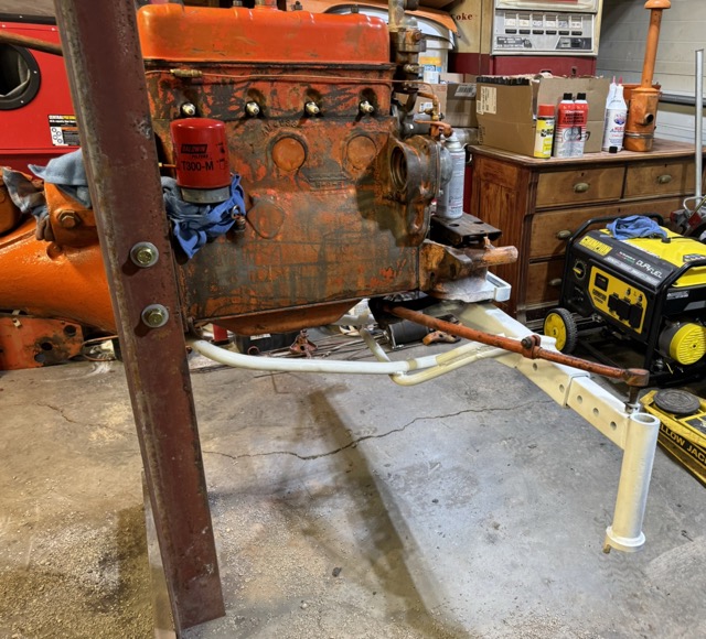

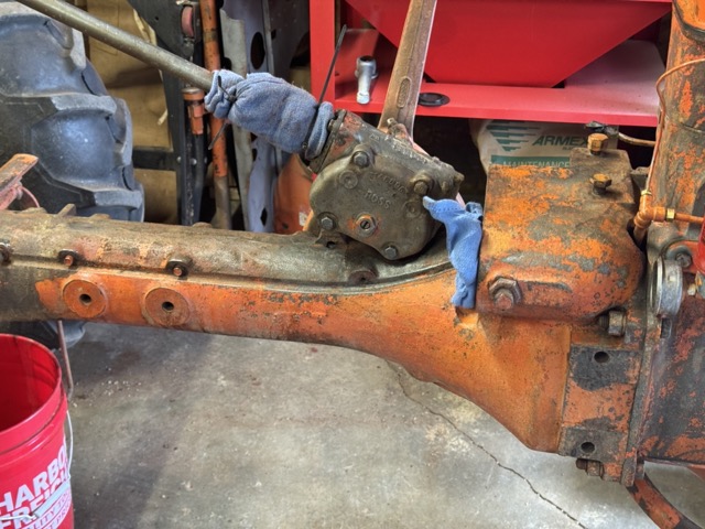

A bit slower progress this week.
Spent the day cleaning.  With a putty knife, screwdriver and wire brush, took all the "chunks" off the engine, torque tube and part of the transmission and differential.  Cleaned up the air filter and should be ready for a bit of sanding and then paint (planning black).  You just gotta love "Brake and Parts Cleaner" for removing the oil and grease as well!  Pretty much strips off everything which was awesome.   Here is air filter, ready for sanding and then paint.
The engine and torque tube!
Torque tube and steering box!
Transmission, differential and PTO/hydraulics!!
A bit backwards, but before all the above, we spent a few hours cleaning.  The results of the day were achieved by the right tools and as previously note...... brake and parts cleaner.
Notably the best kick ass tool of the day was..... a cordless Milwaukee Hand grinder.  This was awesome to clean up the rest. The Milwaukee drill with a SS wire bur was also a huge thumbs up!!!
Replaced the gasket on the oil filter mount... which was leaking.

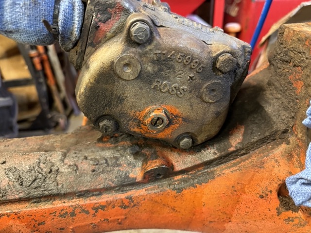

Also took off the radiator support to check out the front steering bearing cone and capscrew. There was oil present and no notable issues.  Decided to leave it as is and not dig deeper.  Thus, filled it with Lucas Hub Oil and made a new gasket with the ball ping hammer.  Will watch and make sure there is no oil leak (if so replace the oil seal).
Also filled the steering box with Lucas Hub Oil and will check for leaks.
Still need to  dig into the hydraulic system and find the suspected bad "O"-ring.  Then the inner final drive seal need to be replaced!!

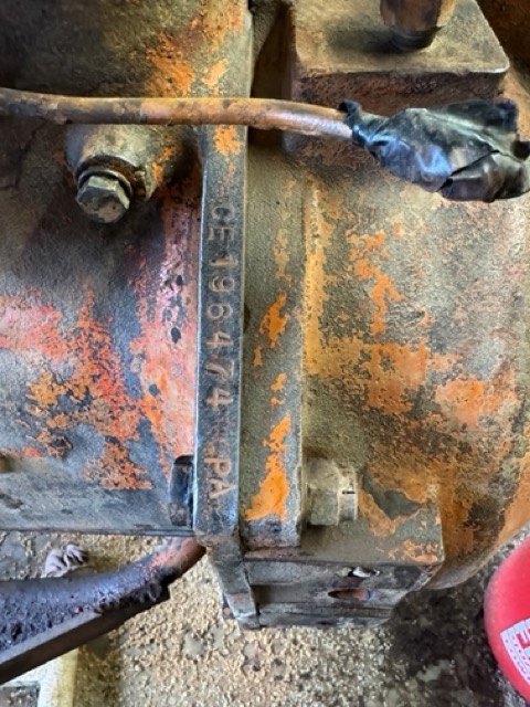

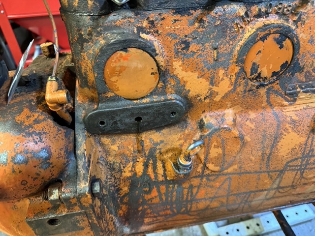

Also, any insight on this engine block number?  Found it when cleaning. Mostly currious!!
< id="idg-io-safe-browsing-enabled" ="" oninit="true">

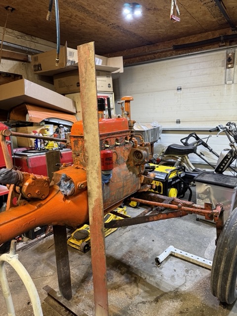

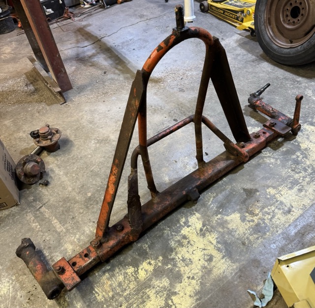

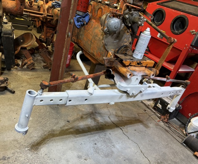

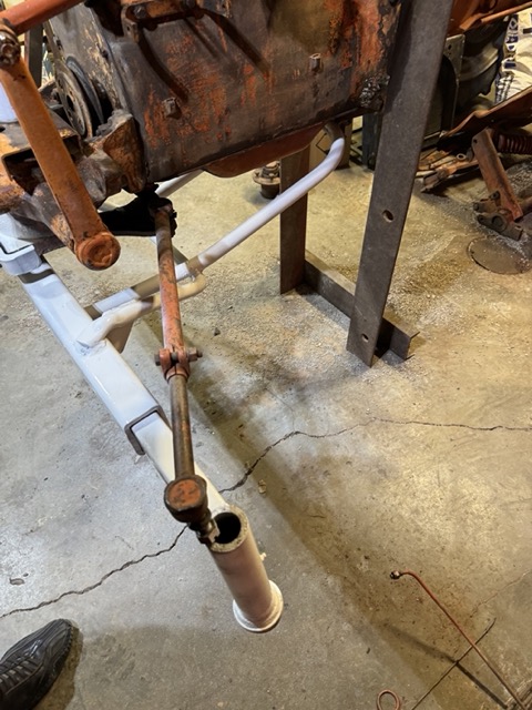

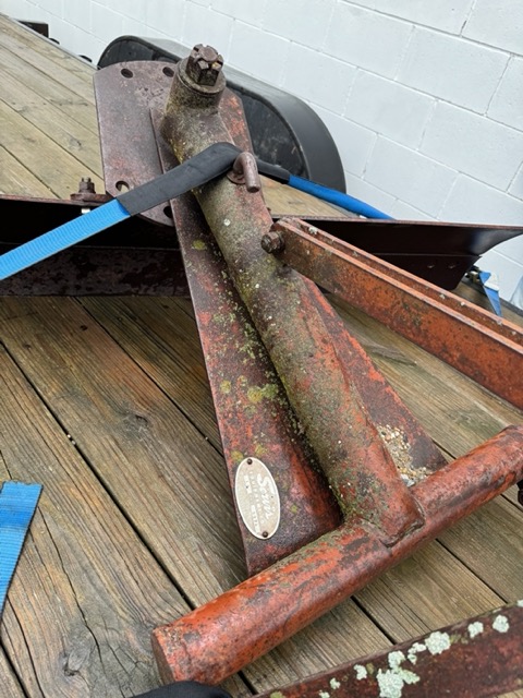

Ready to remove the front end and clean up everything under the front steering.
We pulled a couple of cold rolled angle iron from the iron pile to support the front end while we rebuild and change out the front axil.  Didn't take much with the drill press and pilot hole and a 11/16" bit.  Bought some 5/8" schedule 8 bolts and put it all together.  A piece of C-channel at the base wire welded, to fix the base, just because!!!

On the oil filter mount, take a straight edge and check the mount.  A lot of times they are 'warped' because of over tightening the two bolts, causing them to curve.  A little flat file on em works good.

Thanks Ted, I will check the filter mount with a straight edge.  It didn't look bent, but I was probably looking through my bifocals thus, who knows. :')

Next step in all of this was to find a solid 3-point 6'-blade for maintaining part of our property.  Just picked this up this morning after a purchase via MarketPlace.  Was a fun 90 mile road trip into greater Nebraska.
Was a pleasure visiting with the gentlemen selling the blade.  Cheers to their spectacular and beautiful country home.  Is a historical house that is amazingly maintained.

Today was able to spend a few hours.  We took off the old, bent and welded front end, and put on my GrandPa's/Dad's front end.
Here is the old unit (snagged the hubs and wheel bearings which look to be in condition).
Here is sand blasted and primed front end from my family CA.
Next will be to put on the spindles and hub after repacking.

IBWD MIke View Drop Down
Joined: 08 Apr 2012
Location: Newton Ia.
Points: 4452
Post Options Post Options   Thanks (0) Thanks(0)   Quote IBWD MIke Quote  Post ReplyReply Direct Link To This Post Posted: 03 May 2024 at 9:30am
Did you change the bushings in the knees? Perfect time to do that.
