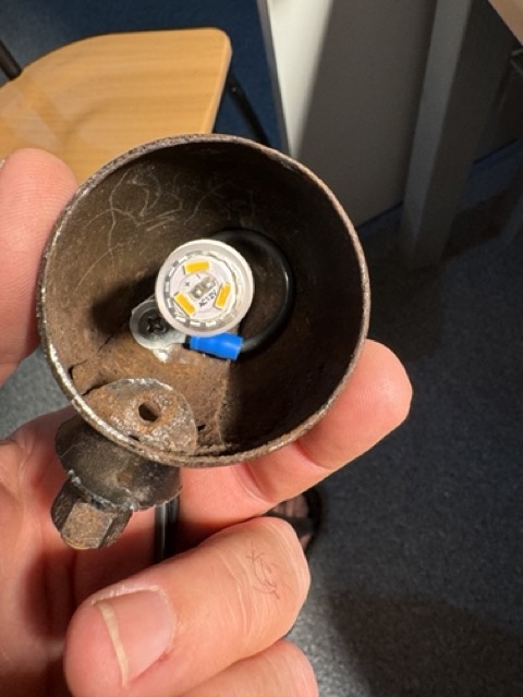

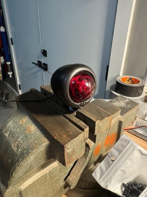

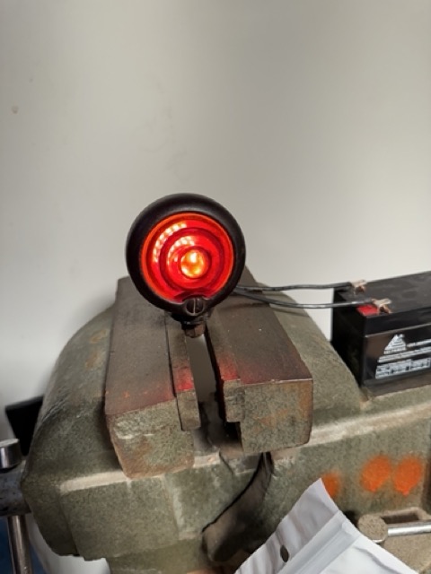

Finally put together the CA "Red Fender" light.
We had sandblasted it last summer and when I opened it up this past week, it was rusted out. Thus, I ordered a new "Bulb Socket" and BA15S 12v 2700K LED lights. Removed the old socket and drilled into the old bracket and attached the new bulb socket. I did need to add a ground wire due to all the rust on the inside and could not make electrical contact to the bolt that attaches to the fender. This despite using the Dremel and grinding down to metal. Somewhere an electrical break. Thus, two wires. Will need to ensure good contact of this wire to the fender when installed with a crimped loop-end that runs back to the new socket.
Here is the final finished with two wires.
And powered up.
