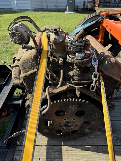

Steve.  Thank you.  Unfortunately, someone came out to the farm and stole the head. Thus the block is frozen and the the oil pan rusted out, thus, the block is not likely useable.

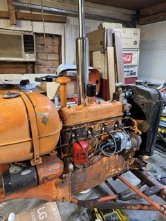

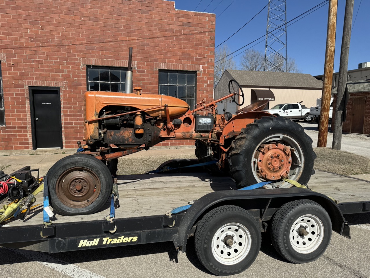

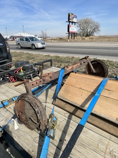

Here are a few pic's of the other CA we bought.  Was a 750 mile road trip with my friend... was a great day.  Has not run for a number of years. While it was outside, it had been covered and turned over (vs. my Dad's).
Between the two tractors, and a few other parts we will put it together.
Edited by CA13414 - 16 Jul 2025 at 6:44am

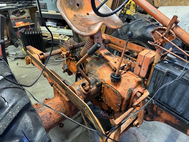

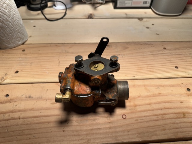

It did take a few hours to get the other one running.  Was a combination of fresh gas, ignition and retiming. The magneto was off by 180 degrees when at TDC w/ compression.  Not sure why, but suspect it was removed and replaced at TDC exhaust vs. compression.
Once running and timed, there was good oil pressure and no leaks.  Coolant was in good condition as well. Actually ran well after the carb was adjusted. Definitely needs a carb rebuild and we will check compression.  If needed, excited to rebuild the engine.

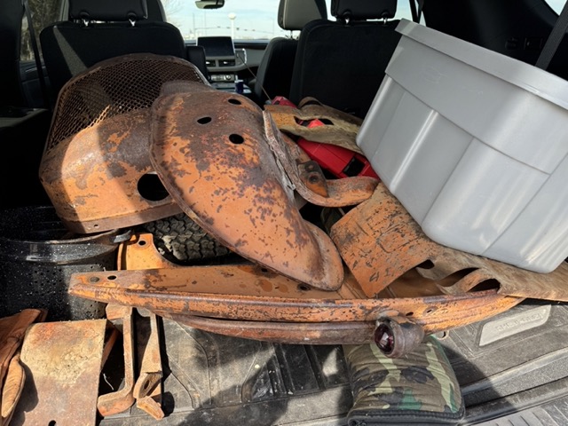

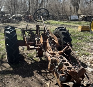

Back on the Farm:  GP/Dad's CA transmission was frozen. Could not take it out of gear, the clutch was frozen, the PTO was frozen and could not engage or disengage.  When we pulled it from the trees, the wheels were also frozen.  Not sure there is much to salvage without an entire rebuild of the transmission which would be a much larger project.  While I would love to carry over the serial number, not likely or practical to do such. Maybe someday when we have a bunch of time.
Thus, for now we took the tin, radiator leuvers, seat, platform, fenders, throttle and choke control rods.  Everything we could strip down to engine and transmission.  My GP/Dad's front end was in great shape and much better than the other.

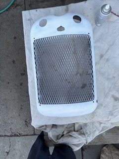

This past weekend my bother and friend took the loose parts and sandblasted them.  Also took out all dents and primed the pieces. Awesome job Bro!!! Will store these until we have replaced all the hoses, rebuild what we need, cleaned and sandblast the remaining and assembled.
More to come.  Here are all our parts from GP/Dad's CA!
The skeletal remains of GP/Dad's CA.
Here is the primed Grill...... part of "Team CA Restoration" efforts!!  Awesome job!

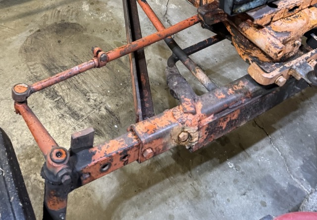

The front end looks simple, but suspect there will be surprises.  I was looking for front end spindle bushings but cann't find any.  Just in case old ones are shot.  Hope I will be able to get them freed up.  Tie-rods appear good but we will see.

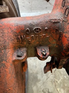

I'm really happy for you to be bringing a piece of your family history back from the dead.  It's the relationship with a 'family' tractor that makes it even better to be rebuilding, albeit with some 'farmed in' pieces.
You CAN save the serial #, but it'll entail a lot of work, but in the end you'll be VERY happy with the outcome and have the family heirloom back in working order.
You should have NO problem with finding parts as there were a number of these made, although they are getting scarcer all the time.

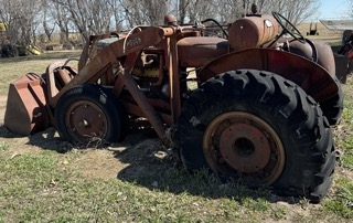

Found a picture from someone else on the web who has restored the exact Hough loader I rebuilt in High School.  Ends up this is a rare Hough combination with a Farmall M.  Ours is missing the tin, but otherwise looks the same with bad tires and weathered paint.

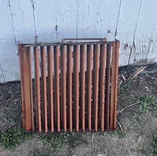

My sister took off the radiator leuver.  Awesome job!
We will pick it up tomorrow!!!

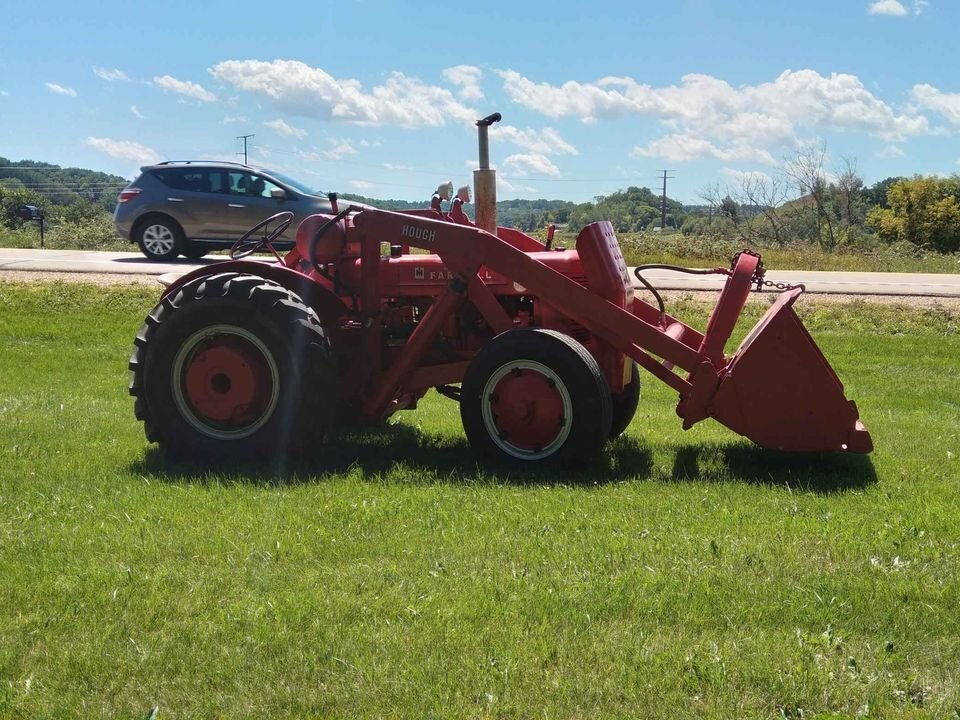

Here is the unique Hough Farmall M that I rebuilt in HS.  Not as nice as the prior post but the same model without the tin.  Does need a little TLC from someone.

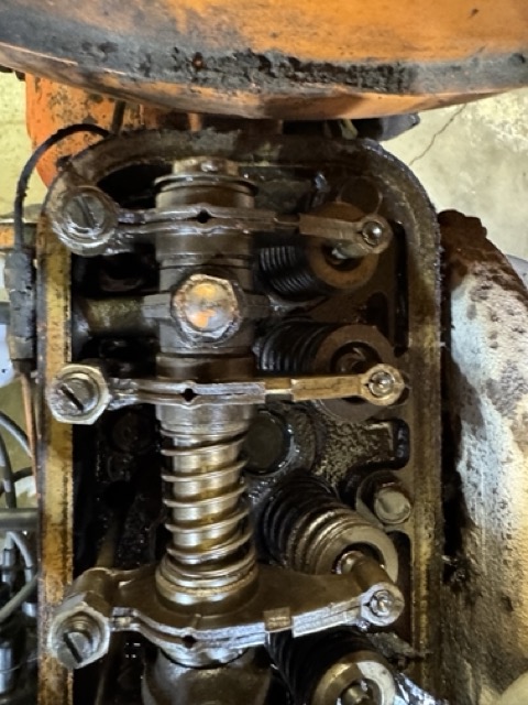

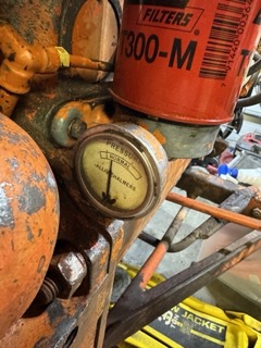

Changed the oil and filter today.  Also took off the valve cover and was pleased to see this was very clean.  Very easy to start and runs awesome.
After warming up the engine, the oil pressure at an idle was awesome!  From others in the forum, would suspect this is 15 PSI.
We also checked the compression pressures in each cylinders.
Cylinder #1:  130 PSI
Cylinder #2:  135 PSI
Cylinder #3:  135 PSI
Cylinder #4:  130 PSI
These were awesome and better than expected. Great news!
I do not think we should do anything else with the engine but clean it up and work on the rest of the tractor.
I have no history on this unit, but I have to think this has been rebuilt with all the above.  As well, I know the last owner did have the Mag rebuilt and put on a new water pump.
So overall excited about the condition of the engine.

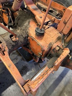

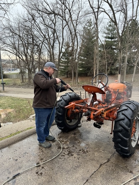

Power washed the whole unit.  Took about 4 hours total with a ton of degreaser.
After power washing.  Much better.  Still needs a bit of "elbow grease" in a few spots.
Need to clean up the brake pad and drums within the axil.  They both are are full of years of dirt, corn shucks and other.  Weep holes are also plugged up!!  Drums look Ok, and it looks the the pads have been replaced at some time.  Will still replace them now since it is stripped down.
Also noted that all that the prior owner put wax plugs into each threaded hole in the chassis to prevent rusting.  Someone who took care and thought ahead.
Before we tear it down to clean, repair and rebuild, and replace gaskets that are leaking, we did want to change out the muffler. OK, just wanted to put it on to see how it looked and sounded.

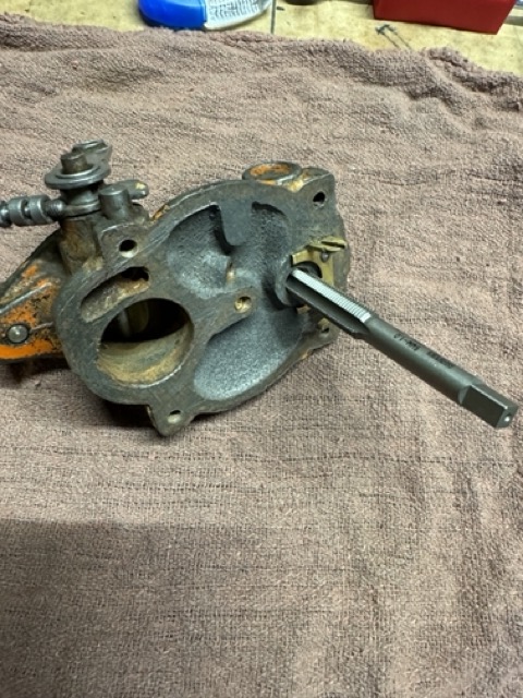

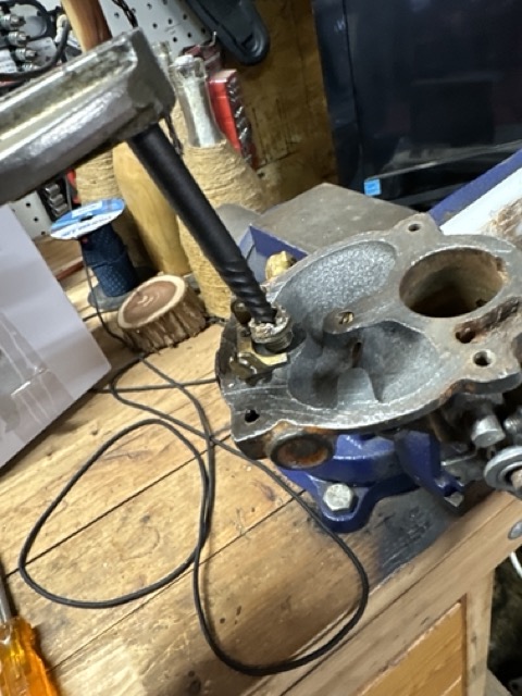

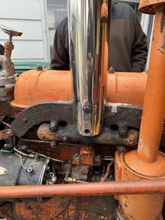

HOWEVER, as you might expect, I broke off the bolt in the exhaust manifold despite some heat.  This was the bolt that passes completely into the manifold.  The other one came out with a little heat from the torch.
Thus, our 5 min project became 90 min.  We drilled out the bolt and retapped the manifold (used magnets to catch the shavings). Here it is with the new muffler which really changed the sound of the tractor.  Sounds and looks awesome.
Has anyone ever used stainless steel bolts in the manifold to prevent future breakage?

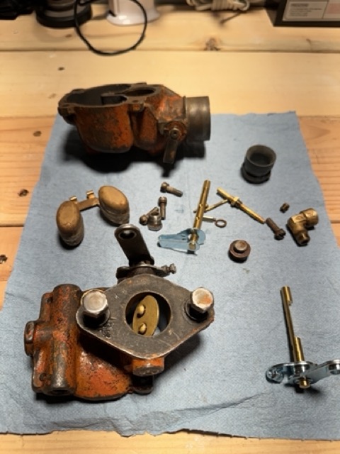

Pulled the carb and stripped it down.  After a soak in the cleaner, it is now ready to reassemble.
CA13414 View Drop Down
Joined: 25 Feb 2024
Location: Nebraska
Points: 407
Post Options Post Options   Thanks (0) Thanks(0)   Quote CA13414 Quote  Post ReplyReply Direct Link To This Post Posted: 29 Mar 2024 at 7:13am
Reassembled and will put it back on tomorrow.  I am always amazed how many little parts there are and yet quite simple overall!

Points: 9238
Post Options Post Options   Thanks (0) Thanks(0)   Quote SteveM C/IL Quote  Post ReplyReply Direct Link To This Post Posted: 29 Mar 2024 at 8:07am
stainless bolts are usually not hard bolts. I would use grade 5 with antisieze. Grade 8 ok too.
Joined: 25 Feb 2024
Location: Nebraska
Points: 407
Post Options Post Options   Thanks (0) Thanks(0)   Quote CA13414 Quote  Post ReplyReply Direct Link To This Post Posted: 29 Mar 2024 at 4:19pm
Thanks Steve!  Will do exactly that!!
< id="idg-io-safe-browsing-enabled" ="" oninit="true">
Edited by CA13414 - 29 Mar 2024 at 4:20pm
dfwallis View Drop Down
Joined: 09 Mar 2023
Location: Texas / Indiana
Points: 1052
Post Options Post Options   Thanks (0) Thanks(0)   Quote dfwallis Quote  Post ReplyReply Direct Link To This Post Posted: 29 Mar 2024 at 6:25pm
316 stainless has a tensile strength of 180000 psi which is higher than grade 8 of 150000 psi.  Just don't use 314 or 18-8.
1952 CA13092, CA Pickup Plow, CA Cultivator, CA Two Row Planter, Dunham-Lehr GC78 Disc, Grader Blade, 3pt Fm180 Finish Mower
Joined: 25 Feb 2024
Location: Nebraska
Points: 407
Post Options Post Options   Thanks (0) Thanks(0)   Quote CA13414 Quote  Post ReplyReply Direct Link To This Post Posted: 29 Mar 2024 at 8:27pm
Thank you!!
I do love marine grade (316) since it is the only one who will not rust in harsh conditions.  I use it all the time for that reason.  Did not know it had that tensile strength.
If this is used, I would expect you would not "rust" to the manifold, and still have the strength to remove from the manifold years from now.  If you did break it, it would be a pain to remove/drill out!

Still needed to change out the float valve needle and seat, however, after decades of fuel it took a screw extractor to remove the brass seat. Also had to tap out the threads to put n the new valve seat!! Re-attached the carb and it ran beautifully.
Also was able to remove one of the front spindles arms and remove the spindle on my GP/Dads front end that was frozen up. Sprayed down the other one with Panther Piss.  Yes that is what my Dad called it back in the 60's and it as stuck!! Will have to do the other one on another day.  I already ordered new spindle bushings.  Then need new front bearings and we will replace whole front end.  I will add pics of this effort later.
Replacing the front end with my GP/Dads CA........ Mostly to have parts from the family tractor and since the current front end is quite damaged with much artful welding of everything including angle-iron reinforcements.
