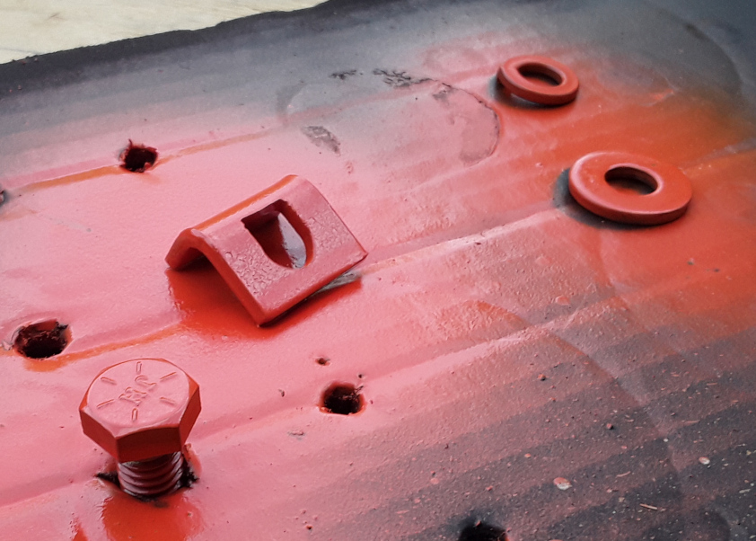

Post Options Post Options   Thanks (0) Thanks(0)   Quote Jay Tee Quote  Post ReplyReply Direct Link To This Post Posted: 13 Jul 2025 at 7:41pm
Had a little bit of time to make a magneto clamp out of 1" flat stock
