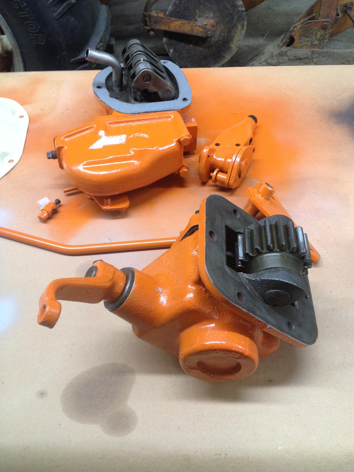

 I did a color change up on the wheels of the WD's I completed this year. I think if its clean fresh and functioning you can have a lot of fun and maybe do some work too.
I would recommend that you look that pump over close. As mentioned the upper thumb screw seems to be missing in your painted pictures? Maybe I cant see it? but all those screws and knobs have a function and they all need to be there and able to function by hand.
In hind site I would have recommended that you get a hyd. pump rebuild kit from one of the sponsors. I replaced gaskets on one of mine and have a leak at the front adjusting screw. On the other pump I went through the whole thing and replaced o-rings and gaskets. I felt it was worth the effort. Looks to me like you are highly capable of the project. There is nothing to magic about these and I know I had a couple questions during the rebuild and called Sandy Lake and their tech walked me through my issues.
Couple shots might help??

yes, in hindsight, a rebuild kit would have been nice. i DID make new gaskets for it, but all the lil' "o"rings and ball bearings would have been a good thing to replace while i had it all apart. i should have just cleaned it all up as an entire unit, but the my mechanical inclination took over and i needed to open it all up lol. fortunately, if/when i get this all figured out, i should be a wd45 hydraulic guru! i just came in from the shop after making more adjustments and sill nothing. i have a feeling it will be coming back out, so it may get a rebuild kit after all.
on another note, i see you hsave a jubilee and some cubs..my farm buddy cousin just acquired a jubilee and a cub from his grandpa. we have also been playing with those trying to get them cleaned up and running good again. love workin' on these old tractors, so it makes these issues a lil' more ok. thanks for your post and the pics bud

here's another pic. not sure why you can't see the thumb screw in that other pic. could it be that that cam is turned wrong?? when i rotate it all the way up, it barely clears that hole that it locks into on the opposite plate. in the old dirty pic, it looks like it goes much higher (more vertical) that what it does on the tractor now. that cam just looks wrong the more i look at i just can't put my finger on why. the thumb screw is for sure there though. if that cam isn't the issue, i must have done something wrong to the inside when i had it apart (which would suck lol) i'll keep situation posted

Eric, if your picture reflects the way that you have actually used the Hold Position Valve, you were not set up for draft control but rather for delayed lift or hold position.  Here is a pic of mine that I snapped long ago of the HPV in hold position mode and you can see the position of the cam shaft and control lever.
The plates are locked together.  You could remove the connecting link to the drawbar spring and not know the difference.
I see that the appropriate parts explosion is missing from the Op manual that I sent to you, so I will send a different, older one.

I see the thumb screw plain in that picture. Must be hidden on the tractor.
FYI I did not have that spring in place on mine from the cover down. Both my tractors needed quite a bit of attention on this pump and controls. They had been messed with a lot over the years and were just way out of whack.

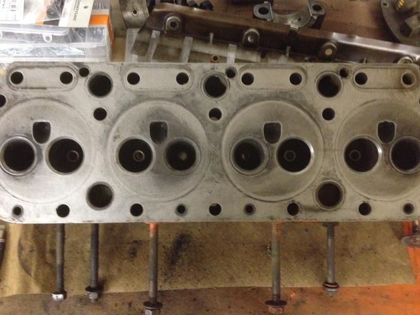

and here are some of the pics of the 45 engine
notice how the wrist pin is worn on either side..
also noticed a bunch of scratches on the head..assume that's from previous owners scraping gasket or something???
and here you can see 2 distinct marks where the wrist pin has rubbed the cylinder sleeve
