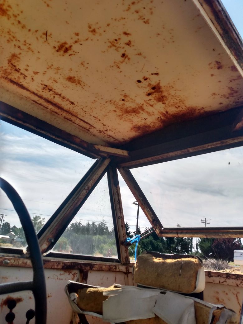

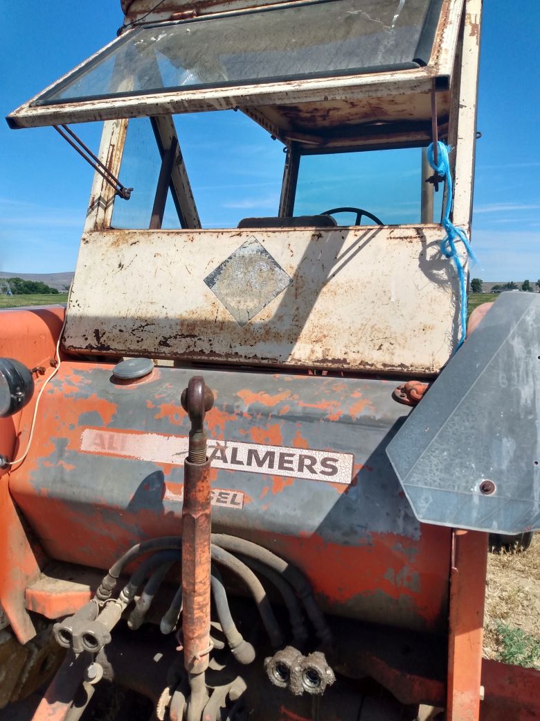

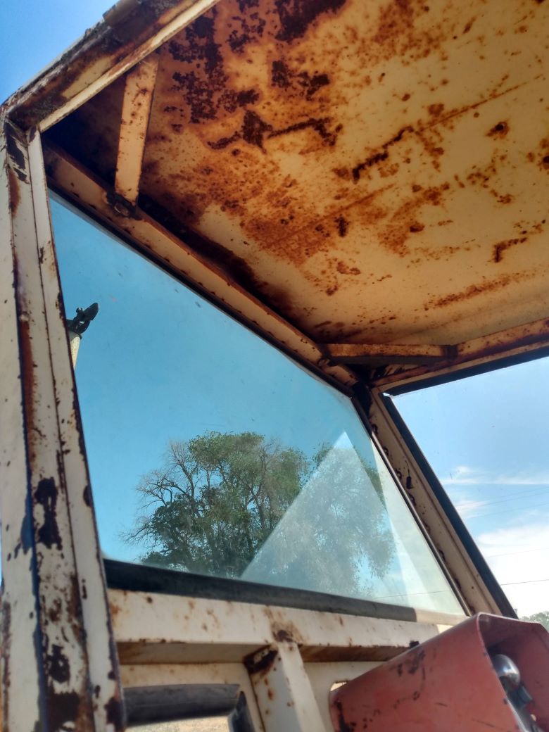

I had the day off work so I was able to get a few more pictures of the cab.
I started it again and paid a little more attention. About the time I start to get worried about starter temperature it speeds up a little and makes a little smoke. I might have eventually got it to go, but just gave it another small shot of ether. Once it fires it is running, no stumble or build up to speed and not enough blowby to notice. I looked at my other 190XT with the bad engine because I am thinking about pulling the pump and injectors from it and get them checked out to replace what is on this one, and I noticed the hand primer. The series I is missing it, and just has a rubber hose in it's place. I know there are check valves in the primer, could this be why it doesn't want to start? Agco still sells the pump new, the tube from the primer to the filter is on backorder, and the fittings may be a little more fun to find.
