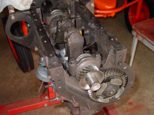

I am trying to reassemble an Allis G engine. I am have trouble figuring out the brass thrust washers on the crank. When we disassembled we only found one partial washer in the oil pan. I see the outer washer is held in place by pins. What holds the inner one from spinning? There are no pins, or holes where there should be pins. I also may be in need of the crank gear, the oil slinger, steel shims and the steel thrust plate.
Thanks in advance for any help anyone can provide.

There might be some details in the shop manual:
http://geraldj.networkiowa.com/Trees/Allis-Chalmers-G-B-C-CA-Service.pdf

It has been 15 years since I was into that engine but as I recall you are correct. It slides on the crankshaft before you drop it in. As I recall I had to remove the crankshaft gear several times to get the shims behind it correct for the .001 end play clearance.
