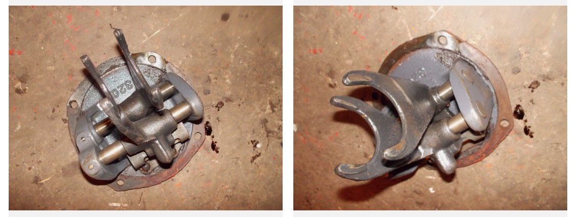

the round plate has the shift forks and rods mounted to it.. when you pull it out, the forks will disengage the gears.... replace the gasket and watch what your doing when you reinstall... shift lever does not need to be removed... but it pilots into grooves in the shift rail when you reinstall..
Points: 93294
Post Options Post Options   Thanks (0) Thanks(0)   Quote steve(ill) Quote  Post ReplyReply Direct Link To This Post Posted: 30 Aug 2026 at 4:15pm
looks something like this....
