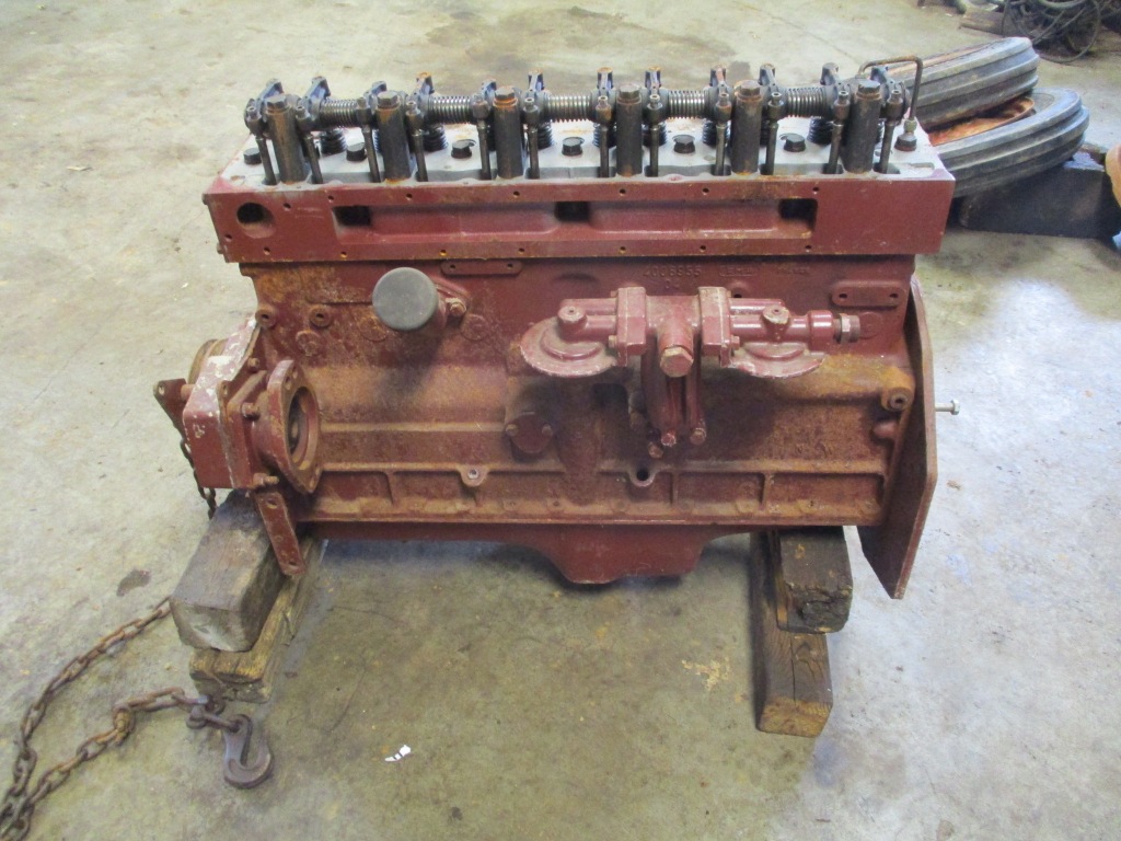

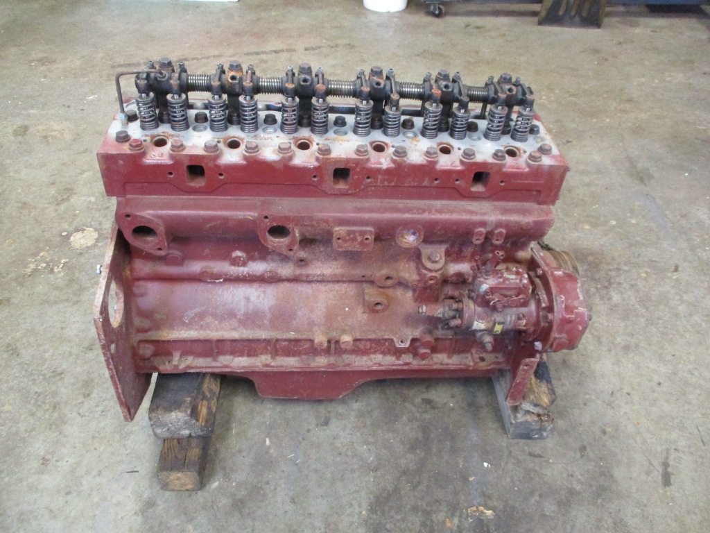

Allis Silver Pony View Drop Down
Joined: 26 Jul 2025
Location: New Mexico
Points: 12
Post Options Post Options   Thanks (0) Thanks(0)   Quote Allis Silver Pony Quote  Post ReplyReply Direct Link To This Post Posted: 11 Jul 2026 at 4:05pm
Heyfound your posts. Hope the project is coming along well. I have a similar one. Oh and the critism never ends does it. Just go with the Cummins, its so much easier...blah blah blah. I get it though. So anyways, let me tell you about my project so far. I have been away from it for a while. But Im slowly working on it.
Allis chalmers 301
Ported head
Tuned fuel pump 198cc
Allison 1000 transmission
2007.5 GMC 3500
The engine is completely apart and has been cleaned. I gave it a acid bath. I was very impressed with how it cleaned up. I painted the block and head red. I know honestly I could only get my hands on red. It looks sharp.
New injectors to match the pump flow. Im ggoing to build a new manifold and working with a shop to put twin turbos on. This will allow me to capture a powerband down low and up top. I ported the head. And its at a shop currently getting new valve seats and planed. The machist ordered aftermarket valve springs. The stock springs were somewhere around 40lbs closed and 80lbs open. Given that its going to have 35psi boost. I needed something closer to 100 lbs closed and 200lbs opened. Anxious to see what he ordered. Its a project I want to focus on, but its gona take some time. Lets get to the allis transmission. Obviously its the transmission that came with the truck. And the transfer case. The transmission is an excellent one. Going to beef it up a little bit. Since it has plenty of miles on it anyways. Lockup converter and its currently a 5 speed. Its possible to go from 5 to 6 on these. I plan to go to the 6. This is exciting and definitely love making progress when I can. Critics will harass us to no end and it makes the end all that more valuable. Trust me digging into this just doeshave the suuport on literature and aftermarket that cummins does. And yeah if we were to take a 5.9 and tune it up we could and get alot more potential out of it. A P7100 on a 5.9 has somewhere around 800cc fuel delivery capability. But thats insane. This DB is tuned to 198cc. Im not really sure off the top of my head what a stock one is for a 7020 tractor. But its significantly more cc. Every part is pretty expensive. The cooling for this bad boy is gona be something. Gona put a intercooler and large oil cooler. Anyways your idea of what I have heard is solid.
