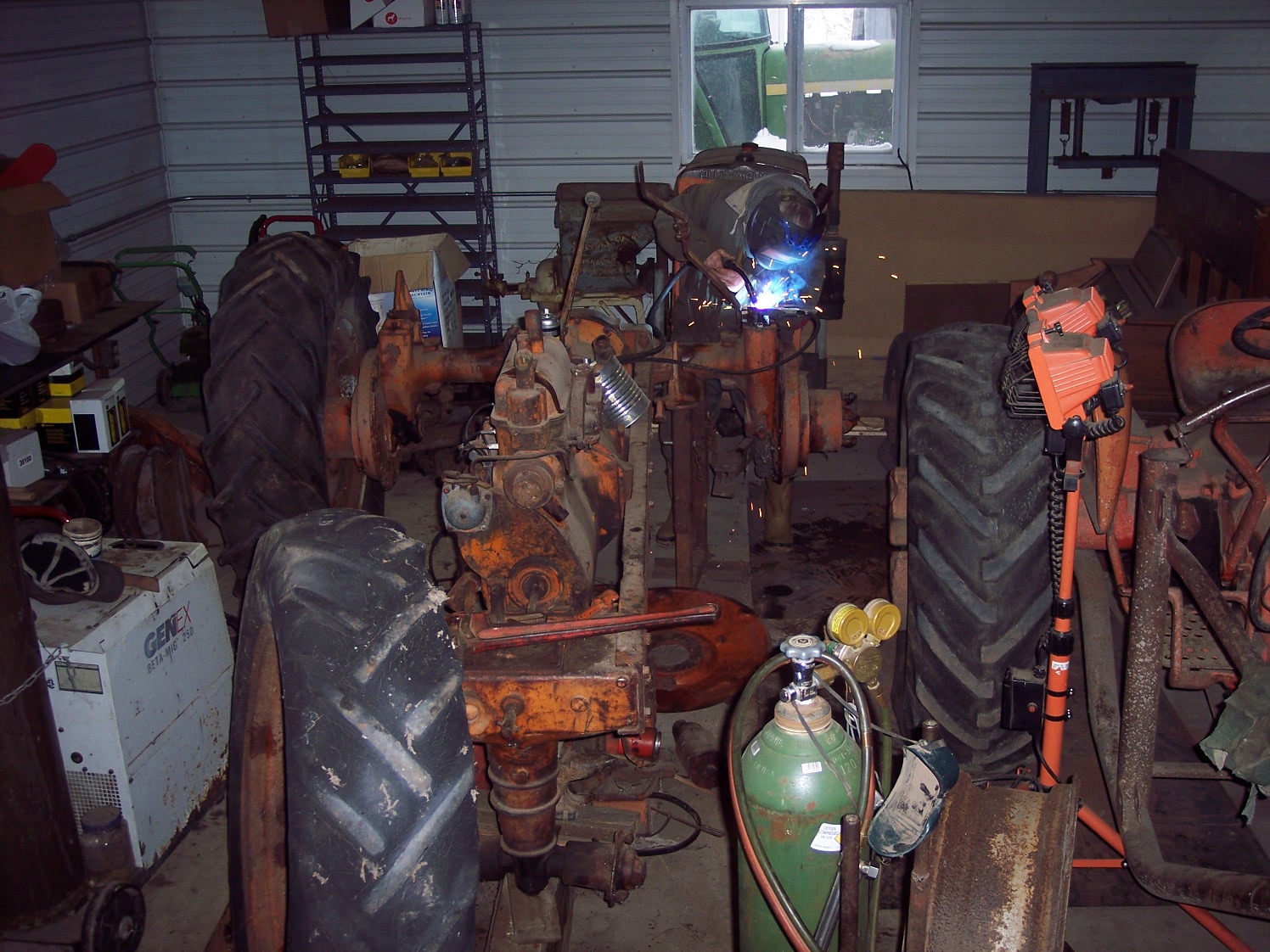

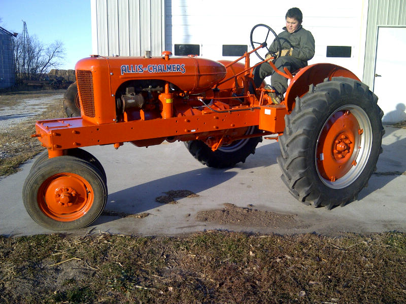

Looks like you have a nice tractor to start with and a fairly "easy" restoration. Good luck!   My Dad and I restored his a few years ago- several "special" parts to the RC. You've found a good group of people to help you as they did me
Before and after:
Edited by WC7610 - 18 Jan 2017 at 11:18pm

That is really nice,like a b with super duty drive train.And easier to get in the seat.
2 1949bs,one with belly mower one with side sickle bar

Wow! That is what I can say about your restoration.  I hope mine can be half of what your end product is.  How long did it take you to finish that project?  I have pretty much decided to restore mine.  Trying to figure out how much time the truck has to spend outside. :)
