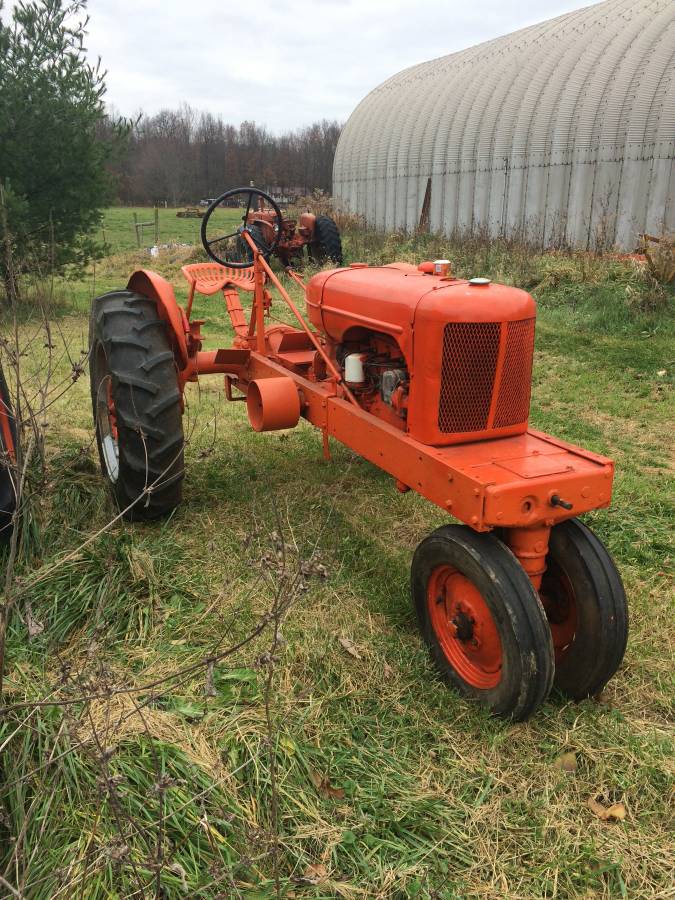

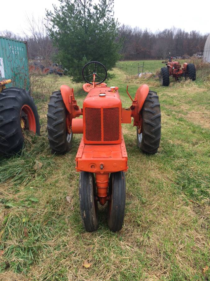

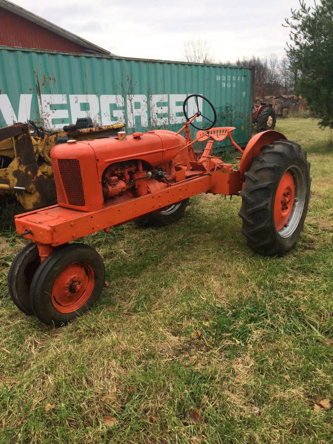

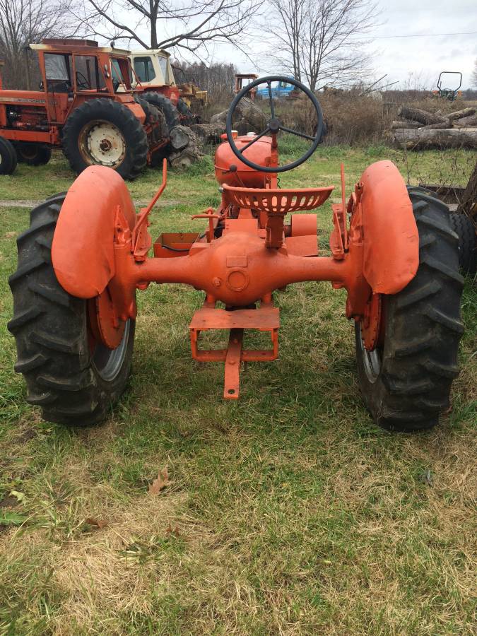

Posted By: KD8NGV
Date Posted: 16 Jan 2017 at 6:08pm
The pictures that were on Craigslist...

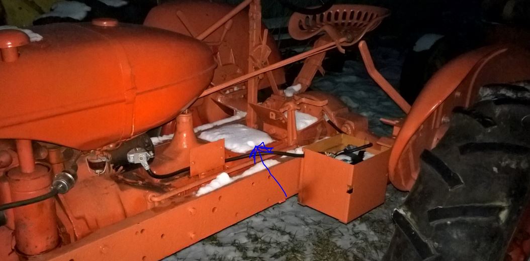

Posted By: KD8NGV
Date Posted: 16 Jan 2017 at 9:28pm
Ok, so my general rule of thumb is when I get a new machine, be it a lawn mower, truck, or tractor, the first thing I do is introduce her to the others and welcome her home.  Then after that is to change all the fluids.  When I was inspecting the RC I saw that the transmission had oil shaped like a sponge and not enough in the resevour.  Check that, I made a mental note.  Then I looked at the rear differential housing: It looked like it had been painted over many times over many years. 'I bet that the oil is real bad in there,' I said to myself. The crankcase oil looked a nice shade of amber when I looked the RC over the first time we met, but it was still slated to be changed.  Along with those oils, I will change the coolant and final drive oils.
A question I have for those of you reading this is:  Does the transmission and rear differential share oil?
I drained the "oil" in the transmission and rear differential tonight, January 16th. I will share that post soon.  Tomorrow is my birthday and I do not know if I will have time to go out to the shop tomorrow.
Kevin

Posted By: TomMN
Date Posted: 16 Jan 2017 at 10:06pm
Looks like a nice one.  To your question, yes they share gear oil since there is no seal between them, but you will need to fill and drain them separately.  There are a whole bunch of differences between the RC and a WC so it is a bit of a stretch to call it a WC with a B motor, but that was the basic idea behind it.  I took lots of pictures while going through mine, you can look at them here:  http://www.allis01.com/fossto/39RC/ac-RC.html" rel="nofollow - http://www.allis01.com/fossto/39RC/ac-RC.html

Posted By: Gary in Texas
Date Posted: 17 Jan 2017 at 4:53am
The trans and diff DO NOT share the same fluid!!
The are not inter connected except with the differential/accessory drive.

Posted By: TomMN
Date Posted: 17 Jan 2017 at 8:39am
My comment that the transmission and rear end share fluid is qualified with "since there is no seal between them", gear oil is free to pass from whichever one has a higher level.  As I said they need to be filled and drained separately.  The manual calls for the same gear oil in both as well.

Posted By: TomMN
Date Posted: 17 Jan 2017 at 12:33pm
Yes, feel free to ask.  I doubt I will know all the answers, the web page might make people think I know what I am doing but I am a hobbyist and this isn't my profession by any stretch of the imagination. I will share any information I can though.  My email address is located at the bottom of the main web site http://allis01.com
Unless there is a very seriously leaking seal there shouldn't be any oil coming out from the clutch housing access panel. :-)

Posted By: KD8NGV
Date Posted: 17 Jan 2017 at 8:14pm
Today's update: January 17, 2017
I went out and checked on the draining of the transmission oil and the differential.  From what I can tell the transmission is drained out.  The differential still has a lot of sludge inside.  I hope to post the pictures of what I was faced with.
I started with the transmission oil draining first (yesterday).  When I opened it up, which thankfully the plug came out ok, it had some water come out and then nice goopy sludge oil.  It came out very slow, like it almost was like molasses.  Provided it was about 40* in the shop, it still moved very slow.  I put a bucket under it and went to the rear.
The rear differential had the filler plug painted shut.  It looked like it had never been opened.  Perhaps in the fifties??  I was determined to take out the plug and reached for my lovely dental pick.*  I used that to chip away at the paint and eventually got it all off around the plug.  Add some PB Blaster and a few hits of a dead blow and she turned open.  I looked inside and saw gears, check, sludge, check, and some semblance of oil in there.  Well it needed to be drained.  Went underneath looking for a plug and found it rear of the two halves and on the driver side.  It is a plug with the square inset drive.  Add some PB and the dental pick and a ratchet extension and wah-lah the plug came out.  BUT NOTHING ELSE DID.  What the devil?  I looked up and in the hole and it was like someone put a rubber plug in.  I stuck my pick in there and as suspected, it was hardened sludge. I poked a few times and out came some water (not as much as the transmission) and then globs of sludge oil.  It was very slow.  After seeing that it needed help, I stick the pick in the hole and wallowed it around.  It seemed to bring the globs out better.  I let it sit overnight and came back today and here we are.
I need to figure out how to get the rest of the sludge out.  I am thinking about plugging both the transmission and differential up and filling up them both with kerosene.  Then drain and repeat until clean.  I really need to invest in a bore scope!
So in the mean time I also went looking and found that my engine is most likely not from an RC, which is a bummer.  It is marked as CE 44372 G.  I think this is supposed to be for a C not an RC.  It has the generator bossed in the casting and there are a few bolt holes not being used.  I will post photos of these.  I also notice that the headlights, electrical box and started rod are all MIA so I have to add that to the list.
Whats next??
I hope to flush the sludge out with kerosene, or what you guys recommend.
I hope to drain the final drives.
I hope to drain the antifreeze.
Thanks for following,
Kevin

Posted By: TomMN
Date Posted: 18 Jan 2017 at 6:54am
I have used kerosene to clean out the old nasty sludge on things I don't plan to tear down soon.  Having it warm would help with that too.

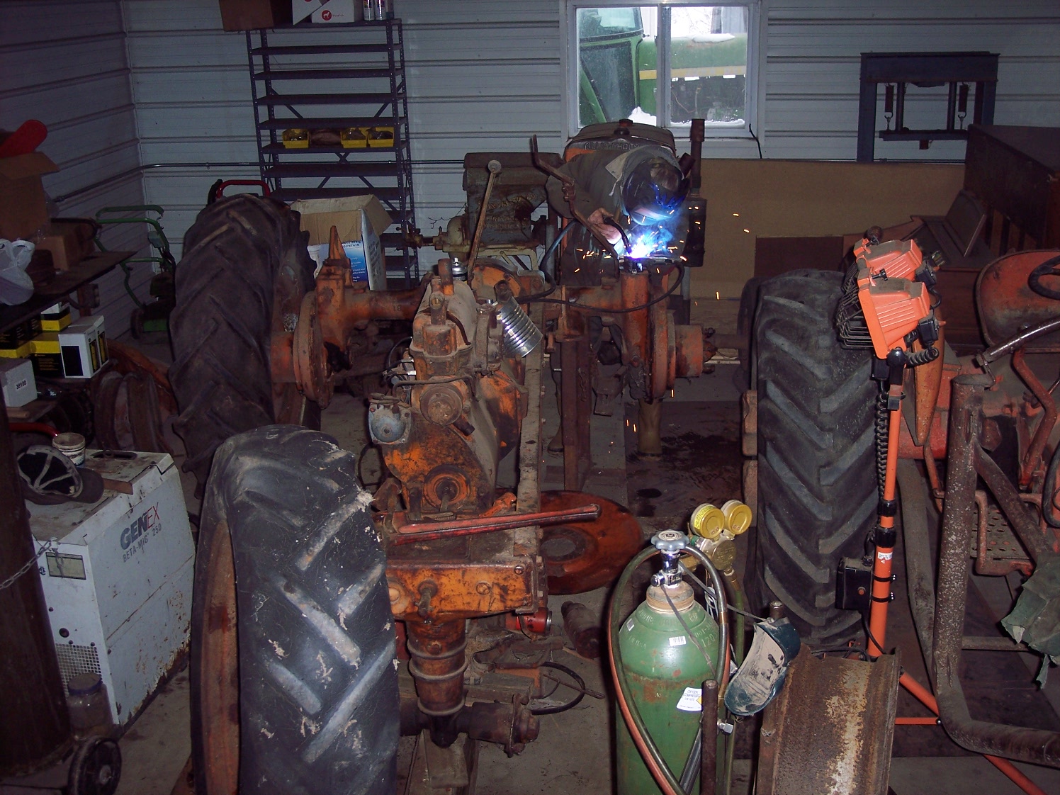

Posted By: WC7610
Date Posted: 18 Jan 2017 at 11:14pm
Looks like you have a nice tractor to start with and a fairly "easy" restoration. Good luck!   My Dad and I restored his a few years ago- several "special" parts to the RC. You've found a good group of people to help you as they did me
Before and after:
Thanks
Posted By: Tom Elder
Date Posted: 19 Jan 2017 at 6:24am
That is really nice,like a b with super duty drive train.And easier to get in the seat.

Posted By: KD8NGV
Date Posted: 23 Jan 2017 at 7:56pm
Before and after:
Wow! That is what I can say about your restoration.  I hope mine can be half of what your end product is.  How long did it take you to finish that project?  I have pretty much decided to restore mine.  Trying to figure out how much time the truck has to spend outside. :)
Thanks,
Kevin
