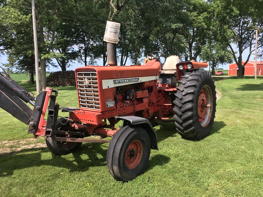

I'm going to dispute this a little, just a little. My 756 has 10.00x16's on what I assume are the factory rims. It would have had 6.50x16's originally. They don't look bad, but not quite right either. I have no plans of changing them... The 185 has 11L15's on, I believe IH rims. They were on a 966 is the info I got at the sale. Fit, work. and look great to me.

Mike, They've been on it almost 10 years, no issues except tires starting to weather crack. Carries the loader a lot nicer in soft dirt than 9.5Lx15 did.
 The tires and rims were found in a friends in-laws machine shed, while getting ready for estate auction. My pay for a days work.

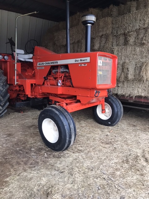

Found some rims from a 200 today, has worn out tires on them but it allowed me to see how they fit. Just need to sand blast, paint, and install new tires. 11L-15. Will save me about $250 going with used rims.
Edited by AC720Man - 25 Nov 2022 at 10:38pm

The sideways picture problem is back ugh. Anyway, I finally got my tires and wheels on today. Will have to wait until spring time to touch up the paint. Very happy, 11L-15 Carlisle.

I straightened them out for you ac720man…
And they look really nice!!!

That is one very nice looking XT. If I live long enough, we have a 72 bought new, that someday.....will be restorded.

yours look like they are on 10" wheels, which makes them wider. Mine are on 8" wheels and they look almost like a 9.5L lol! Mine looks a lot like the bar grill xt pictured above. Funny how a rim difference can make a huge difference in the tire.
Points: 5238
Post Options Post Options   Thanks (0) Thanks(0)   Quote AC720Man Quote  Post ReplyReply Direct Link To This Post Posted: 12 Dec 2022 at 8:03pm
Good eye Ed, they are in fact 10” rims. Oddly, they are just about the same height as my 7.50-16’s. I couldn’t be happier with how they look. I was glad I got the Carlisle, made in the USA which surprised me.
