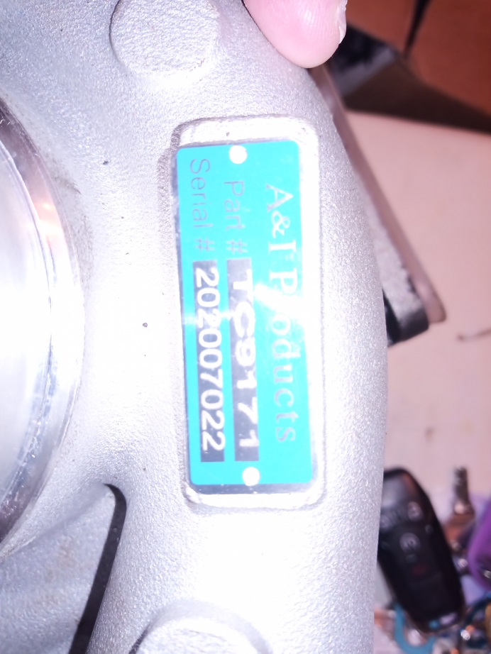

I'm not sure as I bought it off of ebay as an aftermarket designed to fit my application. 190xt with D2900 engine. Is there anyway to tell which one it is like so as to determine what line specs it will use? Thanks for the info.
Points: 22770
Post Options Post Options   Thanks (0) Thanks(0)   Quote DrAllis Quote  Post ReplyReply Direct Link To This Post Posted: 21 Jun 2021 at 8:45pm
There is a metal tag on every turbo that should have the brand name. Air-Research/Garret....Thompson/Rajay.  D-2900's had both brands over the years.

Post Options Post Options   Thanks (0) Thanks(0)   Quote whizone Quote  Post ReplyReply Direct Link To This Post Posted: 21 Jun 2021 at 9:00pm
the tag says A&I Products, Part No: TC9171, has M24 and Air.60 cast on the housing. Hope this makes sense. Thanks.

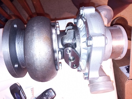

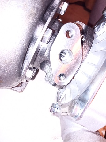

Post Options Post Options   Thanks (0) Thanks(0)   Quote whizone Quote  Post ReplyReply Direct Link To This Post Posted: 27 Aug 2021 at 9:19am
The tractor previously did not have a turbo on it, I am putting a new one on it. Attached are images of the turbo I purchased for it. Thanks for all your help.

Post Options Post Options   Thanks (0) Thanks(0)   Quote Joe(TX) Quote  Post ReplyReply Direct Link To This Post Posted: 27 Aug 2021 at 5:22pm
That's an Air Research clone for 190 etc. It uses the flanged drain line.

Post Options Post Options   Thanks (0) Thanks(0)   Quote DrAllis Quote  Post ReplyReply Direct Link To This Post Posted: 27 Aug 2021 at 7:45pm
Turbo drain tube from a later XT, 200, 7000 many M-series combines should fit as long as it has an Air Research turbo.  The oil feed line may have to be fabricated. Some of them came off of the engine oil cooler (which you don't have) and some came from the engine block itself. If you can find a correct one, great. If not, 5/16" or 3/8" copper tubing and some brass fittings.
