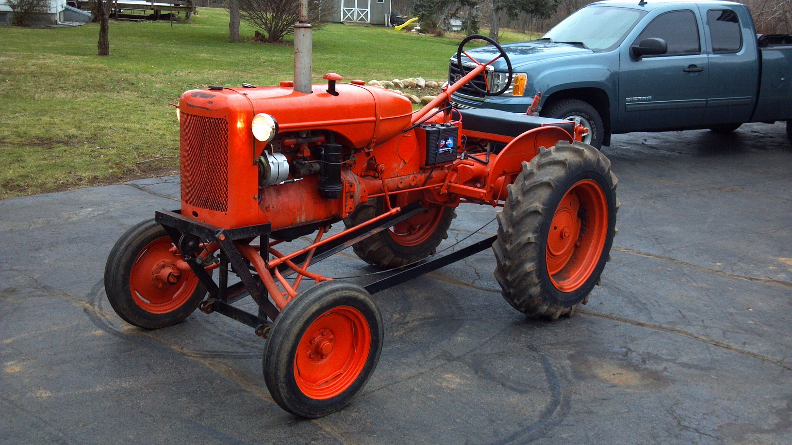

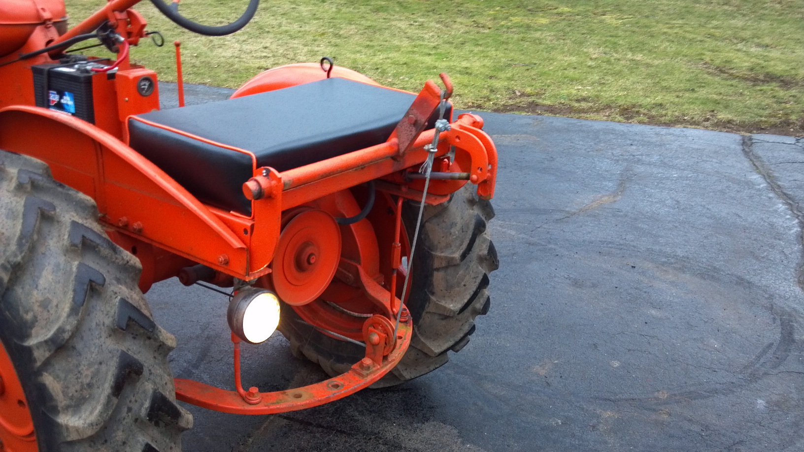

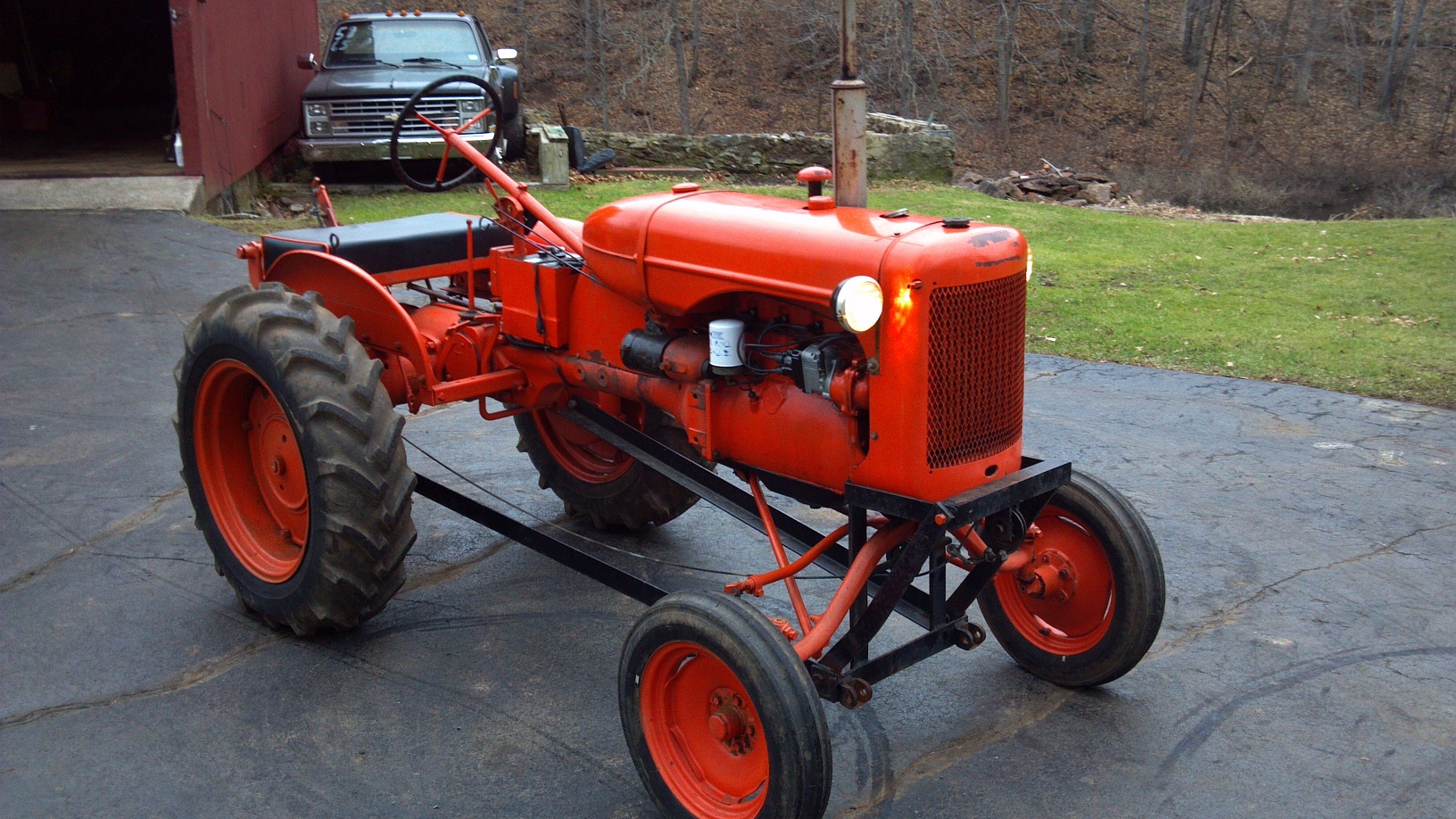

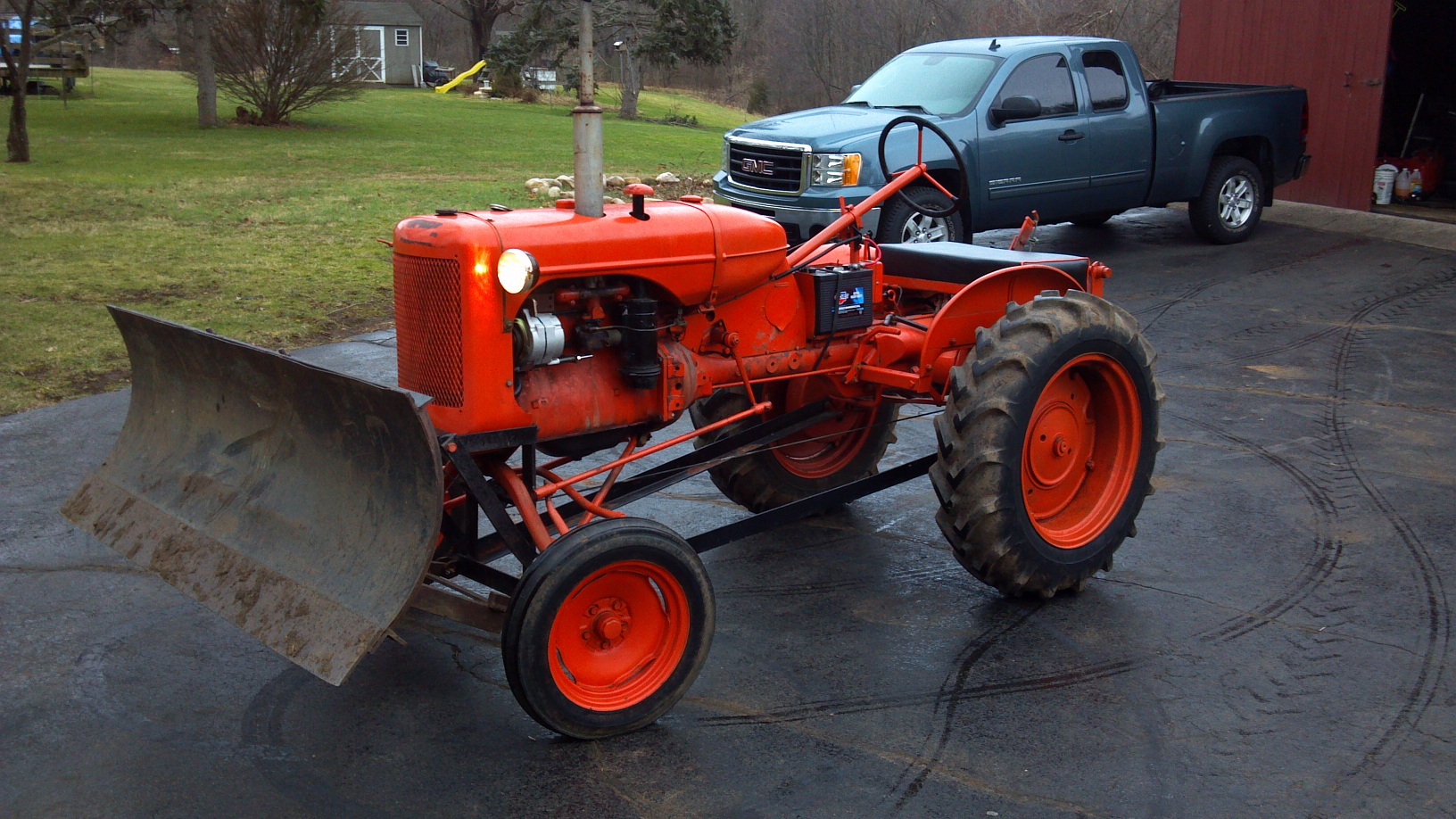

Here's some pictures, and of course the smiling Mrs. now that this tractor is running!
Edited by kwengenroth - 27 Dec 2011 at 2:23pm

From the pictures, it looks like your B is much later than a 1939.  Probably at least a 1950 or newer.  The later B's often came with a Marvel Schebler carburetor.  Post back with the carburetor number so we can double check that you have the right one.  There's nothing wrong with either the MS or the Zenith when they are right.  Having said that, I'd be willing to bet that you either have a dirt problem, a choke problem, or you still have an ignition problem.  Remember that 70% of carburetion problems are ignition related! ;-)

You tractor is much newer then 39. You have a pull starter rod (39 didn't have electric start) which wasn't used until mid 50's. The bottom of the gas tank should be indented above the starter for rod clearance. I have both original Zenith and Marvel carbs on my B's. They both work good, but stay away from the new 1 model fits all carbs. Bob

Like mentioned above I can't see anything about this B that would indicate it was built in 1939. Everything about this B is like much later models. What is the Tractor number stamped into the case by the shifter? It may be one of the low annual production late models.

Tractor # is very worn but appears to be 119903 which would make it a 1953  The guy I bought it from told me he bought it as a 1939.  Oh well...
