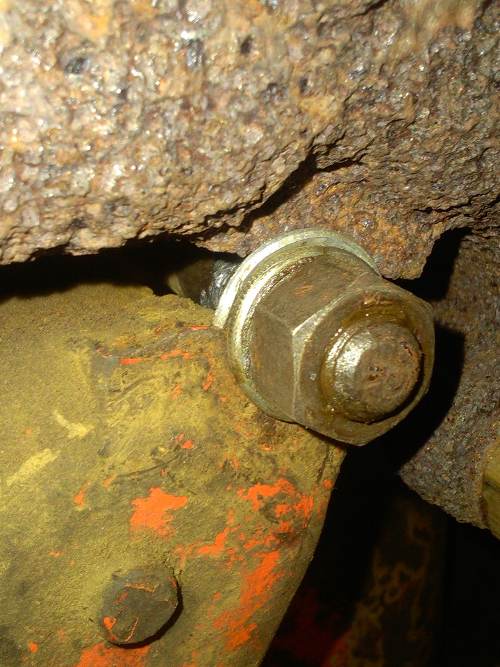

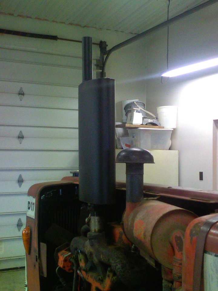

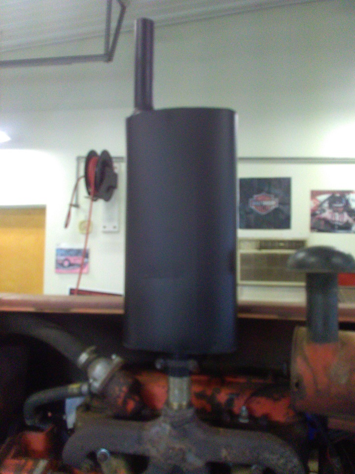

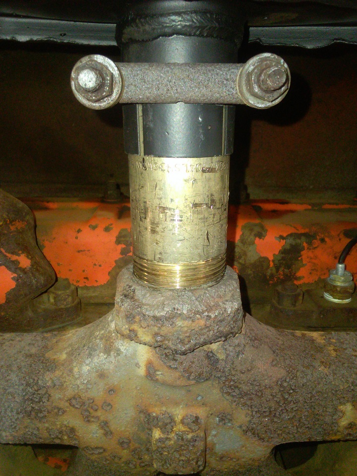

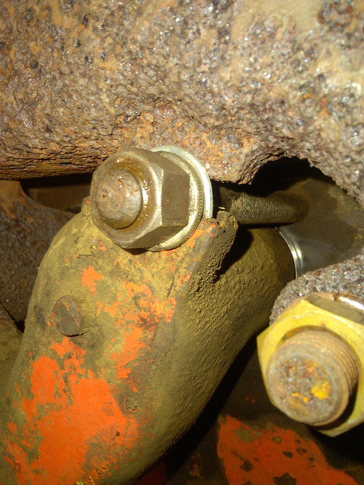

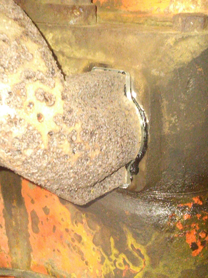

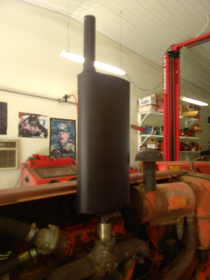

Well I finally got around to resealing the manifold on the d17 and installing the new nelson muffler I purchased from Alex back in February.I had to do a little creative shimming on the rear intake runner stud but it all worked out fairly well.Installed a new stainless pipe nipple as well.I use the walker exhaust sealer on the gaskets which makes for a good seal for many years of service.I used this on my 45 manifold 8 or 9 years ago and it's still leak free to this day.Hard to believe the difference between the old stanley muffler and the nelson,what a beautiful sound.A BIG thanks to  Alex09(WI) for getting these mufflers made!!!

Nice Job, now wheres the before and after sound clips??? Wink
  Nice that you put a stainless pipe on, now that will hopefully outlast the manifold.

JC, I wish I was a little more tech savvy,before and after sound clips would be great.The stainless was a donation from my buddy.He's got loads of that kind of stuff.Got to like having good buds that donate to the cause!!!

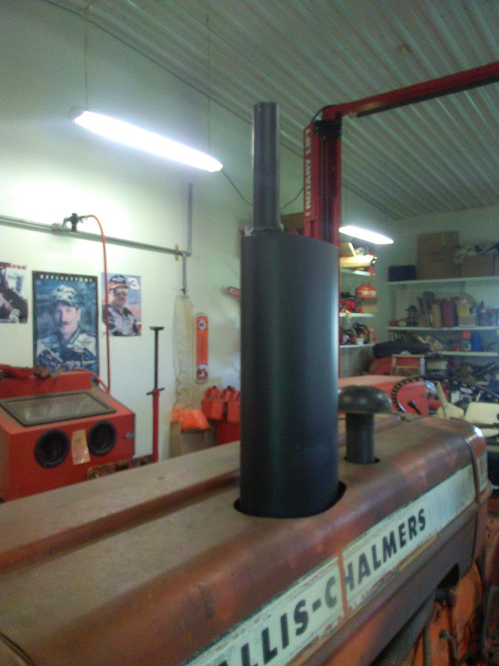

 How do you like the lift in the shop? do you feel its in the way? I have been thinking about one if I ever get a shop built. 12 foot finished ceiling?

Chris, yea I'm ready to work the old tractor here pretty soon. As for the lift, it's not really in the way at all.I'm semi retired from the automotive field so it is a must.I can't imagine working without one.My building is a Morton building with 12 foot walls.The catch is the raised cord truss system and is the reason I get buy with a 12 foot wall and still have enough over head clearance over the lift.Probably 18" or so rise from the wall to the center of the shop.You can kind of see that in the seventh pic.By the way your posts and projects are awesome to watch.Also ,your tribute to Don (MO) was nothing short of great.
