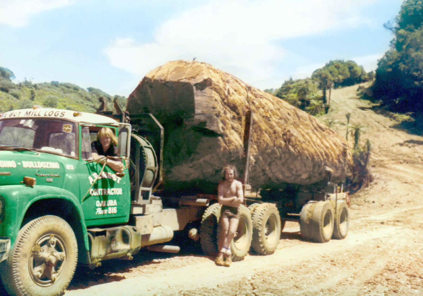

log we hauled from new zealand bush with fiat-allis 11b same as yours.

Need to correct the earlier post.
that particular log was hauled by an allis=chalmers hd11ep. the machine i currently have is the same as yours

West Logging, that is bloody big Rimu; any idea how many super feet ?
 Very impressive log for a 11B, could it actually walk with the log ?
 I had a uncle that logged in Ohura in the 60s and he had a picture of a rimu that was about 13000 super ft. Pulled it with his HD16DC; said she would only just walk with it on level ground, so was all winching to get it out.

between 8 and 9000ft haakon dahl winched all the way on flatish ground, had a d6c pushing where it could.
came from mahoeniu area waitomo, taken to mill in newplymouth by an international f1800d. those were the days.
