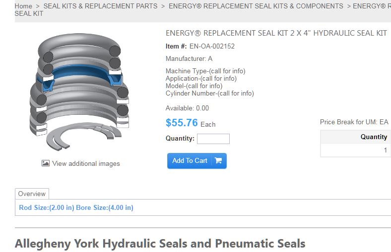

Your right hunter... dont seem to be able to find a 2-1/2 inch ENERGY Hyd cylinder.. There are 3 and 4 inch , but no 2.5 inch...  I have bought packing from ALLEGHENY before.. You might have to call them or send them a note and they can "make up" a kit from parts. ... This is what your packing set looks like.. but THIS IS THE WRONG SIZE... second photo is other TYPES of packing that they sell for cylinders..
Edited by steve(ill) - 23 May 2022 at 10:18pm

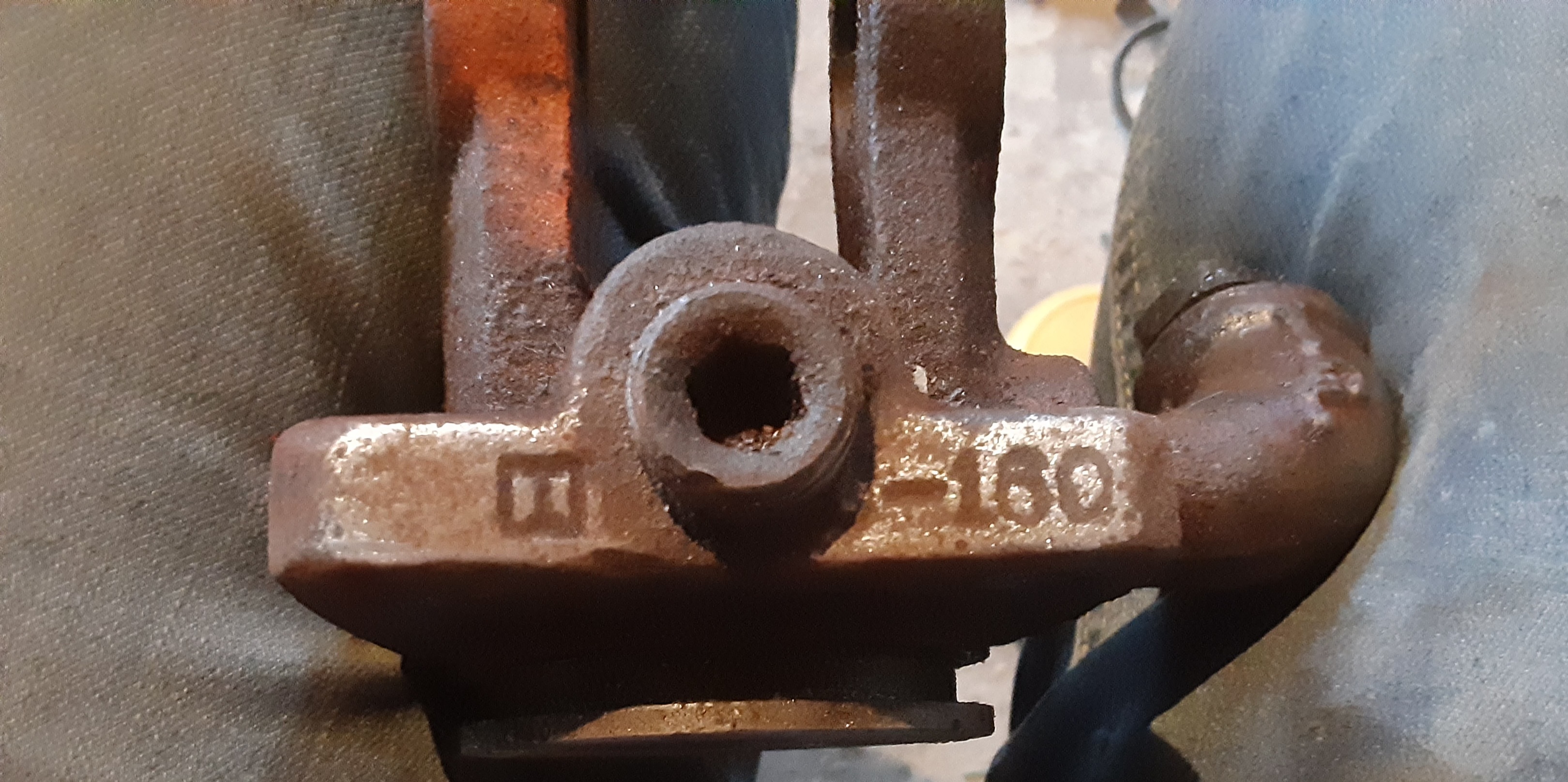

Post Options Post Options   Thanks (0) Thanks(0)   Quote hunter321 Quote  Post ReplyReply Direct Link To This Post Posted: 24 May 2022 at 8:17am

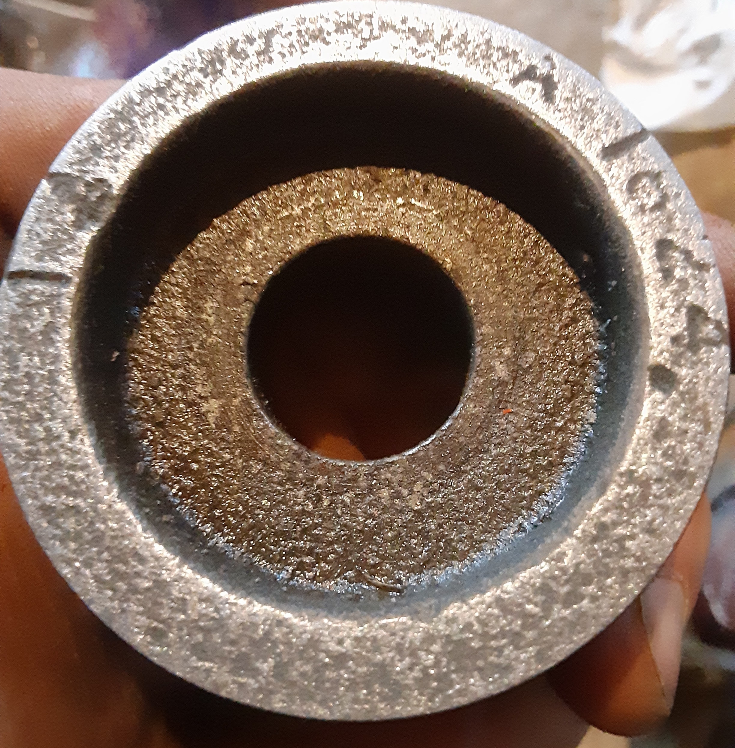

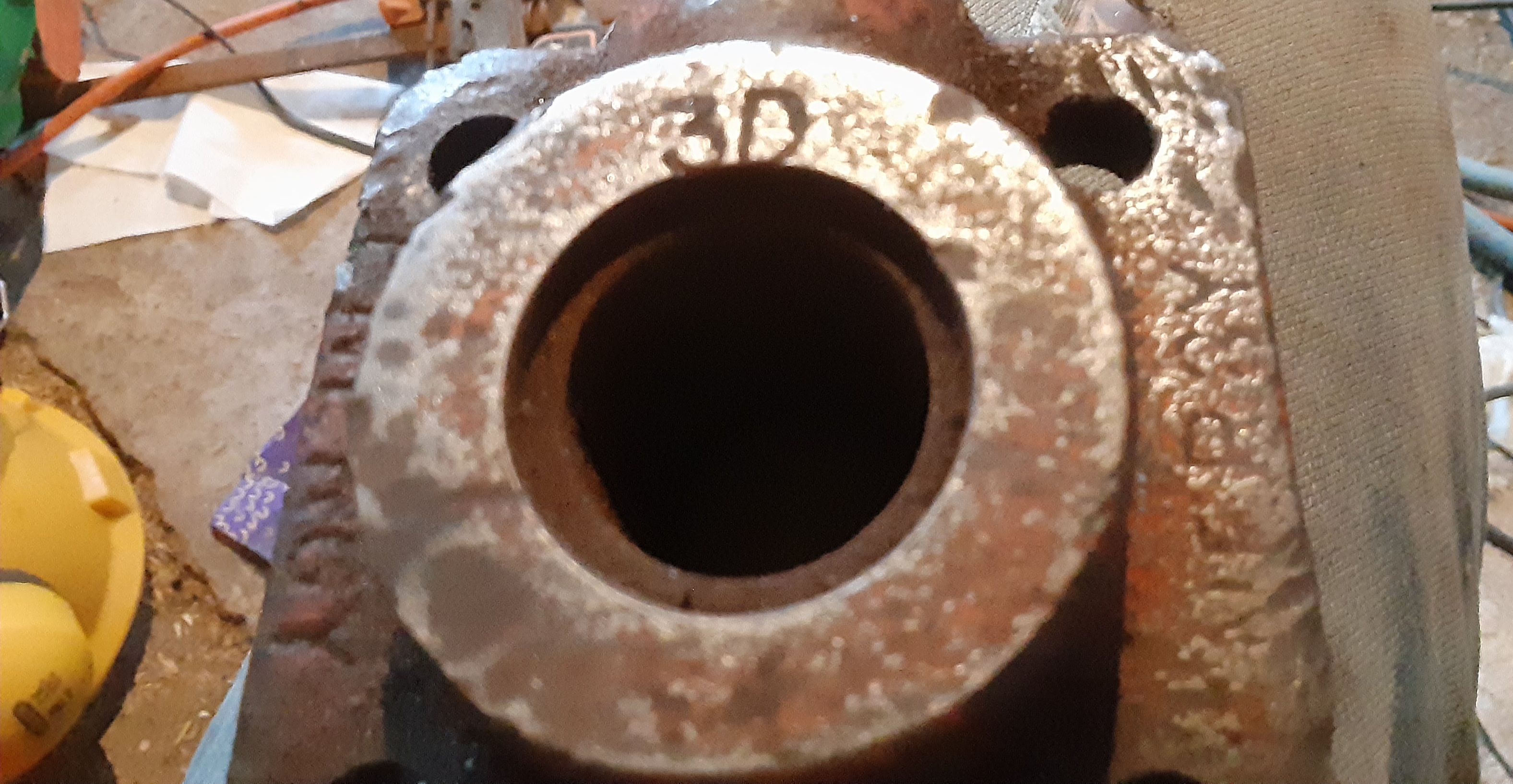

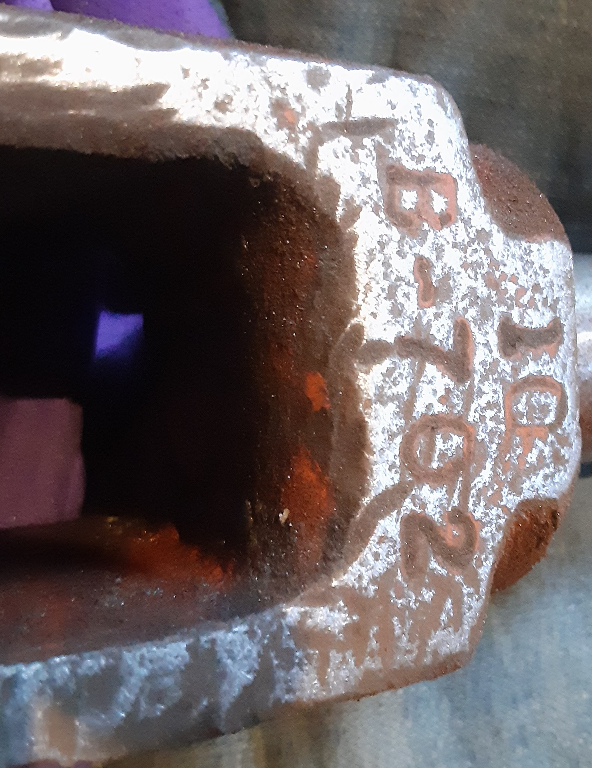

No clue what any of these numbers are
Points: 88415
Post Options Post Options   Thanks (0) Thanks(0)   Quote steve(ill) Quote  Post ReplyReply Direct Link To This Post Posted: 24 May 2022 at 9:16am
Those numbers are all CAST into the parts.. They are part numbers for that part. Not cylinder numbers... Probably not much use.. I think you are going to have to go with a GENERIC kit... You could go the the local Tractor Shop, or talk to a PACKING Distributor on line... They are going to want to know the diameter of the piston, how deep the groove is and how wide the groove is that the packing will fill... Also, is there a nut that holds a two piece piston together so you can slide in the packing, or do you have to STRETCH the packing over the piston... If they knew these numbers, they could make up a GENERIC packing set for you..... If you went to a local shop, take the piston so they can see it... You could go to a Bobcat, Case, Bearing House, etc... any body that sells packing.
