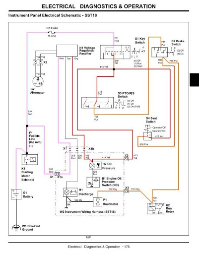

I've gotten lots of good information here in the past regarding my 180D. Thanks to everybody. Now I have a garden tractor/ lawn mower problem.  I didn't want to put "John Deere" in the title for fear the Orange police would justifiably send me to prison.  I'm going to risk it. The mower is an old SST 18. It's a work horse.  The problem is that this winter mice chewed through one wire too many and after mending all the wire breaks I can find the beast still won't start.  I've checked the obvious stuff.  What I'm looking for is a wiring diagram.  I can't believe that the only way to see a diagrm is to pay $40 for a technical service manual.  Any help is appreciated.

this may help you ??
I click on the sst16 image( 3rd one) an dright side shows it better. do NOT click to go to their website, simple right click, save image..... you can actually clcik on the > and < arrows and see( and COPY) the pages of the manual. I have one schematic saved , PM me and I'll send it.
Jay

Post Options Post Options   Thanks (0) Thanks(0)   Quote Hays Quote  Post ReplyReply Direct Link To This Post Posted: 10 Apr 2020 at 10:15pm
Thanks!  I had looked at these images but couldn't avoid being sent to the website.   I think I have what I need now.  Stay well - Bill

Post Options Post Options   Thanks (0) Thanks(0)   Quote Hays Quote  Post ReplyReply Direct Link To This Post Posted: 13 Apr 2020 at 5:14am
Thanks to all. The problem was a wire to the switch. Just in time to mow before the rain, cold and snow.
