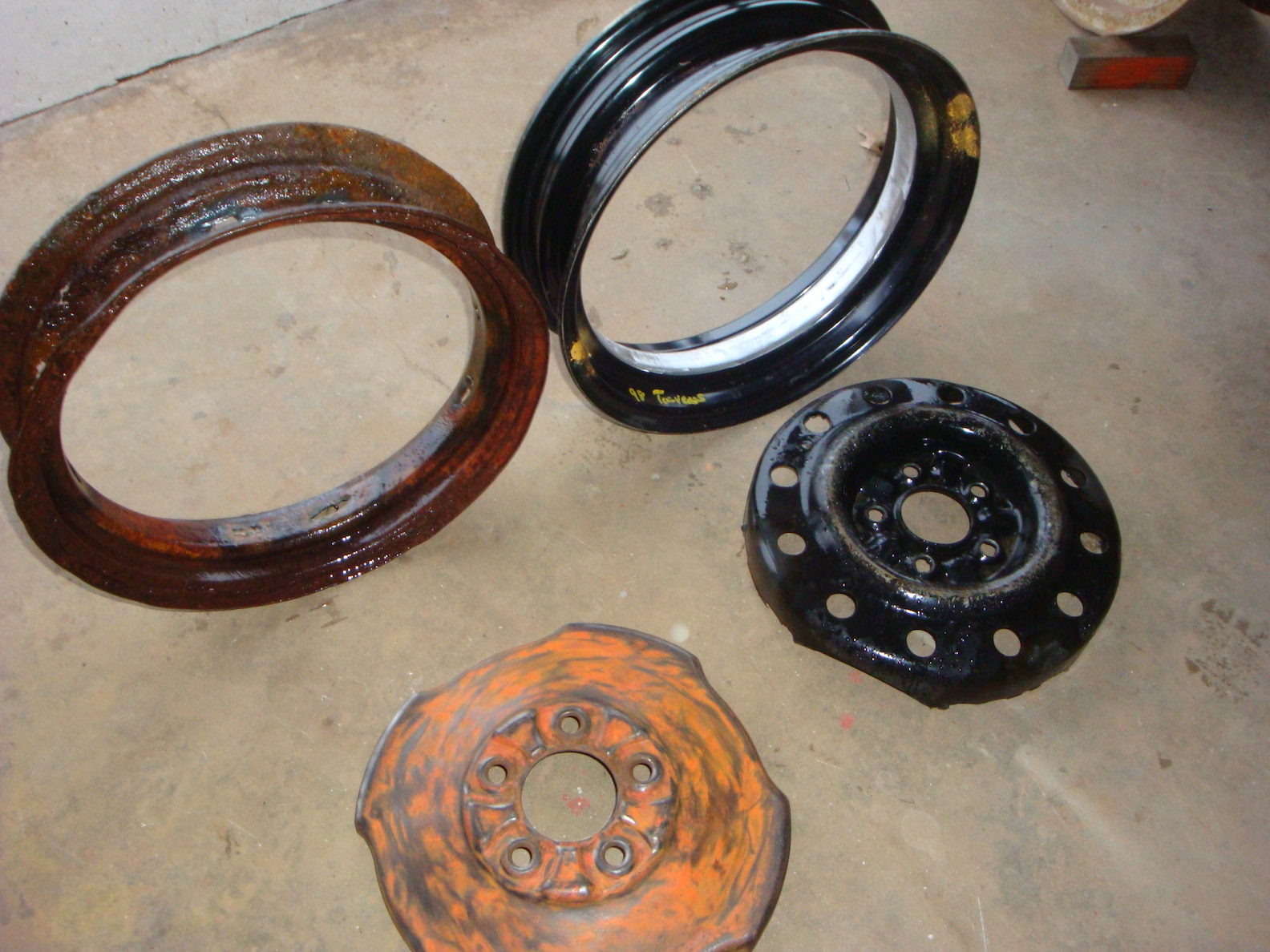

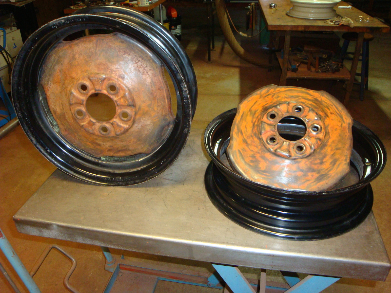

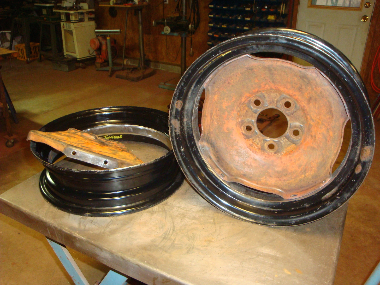

After my failed attempt to put larger hubs on my D12 to use a little bit bigger tire,I went new route. I read here about taking auto rims and bolting them right on tractor . Dont care for the looks so, I had a pair of old B rims that were the riveted style (3in.). Knocked out rivets and center came out smooth. Went to local junkyard where they had hundreds of steel rims piled up. Picked out a pair of 1999 Ford Taurus spare tire rims(15x4 1/4) Cut the welds off and recovered the outer rim .The old B centers fit those outer rims like gloves on a rooster. I am old and slow but had 2 1/2 hours in whole project. Now ready for new 5.50 x 15 tires.

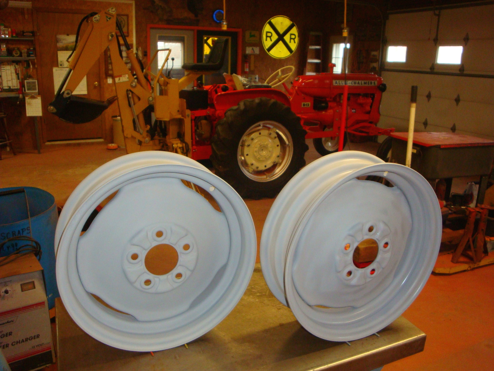

Post Options Post Options   Thanks (0) Thanks(0)   Quote Burl Quote  Post ReplyReply Direct Link To This Post Posted: 28 Jan 2020 at 8:02pm
Going to prime & paint them tomorrow , will take some pics.

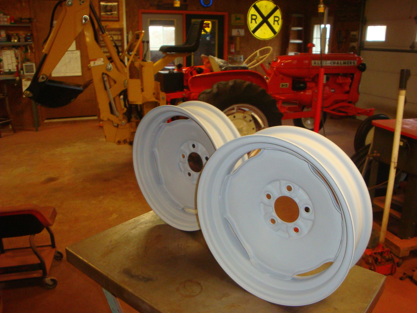

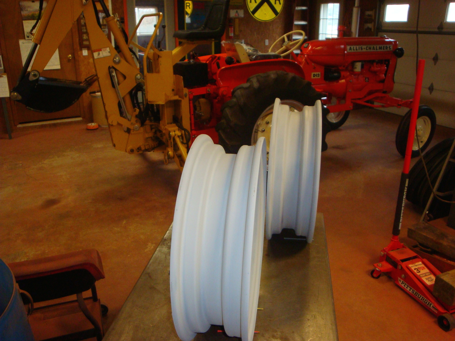

Post Options Post Options   Thanks (0) Thanks(0)   Quote Burl Quote  Post ReplyReply Direct Link To This Post Posted: 29 Jan 2020 at 4:17pm
Points: 8661
Post Options Post Options   Thanks (0) Thanks(0)   Quote Sugarmaker Quote  Post ReplyReply Direct Link To This Post Posted: 29 Jan 2020 at 4:27pm
Burl,
 Thanks for the pictures of your rims! Looks factory new to me! I like that option for rusted out rims. Very nice D12 also!

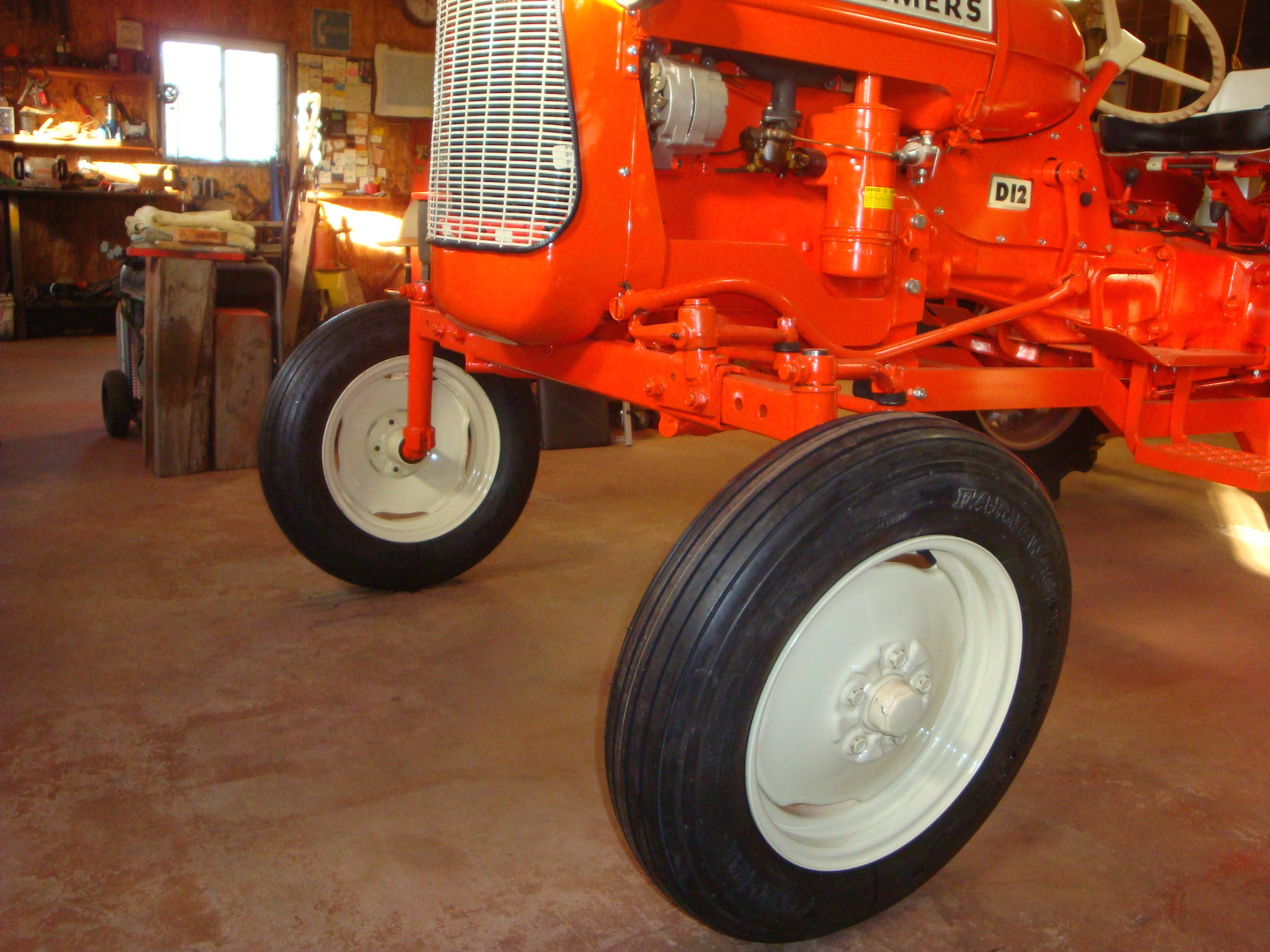

Post Options Post Options   Thanks (0) Thanks(0)   Quote Burl Quote  Post ReplyReply Direct Link To This Post Posted: 31 Jan 2020 at 8:08pm

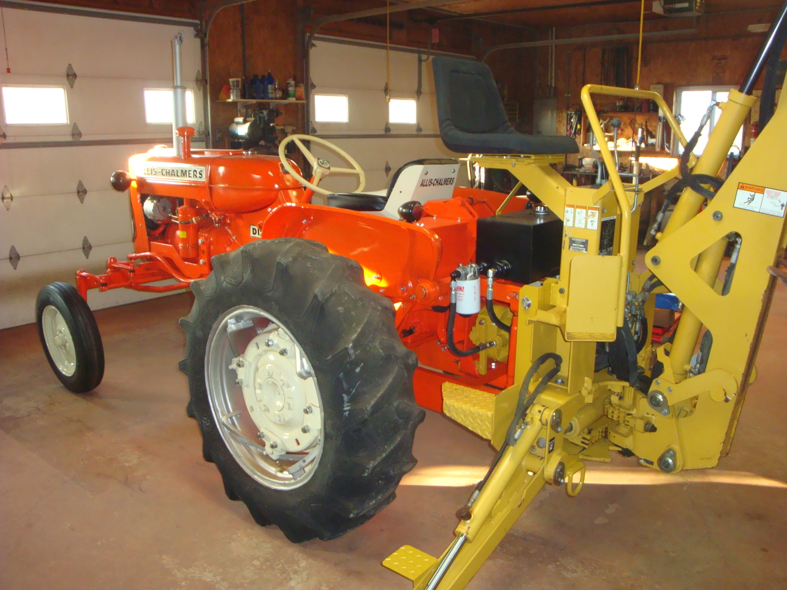

Points: 8661
Post Options Post Options   Thanks (0) Thanks(0)   Quote Sugarmaker Quote  Post ReplyReply Direct Link To This Post Posted: 01 Feb 2020 at 9:32am
Burl,
 Very nice D12 and backhoe combo! Looks too nice to go get dirty!
 The rims look awesome. Did you load the front tires too?

Post Options Post Options   Thanks (0) Thanks(0)   Quote Burl Quote  Post ReplyReply Direct Link To This Post Posted: 01 Feb 2020 at 11:46am
Thanks-Only weight gain amounts to 27# a wheel.I dont think its worth the cost of antifreeze and mess for that amount. Looking for or making some wheel weights for now is todays plan !
