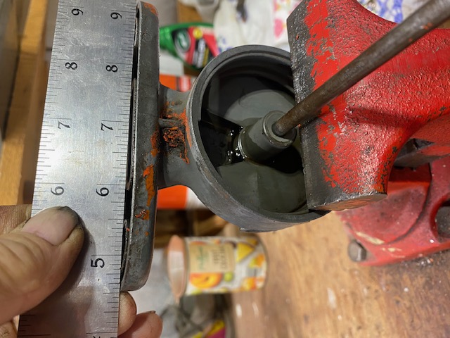

Arched like so? The oil returns to the sump where the biggest gap is and the cork gasket certainly doesn’t make up for it, or have they just warped over 72 years or is this the way they were all made? Hmmm…. on my other CA last week, I ground it pretty flat and put a new gasket. It doesn’t seem to leak just wondering.

A sharp flat file is your friend.

Post Options Post Options   Thanks (0) Thanks(0)   Quote PaulB Quote  Post ReplyReply Direct Link To This Post Posted: 28 Nov 2023 at 5:38pm
X2
Over the years the cork gasket deteriorated and when they began to leak, most thought just tight enough wasn't good enough. Everyone I've ever seen wasn't flat. No big deal just make it so.

Post Options Post Options   Thanks (0) Thanks(0)   Quote steve(ill) Quote  Post ReplyReply Direct Link To This Post Posted: 28 Nov 2023 at 5:56pm
YEP... gasket gets old and HARD and leaks.. TIGHTEN the bolts and bow the base... File it flat and get a GOOD gasket and your good to go.

Post Options Post Options   Thanks (0) Thanks(0)   Quote captaindana Quote  Post ReplyReply Direct Link To This Post Posted: 28 Nov 2023 at 8:42pm
Yay thanks to all I’ve been using that file!

Post Options Post Options   Thanks (0) Thanks(0)   Quote DSeries4 Quote  Post ReplyReply Direct Link To This Post Posted: 29 Nov 2023 at 2:49pm
When the gasket starts to leak, people tighten them down way too much.  That's what causes them to warp.

Post Options Post Options   Thanks (0) Thanks(0)   Quote captaindana Quote  Post ReplyReply Direct Link To This Post Posted: 29 Nov 2023 at 5:13pm
3 minute file = done!
