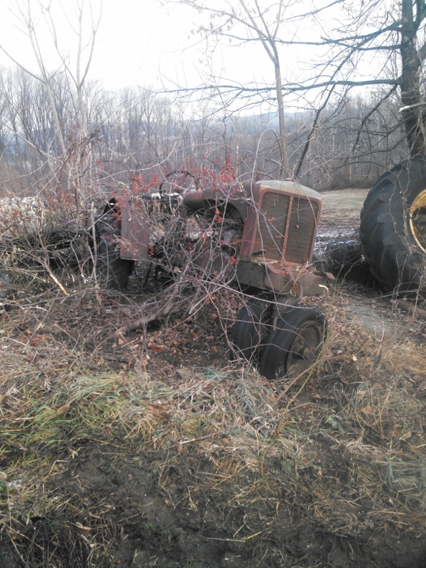

alan-nj View Drop Down
Location: oxford, nj
Points: 847
Post Options Post Options   Thanks (0) Thanks(0)   Quote alan-nj Quote  Post ReplyReply Direct Link To This Post Posted: 13 Oct 2015 at 8:08am
stan
i can't quite tell what color it is......
If ignorance is bliss, than happy days are here again.
Stan IL&TN View Drop Down
Location: Elvis Land
Points: 6730
Post Options Post Options   Thanks (0) Thanks(0)   Quote Stan IL&TN Quote  Post ReplyReply Direct Link To This Post Posted: 13 Oct 2015 at 11:20am
Orange then.  That adds 2 mph as the orange ones are always faster.Thumbs Up
