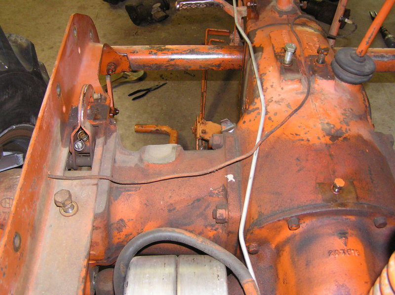

I am curious to know where the taillight wire was originally ran on a CA. We are about ready to put the platform back on, and I would like to get it where it needs to be so I don't need to take the platform back off.

The light Wire comes out the bottom of the instrument panel under the strip screwed to the top of the transmition. Then it cuts across to the left side trhought a hole in the support and up throught the fender support.
Post Options Post Options   Thanks (0) Thanks(0)   Quote CTuckerNWIL Quote  Post ReplyReply Direct Link To This Post Posted: 22 Mar 2012 at 8:18am
Dad's 51 CA#669 never had a transmission cover for the taillight wire that I know of. He bought it new in 1951

Your correct no wire cover on a CA. Just a C and B., here is a picture. You notice I have no wire to the left side.  only to the right since I had a combo work tail light I took the left tail light off. Its easy to route the wire with the platform on since its not attached anyplace.

Post Options Post Options   Thanks (0) Thanks(0)   Quote JarrodACFan Quote  Post ReplyReply Direct Link To This Post Posted: 22 Mar 2012 at 6:18pm
Okay, I see the groove where it needs to be ran, thanks. If it would have been a snake, it would have bit me!
