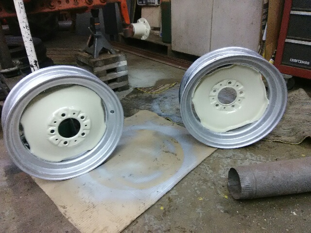

I guess I have done it both ways. But the last ones I did I used some different aluminum and sprayed it first. I had over spray on the centers. Well the cream did not like the silver. Took a month to dry. So try to get paint that is compatable is my point. Same brand primer and top coats. I have used rustoleum spray cans for most of mine.
I Think your tractor is going to look awesome with those! I tend to go with more of a cream than a stark white. Just happens to be what I like.
some pics:
These are from my rear of the WZ pulling tractor.
