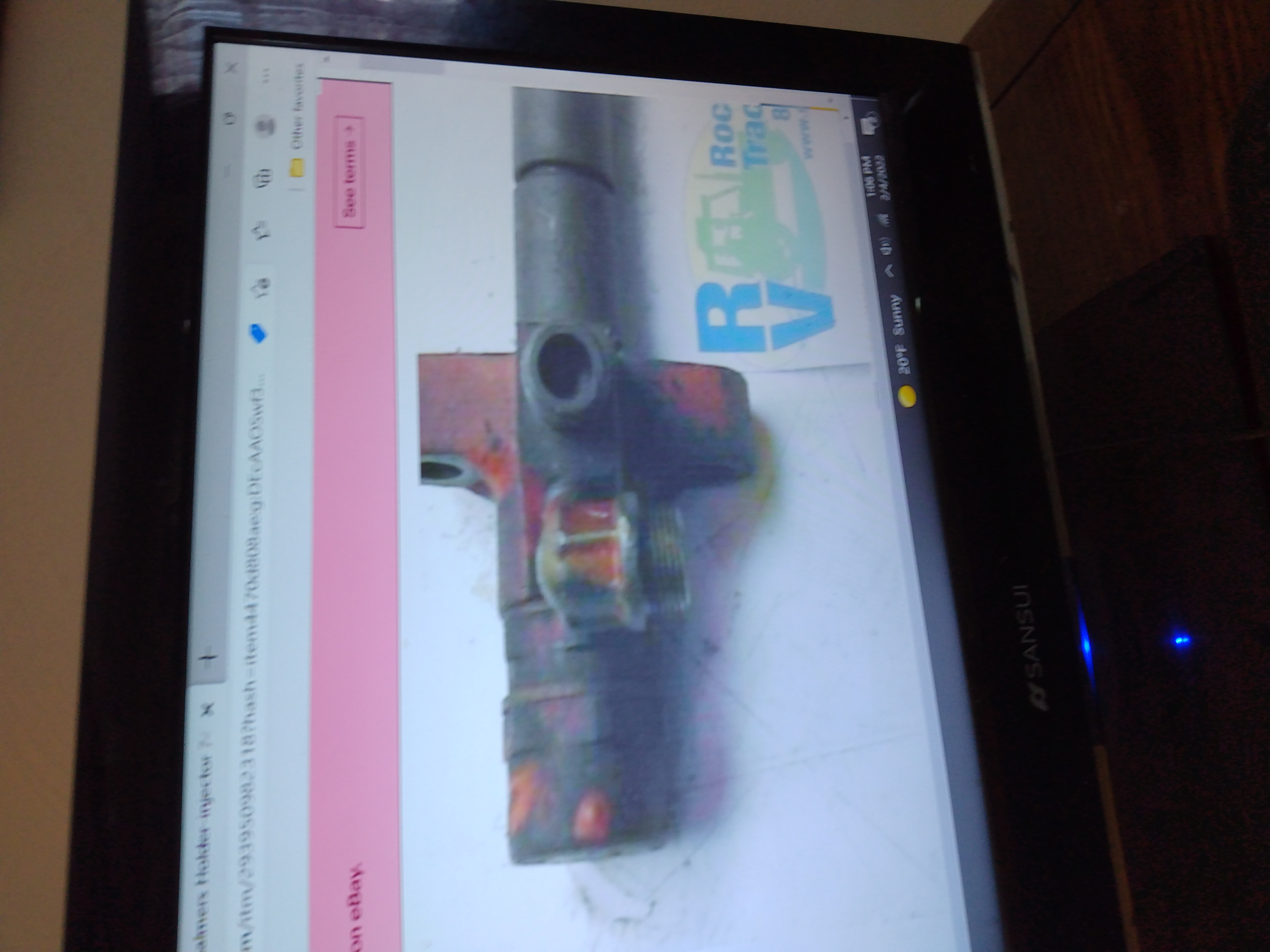

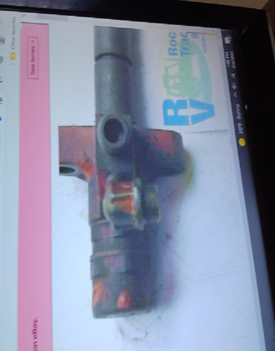

Seen this on eBay, part # 74060858 for $117.65, what's so special about it? Never seen one like this before

And again it has to be resized, gggrrrrrr

nothing really special, looks like a bosch or cav injector for a 230 like a WD45D.

D19

Looking at the nozzle body it most likely came from a D 175 or a D 262 series engine. The entire injector assembly was manufactured at the Harvey Engine plant.

This one is a robert bosch or cav . The AC injectors like in a D17/19 are more rounded off under the ears where they bolt in. The flats on the sides are also a giveaway. These are pre D17, which is why I said WD45D. Wil they interchange? Sure they will. I have a few of both styles in my core bank.
