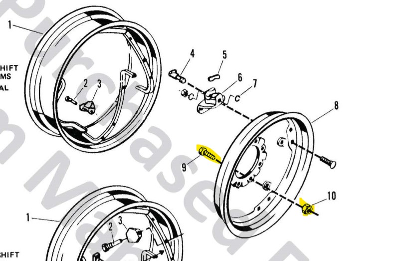

Take the rim off of center. Leave the center on the hub or take the center off afterwards.

Will someone PLEASE post a pic of the "issue" at hand ??!! Thanks Wink

once upon a time..we drilled out the holes to accept E combine studs and then the nuts..Mark

All but one of my 175-185's have the nuts on the back...it pissed me off the first time as I had a flat and it was hard to spin out the wheel to get to the nuts. Now I just take the time to spin out the wheels first, use 2 vise grips and take two lug bolts off at a time. It goes pretty fast. I play musical tires alot, so I have it down to a science. 38" centers are easy, not necessary to spin them out. I use a long screwdriver to hold the bolts in place while I put the nuts back on.  I had a set of threaded spacers that I put on one tractor so I didn't have to mess with the nuts....

X2! I’m not familiar with this series tractor so a visual would be nice

Well I did get them off with much struggle.  I just needed to bitch about it!
