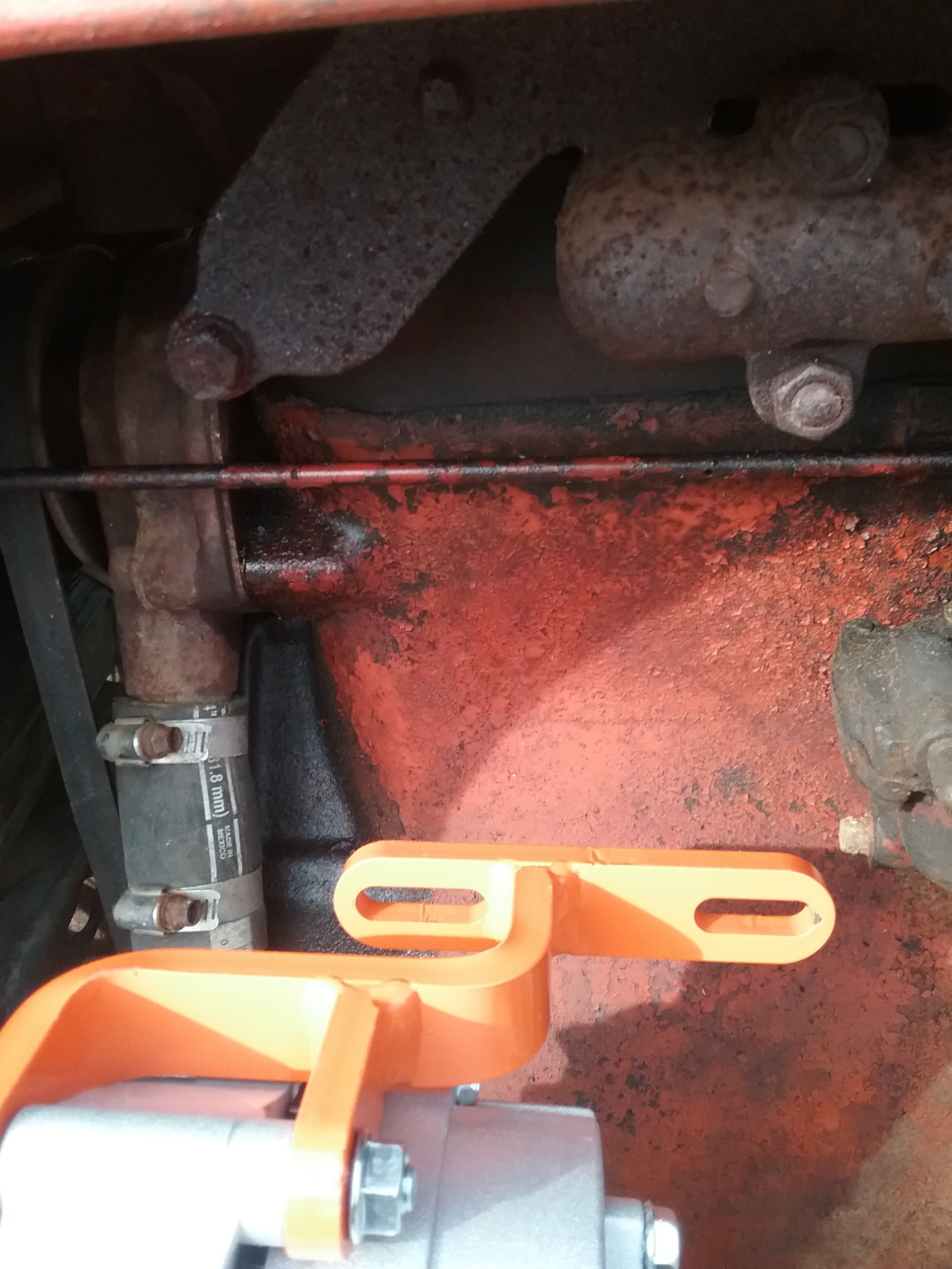

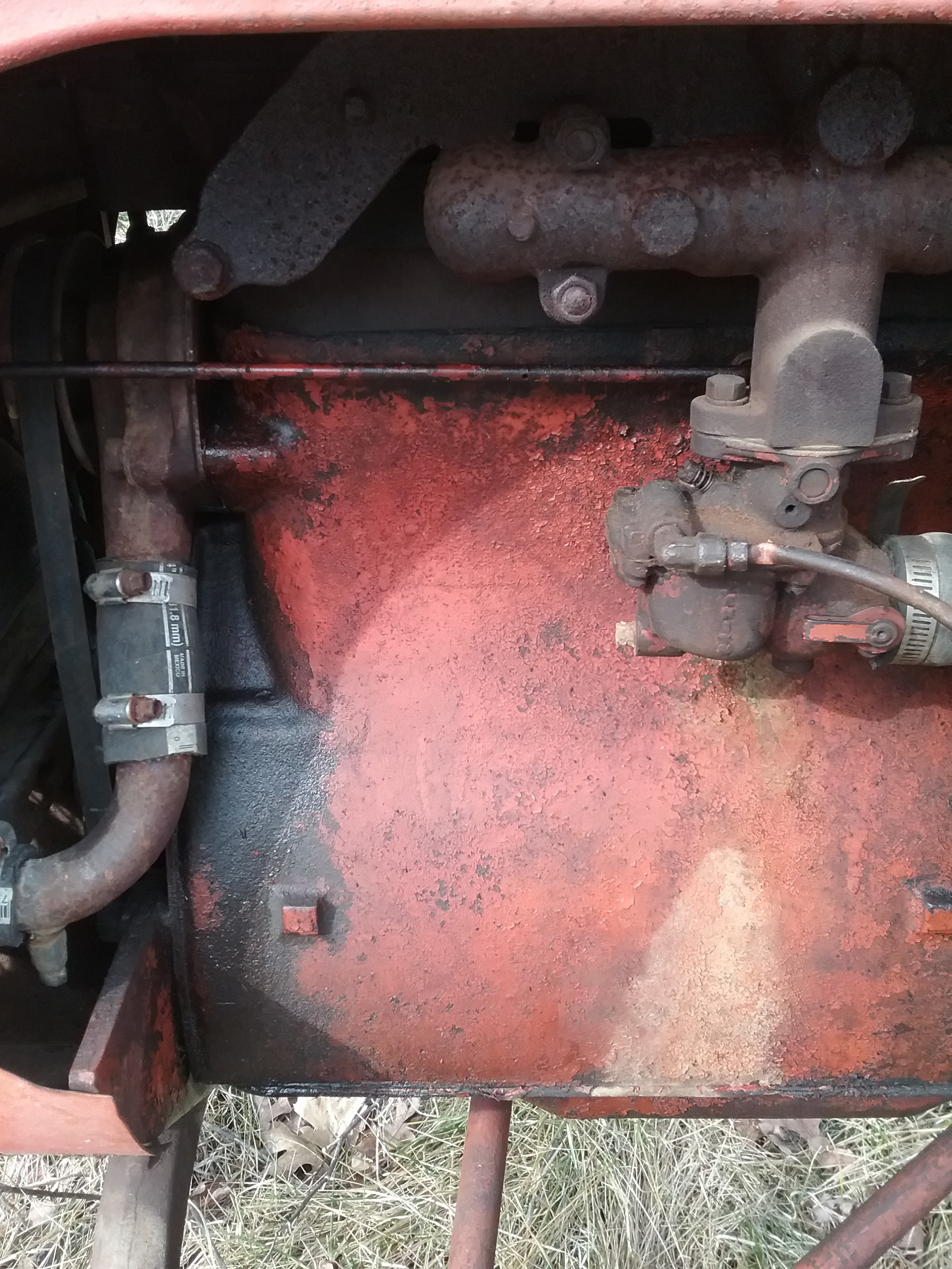

I bought this tractor couple weeks ago from a person who told me that it was in 1942 Alice charmer CA. This story goes that the generator was taken off of it by some local hoodlums and the man didn't have time to fix it. So right after I bought it I went out and I got all of the parts to make it a 12 V system and use an alternator. Whenever I got the alternator mounting bracket I realized that there is nowhere to mount the bracket and that in fact I was dealing with a completely different engine. I've ran the numbers and I think that the motor comes off of an older Allis Chalmers B. I'll include pictures so that you all can have a look at it. If anyone has any ideas of what this engine is and the proper way to put an alternator on it I would be extremely grateful. Thank you

Looks like they took the damn mounting holes too! Them SOB's are GOOD!
I think very early B's didn't have a provision for mounting a generator cause there was no battery, but someone more knowledgeable will be along shortly. Maybe a picture of the rest of the tractor would help too. |

that is a B. the front axle looks that way anyhow. there isn't a way to put a gen or alt on that without changing engine block. does it have pto? build a bracket and run the alt off it.

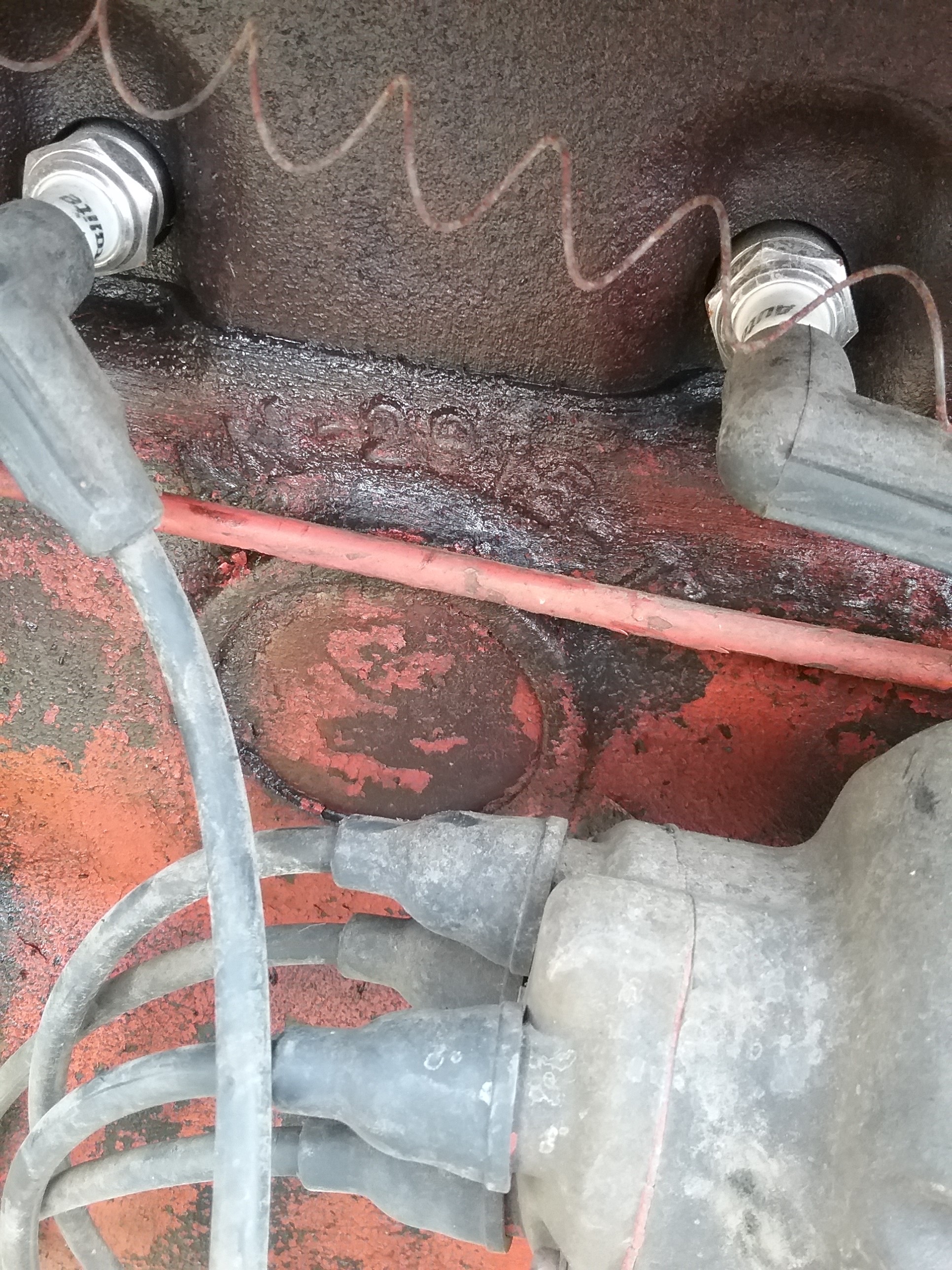

Information I gleaned form somewhere off the internet. Bold Italic and Underlined is my surmise based on AM2916 on your block by the distributor. If you are sure there is no number stamped (and covered by paint), then the transmission failed in years past and was changed out with a new unit which had no number. If this is the case you can look at the engine behind the distributor for a casting number. It should be a cast number in the form of AM2916 - xx . The two digits at the end will tell you the approx year manufactured. 1938 is 10, 1939 is 11, etc, 1958 would be 30.
125 cubic inch "CE" engine Approximate engine sn: back of block and tractor sn: correlation
Also, most heads have a actual casting date in raised numbers in the bottom of the oil galley. HTH Elliott

A few photos of the whole tractor might help better identify it. Those photos look like a B not a CA. The rod from the steering box to front end would show in the photo if it was a CA or C.

Back to your immediate problem, You can make lemonade out of lemons, by dropping the oil pan, and measure up, to the bottom of the water jacket. Take that measurement, and measure up, from the pan gasket, and draw a line, on the outside. You do NOT want to drill into the area, ABOVE the line, or you risk perforating the water jacket... Then just hold your bracket and alt, up to the side of the motor, till it approximately lines up, to the belt, mark the hole locations, drill and tap (I'd use a fine thread, 5/16 or maybe 3/8 screws to attach the bracket...

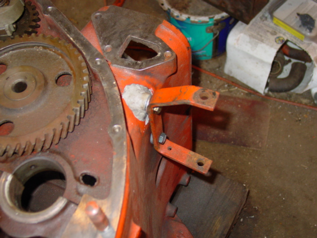

Here is one of several I have done to mount a generator on the early B blocks.
Having several block to measure helps. No problem drilling and taping into the water jacket, you just have to seal the threads. This is the exact location for the bracket. ![]() ![]() Edited by Dick L - 03 Apr 2019 at 7:13pm |

Dick, You have way to much time on your hands man! A color coordinated valve train. You're to much! LMAO! Steve@B&B

All the heads I put small block Chevy valves in I painted the valve train that way. |
