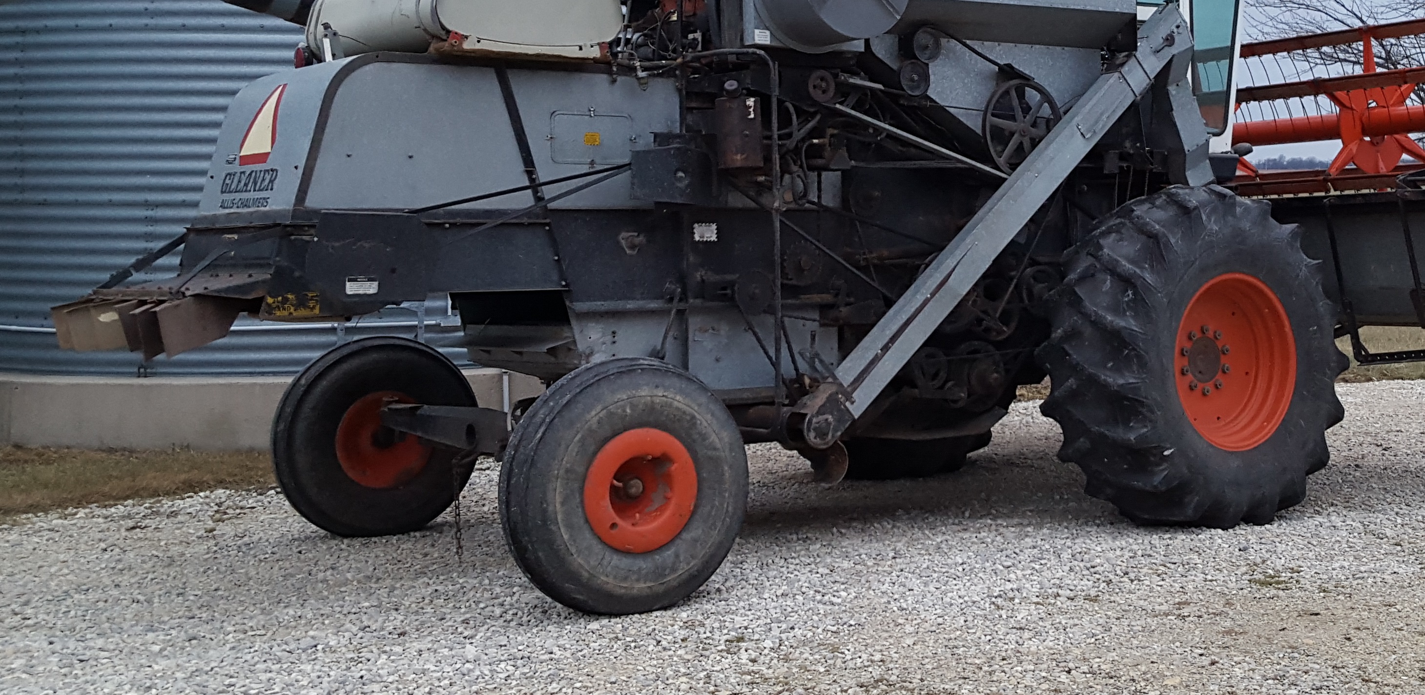

Dad's old F3 came with factory weights on the back axle if you look closely at the picture below.  When the combine was sold we kept the weights and put them on the 6080.
If you are wondering about the sign, it is at Summerix in Lachine MI.
Points: 22804
Post Options Post Options   Thanks (0) Thanks(0)   Quote DrAllis Quote  Post ReplyReply Direct Link To This Post Posted: 21 Dec 2018 at 10:35am
Those are "fat back" wheels on that combine. They also had donut weights that bolted right to the original/standard equip steel wheel, but they weren't near as heavy as fat back wheels.
