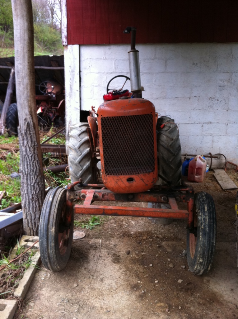

Hey everybody,
Brand new to tractors so I don't have a whole lot of knowledge.  Recently inherited a '48 B that was my grandfathers.  With a lot of help from my father in law we got it running again.  I have 2 way plows, cultivators, and a belly mower.  I would like to get some weights for it as well for the front and back.
I noticed mine has a bar in the front that I haven't seen on other B's...Is this something for putting weight on?
Any help would be appreciated, I'll see if I can get pictures up.

I'm guessing your bar is for pushing stuff around but it could be used for some weight maybe, not sure how secure it is on the front axle. For B's there are side weights that go on the motor and rear wheel weights and also front axle weights for wishbone front ends, not sure about ajustable.

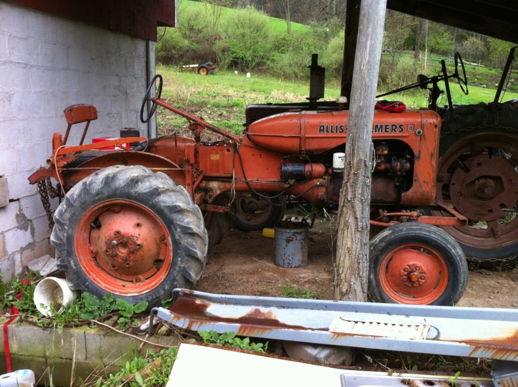

Now, I say AHA... because I have a '48 B ALSO... and although mine does NOT have the adjustable frontend, it has wheel centers like yours.  I was told that mine SHOULD have had flat-type (non-dished) centers like what appears on my '39 B... and should've had some other type of wheel, but I see that yours (having 5-lug center sections) that my '48 is most likely correct, at least everything except the rim is.
My guess, is that someone either made a 'special' implement to mount on that, or they used it for either a weight bracket or bumper, or both.  It's cleverly done, with exception that it's position precludes easy use of the hand-crank if you should need to start it by hand.

with a wide front like that I think it would be easy enough to fabricate a bracket for the smaller suitcase style weights.

I have a 47 B with the same axle configuration as yours. The rear weights are the same as for the C, and get mounted on the inside of the wheel. For the front you would need the "side weights" They mount between the toruge tube (5/8" bolts) and the front mount on the front of the engine (also a 5/8" bolt). I guess that you don't have fluid in the tires. If you did, that would be enough weight to plow with.

Thanks for all the info.  I do not have fluid in the tires, I'd rather not mess with that.  I've seen the side weights, but I know they are kinda rare.  I noticed that the front bar had the same paint as the rest of the tractor, just curious if it was an option for the B's.

your bolted rear wheels were optional equuipment that came  with the adjustable front end.. standard was spline rear and widhbone front axle.... the weight bar is home made.
