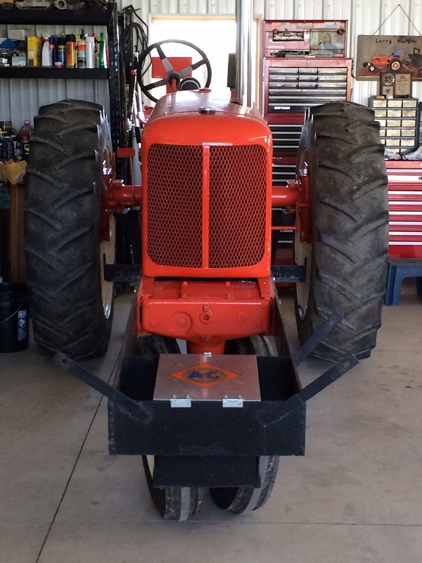

Mine on the front is 11'. The weights hang on the sides of the bracket, so if I add any, it goes a little further back. Never any issues. I would like to lower the front bracket, so weights are closer to the ground. Seems like the leverage would be a little differnt being lower, and its easier to hang them on. I use all IH weights, 75 & 100 unless I go to the 55&6500, then I throw some Oliver weights underneath the belly, but fine tune with the oliver weights

Post Options Post Options   Thanks (0) Thanks(0)   Quote Larry(OH) Quote  Post ReplyReply Direct Link To This Post Posted: 03 May 2016 at 1:59pm
My Bracket/ bad picture
