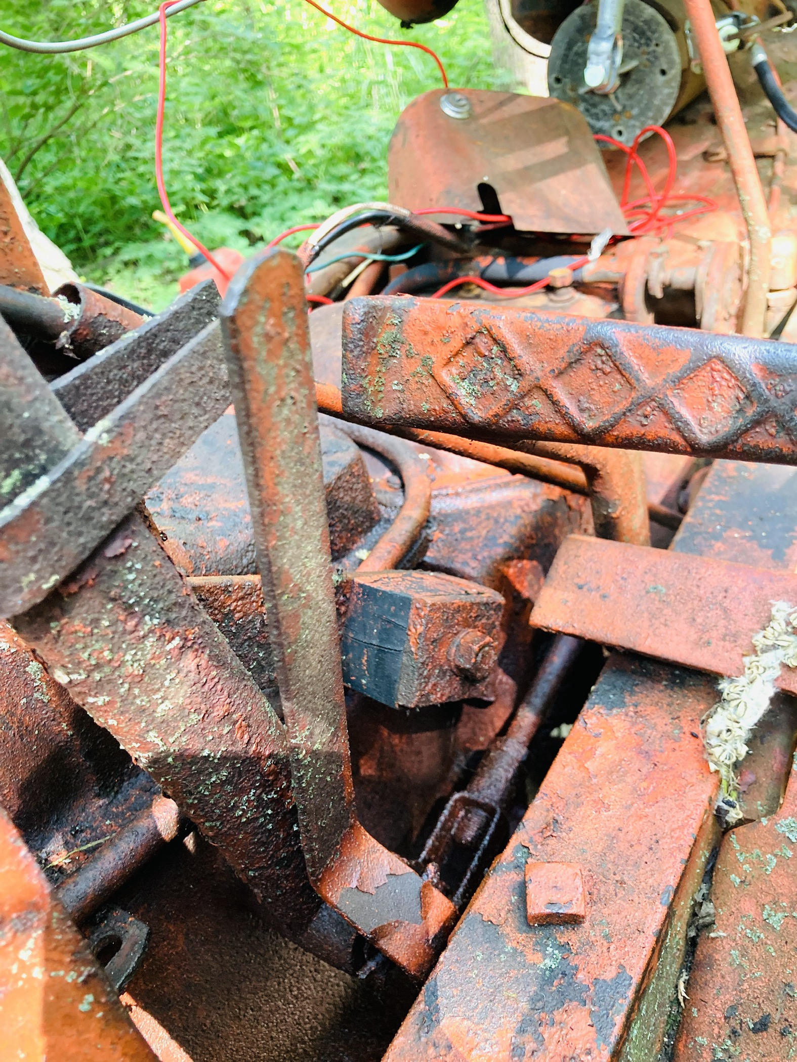

    Can anyone tell me what the flat lever controlsuploads/25593/IMG_9857.jpg

Does your tractor have a belt pulley that this lever goes to? It might engage and disengage the pulley. If so, that a cool rare option.

No it does not doesn't look like it ever has tractor is in woods can't get a great look at it
with all the brake pedals and stuff right beside it seems to go down to some linkage rear
wheels are locked up thought maybe this had something to do with it can't get it to move at all

Looks like its where the brake lock mechanism should be located.Maybe used that lever to lock the brakes?

Could be but doesn’t look like a normal mechanical brake lock looks more to be internal I was hoping it had something to do with the rear wheels being locked up

Is that  the mechanism that disconnects the hand clutch when you hit something with the plow or other snap coupler implement?

At least on mine, the flat lever has nothing to do with the hand clutch kick-out.  Could possibly be a brake lock in place of the rod.  Surely there is another one out there with that oddity?

Might find it is used to unlock the snap coupler... sort of like used on WD45 Diesels.
Never seen a rubber stop block for the hand clutch either, maybe never took notice of them before.
Maybe in the 75 +/- years it has been around, the owner modified the tractor.
  Like Dennis J's comment that it could be a more positive modified brake lock.

My WD45 has the rubber stop block on it just like that
Points: 22166
Post Options Post Options   Thanks (0) Thanks(0)   Quote DrAllis Quote  Post ReplyReply Direct Link To This Post Posted: 04 Jun 2025 at 6:17am
The rubber stop block for the hand clutch lever was when it was equipped with the "rock throw-out" accessory for plowing, which this tractor has. The violent release of the hand clutch lever would eventually break the brass collar or something else, so there was a rubber stop designed to solve that problem.

I haven't been able to find the serial number bought property next to mine and inherited the tractor it has sit for 5 to 6 years but I knew it ran at one time. I put another post up about rear wheels locked and seems to be brakes locked up I thought maybe this lever had something to do with it but didn't see this lever in any illustrations anywhere. Tractor is in woods hard to see where it is connected with all the brake pedals and pto lever and hand clutch .I really appreciate all the input

Hand lever  ?????  Looks like it could be a guard to keep Heat Houser away from the hand clutch lever.  If it was a lever, it sure was not used much

One of my 45’s has that lever and it sets the brakes.

Didn't somebody make an aftermarket parking brake? Could that be it?

Looks like the foot clutch lock out I had on my 45 but I know it’s the wrong side.
The rubber block is for the rock kickout as
Dr Allis said.
I know that because I have a nos kit for a 45.

Keep following the linkage and see where it goes. If you can't figure it out there, take a picture of whatever is at that point and post it.

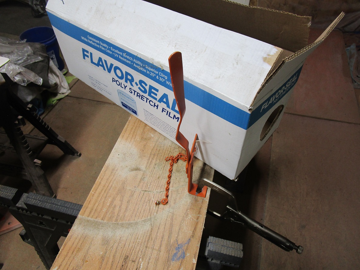

Here ia picture of the lever that was on my WD when I bought it. But that was a few years ago, so I don't recall where it was on the tractor.  When I was finishing restoring it two years ago. The only place I could find where it came from, was the clutch pedal lock out lever. It did go under a bolt on trans cover. The lock out lever has a hole in it, and the end of the chain has an eye bolt. I didn't reinstall it.
