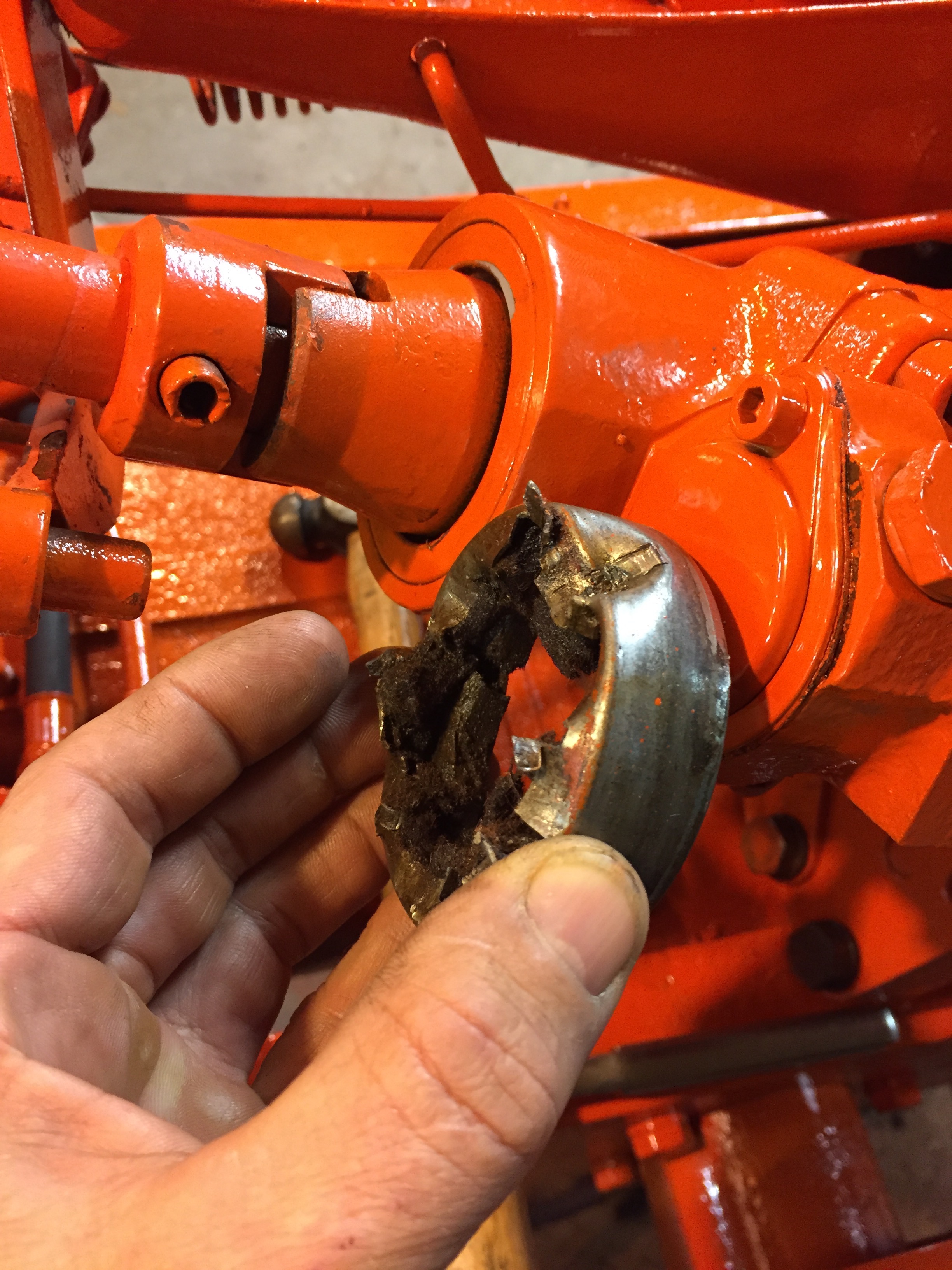

I have my grandfathers 1956 WD45 wide front and factory power steering.  I need the seal at the top of the power steering gear box where the shaft enters the valve area.  It was leaking/weeping and was destroyed trying to get it out.
I tried NAPA and another local store and installed one that looks like a driveshaft seal but is narrow and I believe it will leak again all over the new paint.
I am looking for a replacement for it, where, part numbers advise etc.

AGCO still has them, AGCO part number 70227346 you will need to order 2 seals to replace the old one piece seal you removed or you can call me 8 to 5 and I can give you the seal's part number, I'm rebuilding a power steering one right now.

I have installed two seals on three of my power steering units and have not had a leak.

Thank you for the information.  I tried to look up the part number 70227346 on the AGCO website.  I am probably doing it wrong because it came up with nothing.

I just went back to AGCO to check and 70227346 is the right number for the seals, you will need to install two of them like Lon said.
