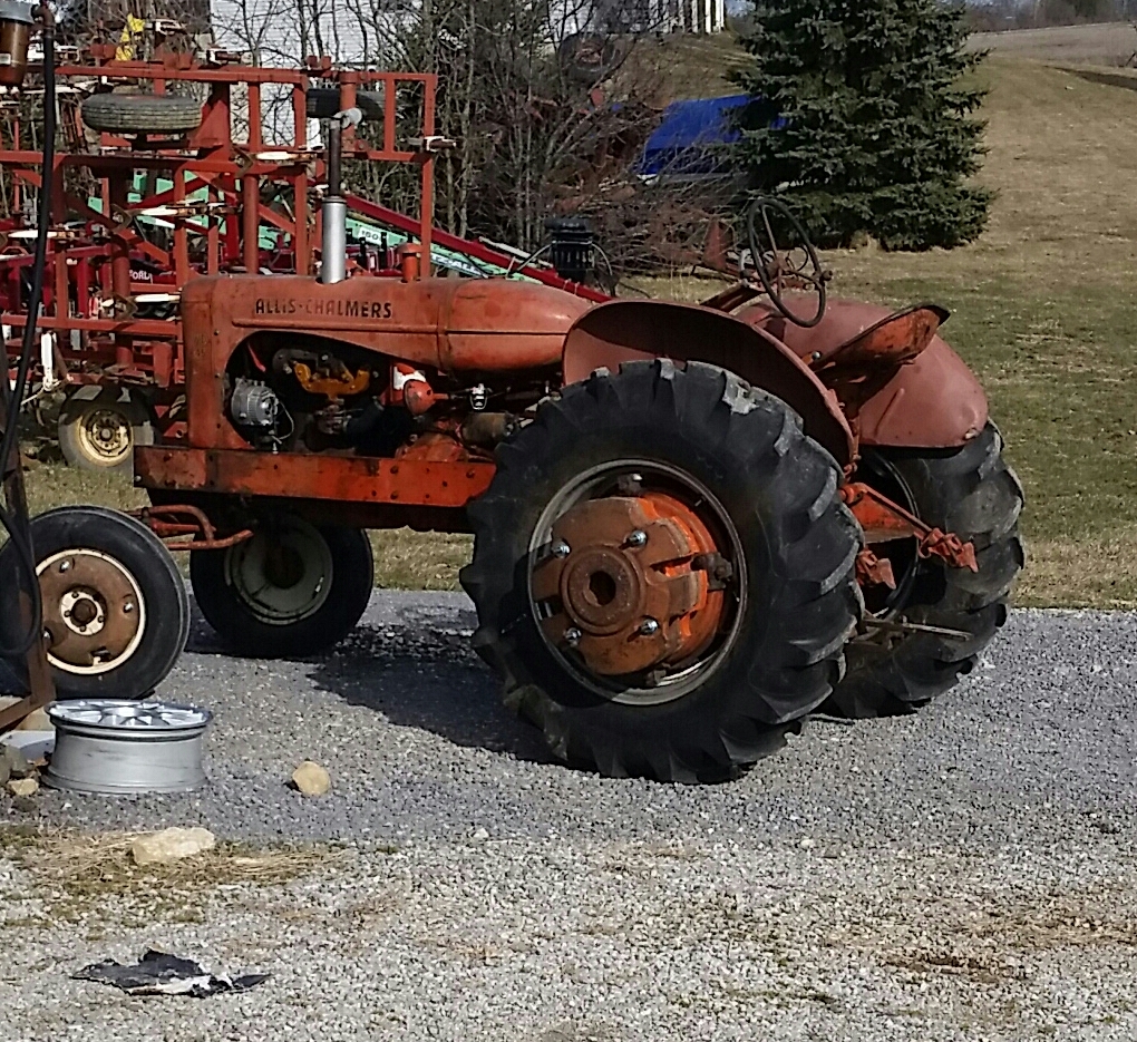

I like them as close to original as possible. This one has newer fenders on it.
