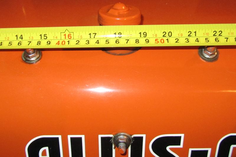

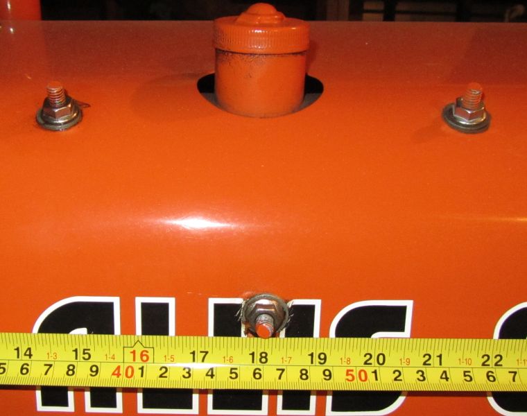

I am looking to mount a power steering unit on a wd45d.I have to drill the holes in the hood for the tank.Does anybody have a measurement how far to go from the fuel tank?I was looking at some pictures of Toms tractor but cant figure out where to put the holes.Any help would be appreciated,Tony

I just went out and took these; the first two are measured from the back of the hood.
This one is measured from the front of the hood.
